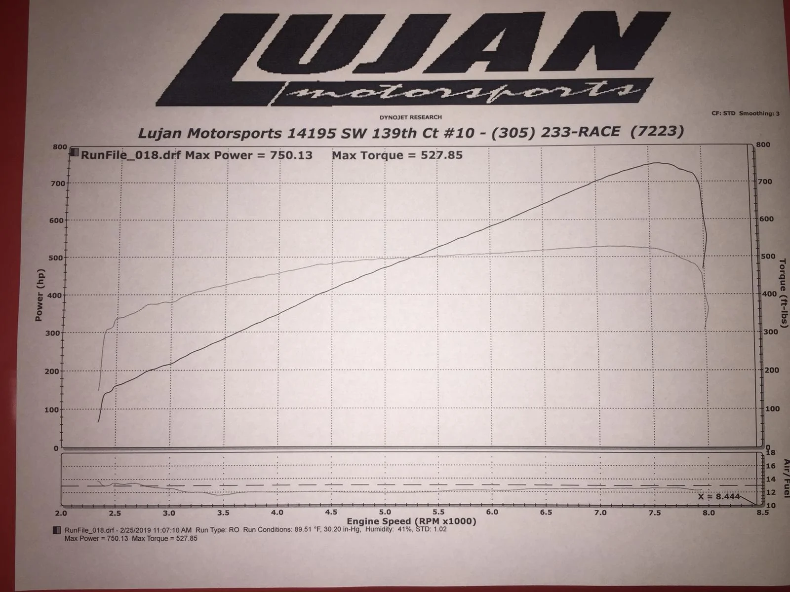

Got my Fore system on about 2 months ago, took a couple street pulls to get it dialed in. System is dual 465s, FC3 controller, wire upgrade, -8 supply and return PTFE lines. Took it to the dyno to make sure all is well and was pleased with results. Mods at time of dyno (just shy of 90* that morning) consisted of...
Stage 2 P1sc
4.25 pulley
Shelby manifold
Mak inlet
Catless LTs
3" exhaust
pump E85
6R80
Lund tune
Pull at :45 seconds

Nice work man! That thing should be very fun

Good numbers. Now its time to rip off a 9 second slip.:like:Good luck.

Nice man and nothing better then being safe on e85.

Nice pull!! Any idea what boost numbers you hit?

thanks. fluctuates a little on log but its a little below 12 at 7600-7700
