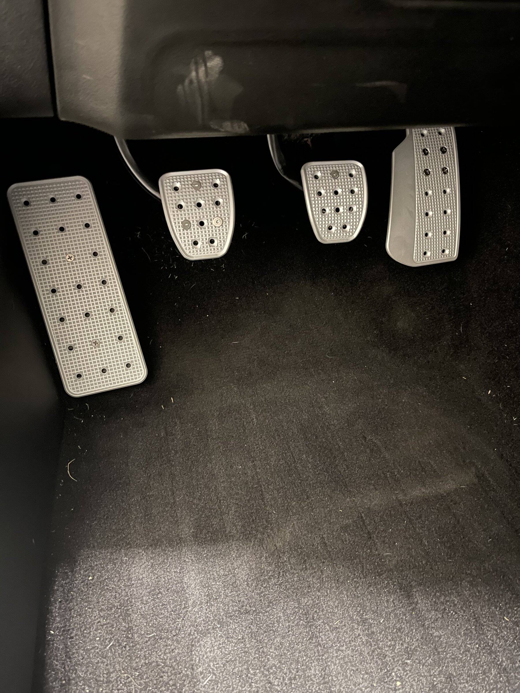

Looks great! Is that the extra wide gas pedal as well?
Yes it is the extra wide pedal. I wear a 12 shoe and blip by rolling over. There is plenty of room for the extra wide pedal. When I sold my car the new owner also liked the setup and he had a much smaller foot. The gas pedal, as you know is smooth, as it should be. I used a right angle drill on the clutch/brake pedal and 5-6 bits as this steel is like drilling into granite.

got mine ordered! How did you all attach the dead pedal? Did you drill through the plastic piece already there, or completely remove it and re-drill some holes?

I just mounted the dead pedal piece right over the existing plastic piece. It’s a dead pedal after all and unless you have some crazy carnival footwork going on down there you should be fine. Tearing that whole area apart seems like overkill to me.

They look great. It looks like you only got one fastener installed on the brake pedal? Maybe it’s just the lighting of your photo.
Definitely only one installed. Hard to get many in that pedal due to the shape and location of the lever behind the pedal.

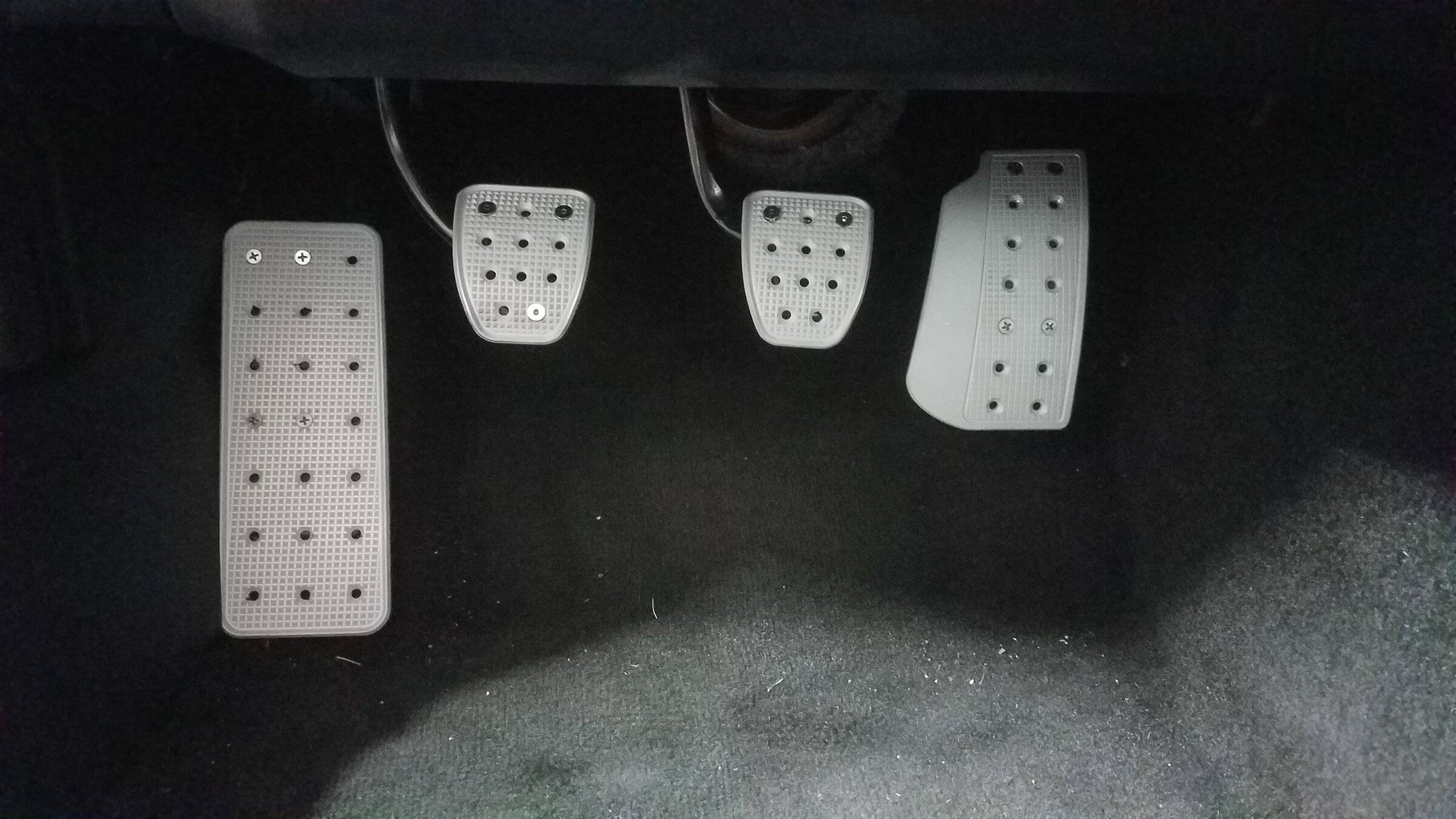

If you look at mine I can only get two at the top.
If you look at mine (post above ) I was able to get all 3 in there.
Yea im sure it's possible I'm sure. I have 3 on the clutch, but after making the first two holes I didn't have a good way to mount a third on the bottom on my brake pedal.

yeah definitely only one. I made sure to tighten it down really well so that there was no movement, but I had a hard time spacing the holes out like @mavisky. I was also getting a little closer to the edge of the pedal than I was comfortable with. I'll look at reinforcing it probably this weekend.
