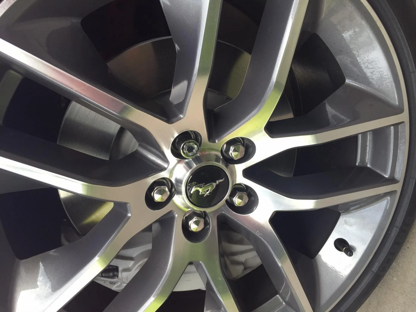

just got my changed does this look about right? is it me or they look smaller idk
anyways i got a damn nail stuck on my tire in the drive home after the dealer ahhh fml

Not a mechanic but if they were smaller wouldn't they not align properly with the caliper?

Thanks for the pics. I do agree, they definitely look smaller. The center hub also looks white in your pics.
