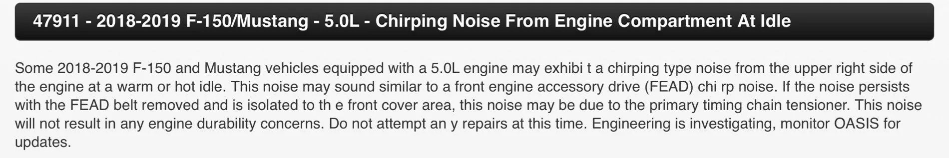

This is the only doc from Ford that possibly could be what you are hearing:
I’d take it in and let the Service Center check it over.

Thanks very much for the info Cobra Jet!! This puts me at ease. Chirping is exactly the word I was looking for (like a rhythm bird chirping)
Do you work for Ford? Where did you find this at? What is the FEAD belt? Front end accessories?
Thanks for your help.
ps. a little worried since it has to do with timing chain :)

I have the exact same sound, and I can confirm it's not the belt. I spent a good amount of time messing with the pulleys to find no change and finally decided to start poking around with a stethoscope. It's coming from inside the driver's side head. Matches up with the TSB posted. The car drives fine, otherwise, and the sound is completely gone when warm. I don't know if I feel like taking it in myself, at the moment, especially if I'll just be told it won't cause any harm. I would have bet a limb it was belt related because I didn't hear it on the old engine, and I saw a nice streak of oil leading down the cover, but alas.
OP if you take it in do post how it goes.

If it’s a belt “chirp” here’s how you would determine if it’s truly a belt chirp:
Using Simple Green or Glass Cleaner (Windex, etc), while the vehicle is running at idle, spray mist the front FEAD - IF the noise (chirping) instantly subsides, it’s a belt issue.
If the chirp does not instantly go away, it’s the issue outlined in the above SSM, or a bad belt tensioner bearing.
When was this notice released, and is there any way to know if there is an update to it? Sounds an awful lot like that TSB posted for the 2011 that called for a new chain tensioner.
Cobra Jet
Feb 12, 2015
771
17,614
20,076
2019 and within the last 6 weeks.

interesting. Just had my timing chain tensioners replaced under warranty because thats where they thought the ticking was coming from. Now I still have the tick and this new chirp sound. Awesome ASE techs at Ford.

If the thread above holds any merit, it's just a case of something being rushed during installation. I use "just" lightly. This can come back to a lot of what was discussed months back when the tick and rattle threads were in full swing. Simply put, these engines are becoming too complex and require far more care during assembly than a production line can offer.
It's hard to say if this would cause issues. It will, inevitably, cause the components to wear faster than one not chirping, but to what degree is hard to say. That it only chirps when cold is definitely a better sign than if it were the other way around. If it persists beyond warm up, when it previously wouldn't, I'd take that as a cause for concern. Beyond that, given the ford statement provided, you probably won't get a repair. Just keep the RPMs low until the heat expansion helps the issue and/or the oil thins out and is capable of lubricating things properly. That alone, beyond not bouncing it off of the limiter and regular maintenance, is all we can do beyond taking the engine apart.
