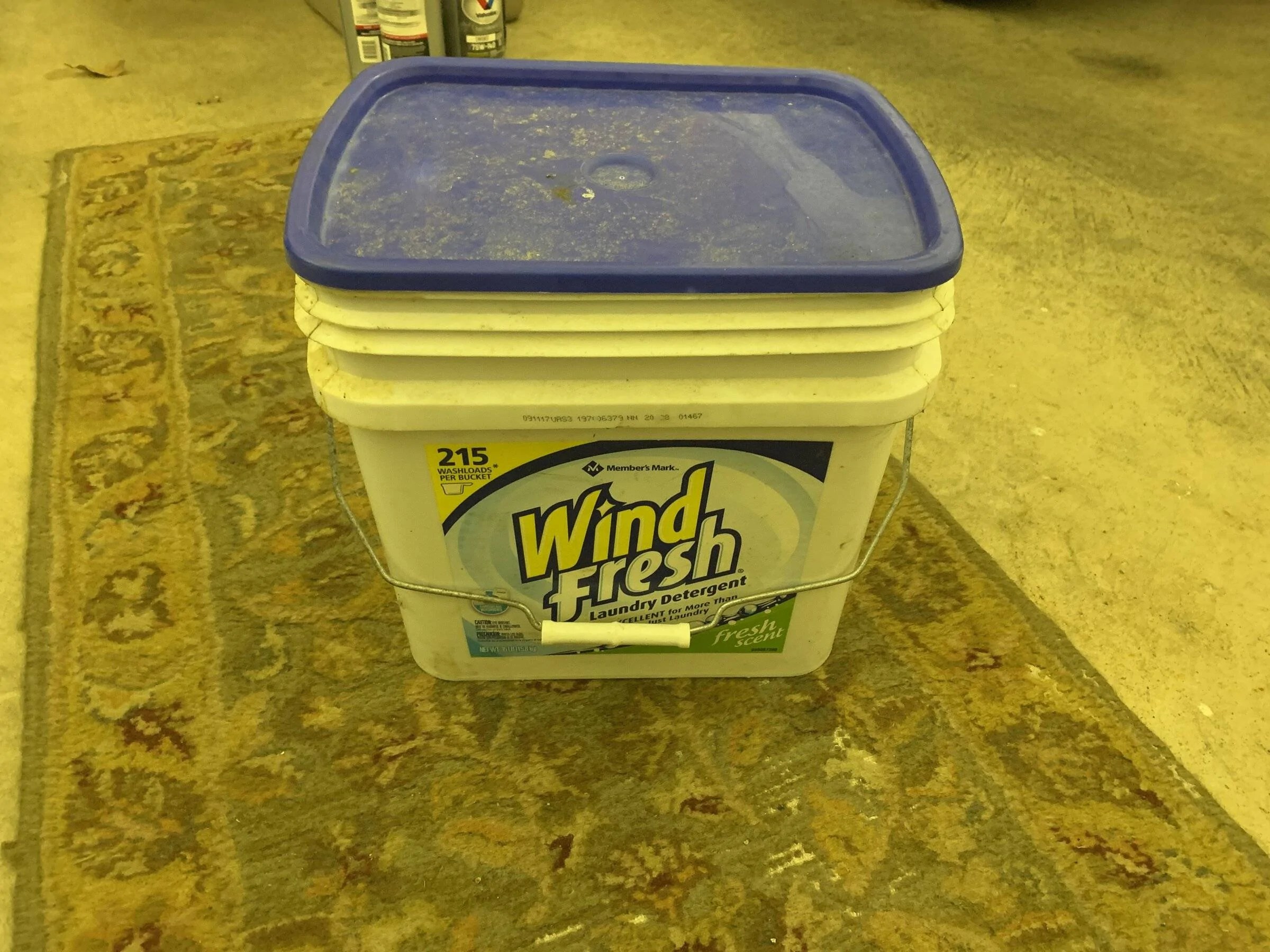

I don’t use an oil drain pan for oil changes as I know from past experience that the volume and flow is beyond the intended design. I found that an empty 5 gallon laundry detergent pail from Sam’s is perfect for this job. Plenty of capacity, and 12” deep works like a charm.
