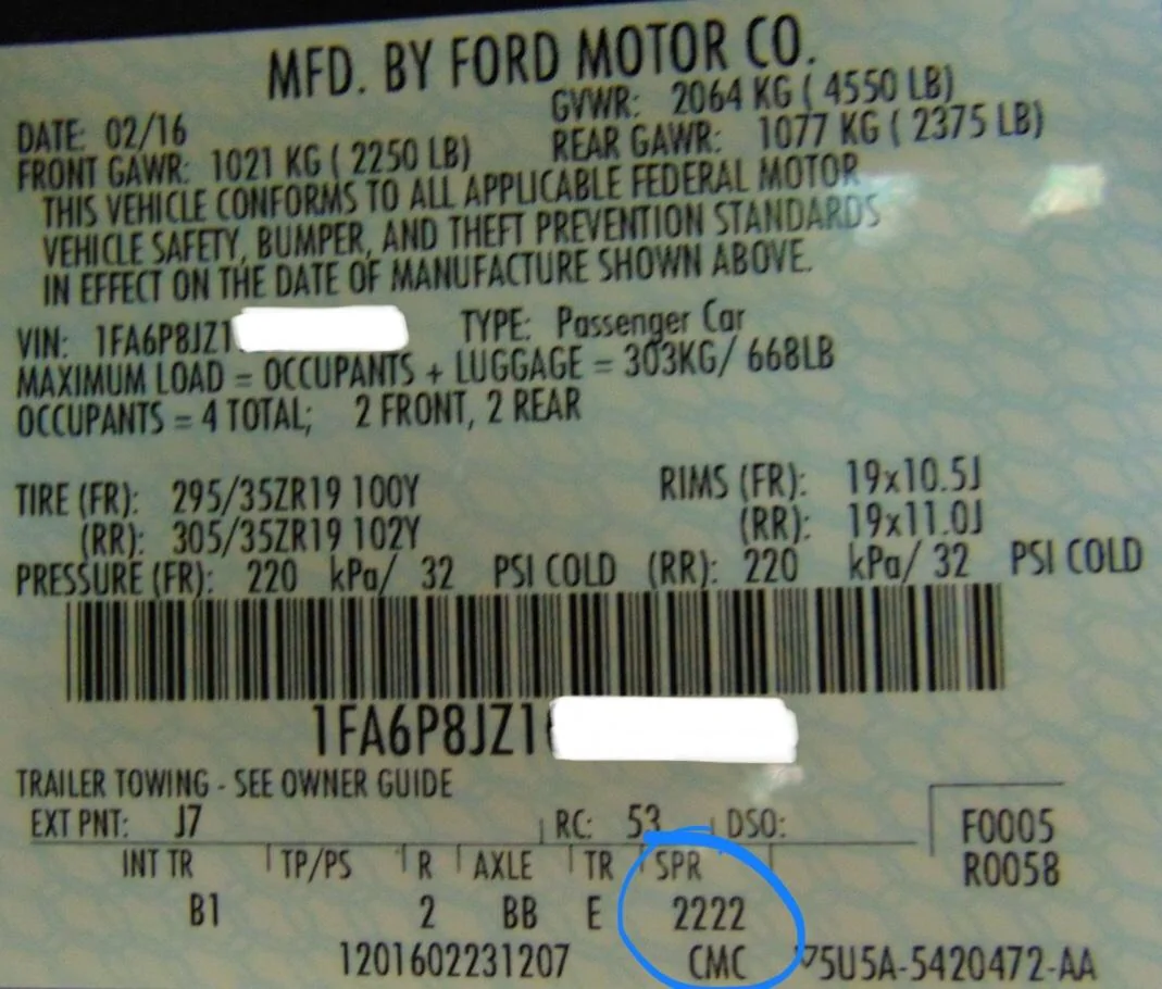

Just an FYI for those that did not know; the Ford Standards Certification label that is found affixed to the Driver Side B-pillar, seen upon door exit/entry contains many build codes.
In those the fields of codes, the FRONT and REAR factory spring codes are listed. The attached random image of a Standards Certification label is from a 2016 GT350. The spring codes can be found under the field labeled “SPR”, circled in blue.
I’d like to see a spreadsheet that captures as many of these factory spring rates as possible to see if there is any crossover between S550 models/years.
Anyone game?
My 2018 EB w/PP, the listed SPR codes are:
BBHH
EDIT:
In the example label, my blue circle encapsulated “CMC” but that needs to be excluded, as that is part of the last line of the label coding (sorry for any prior confusion).
Also, does anyone who may work at Ford or a Ford Parts House know the correlation of the codes back to actual spring rates?

55BB on my '19 EB without PP. Still, nobody has the rates for EB or EBPP?

Base Ecoboost here and I'd also like to know spring rates for my car so I can make a better choice although, I've had the Ford Performance Track Handling Pack in mind all along. My stock springs are AABB.
