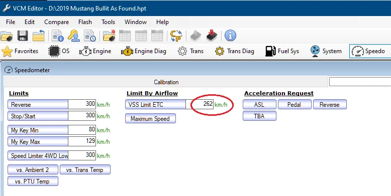

We need someone who has a Euro-spec Bullitt and an MPVI2+ interface (or any other tuning device for that matter) to confirm this.
I have an original HPT file from a Bullitt, but it's US-spec, so it may not be relevant.
My Euro GT had 250 in that field.
Maybe Euro Bullitts have a different limit?
