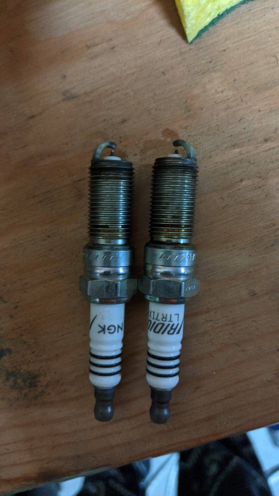

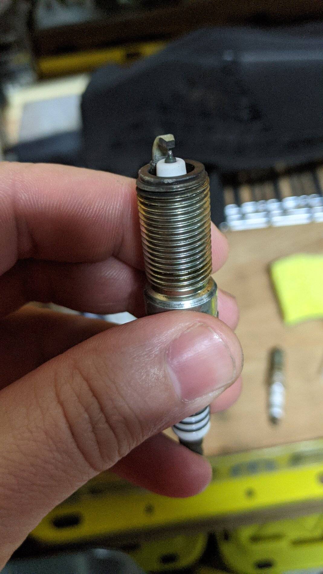

On a gen 3? How much boost? Would you happen to have any pics of the plugs after they were used?
25 psi at peak, one ethanol e85. 1,075whp

Those plugs look good but how many miles/passes on them? I'd think at over 15 psi a 7 heat range would be way too hot especially on a gen 3 engine.
