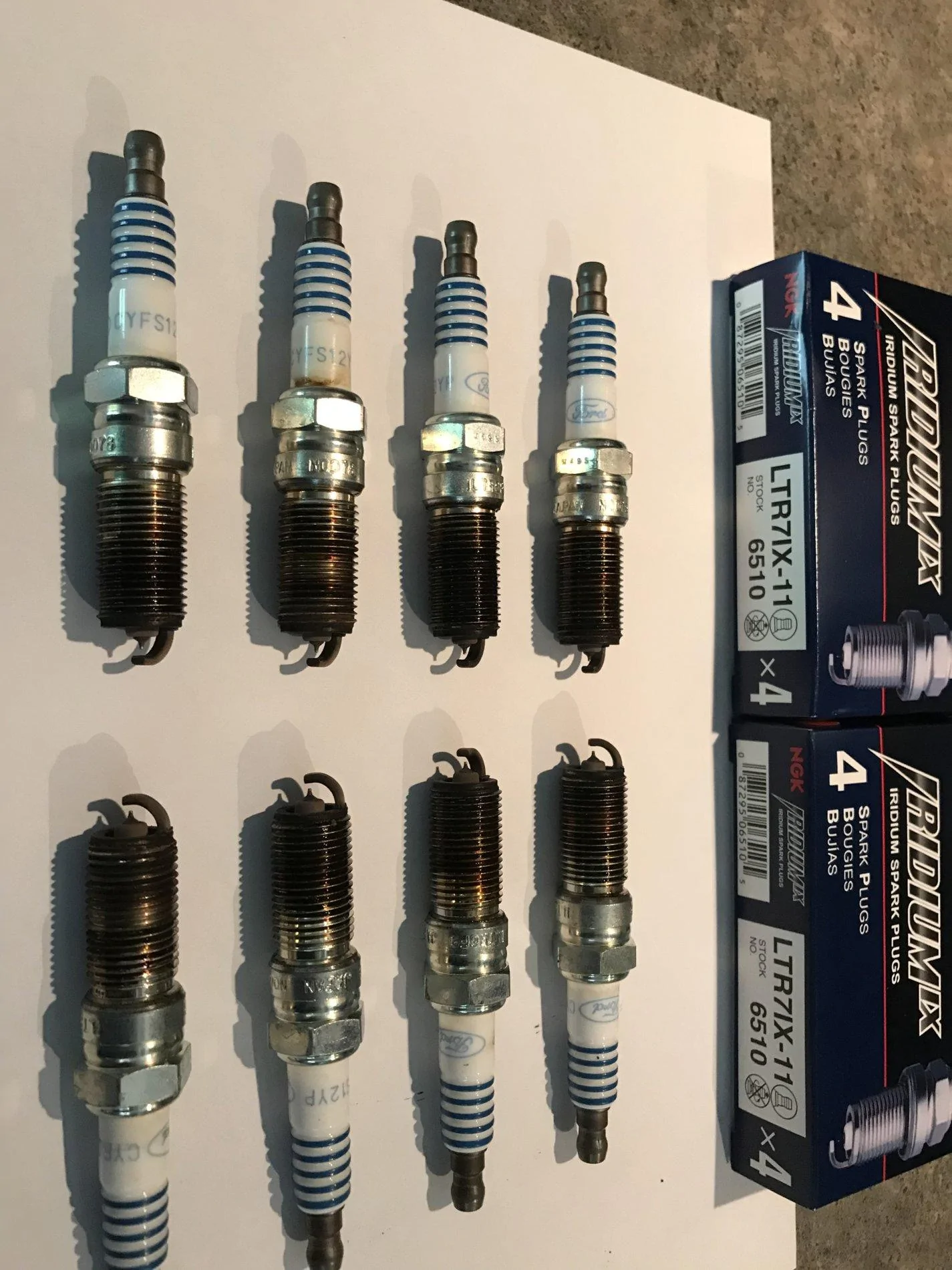

Looking to change plugs on my 2015 pp roush. Looks like the stock plugs were used and I have no clue as to what these should be gaped at or what a good upgrade would be.
Seems like tuners prefer silver plugs to get rid of heat. Any advice would be great. Mark

NGK 6510 gapped at .028.

17 lightning blue pp LFP 670
thats what i use and im stage 1 same gap also

Well I just got these changed out yesterday and its back to full power. The stock plugs were about 10 thousandths out as most were gaped at .038. What a difference. Thanks

Just remember. You have to change the plugs more often on a boosted car. I change mine every 5000 miles. (About once a year).That might be a little anal. But it’s also cheap piece of mind.

I just changed mine at 20k. I can definitely feel a little difference so I'll probably stick to every 15k moving forward.

ngk 6510 gapped .028 .. anti seize because the heat will effect that change in plug tread pretty quick, i have a blown 700+ hp 2018 and i think this plug is amazing. industry best IMO
