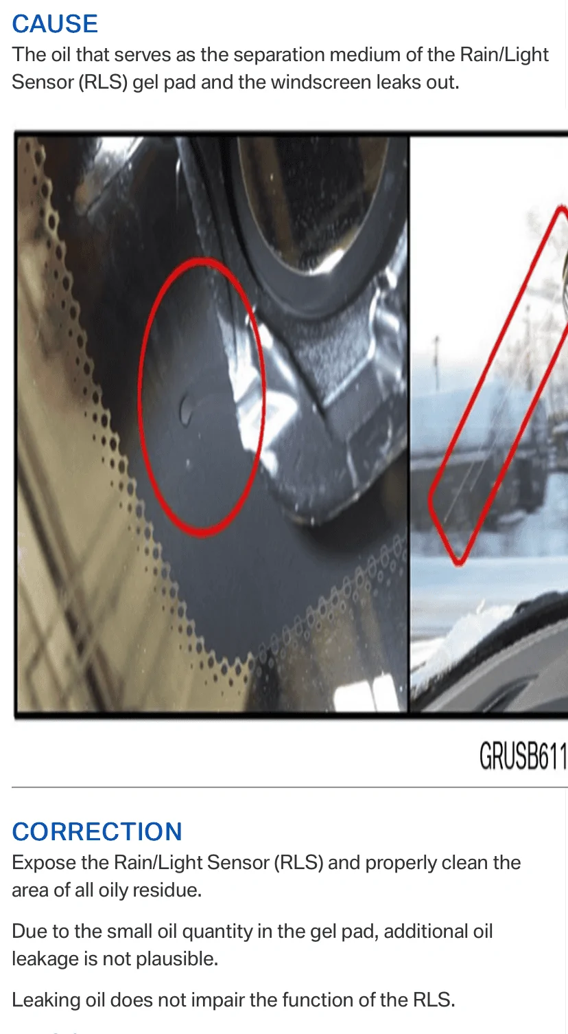

We have this issue on BMWs too, the part looks almost identical to the mustang. BMW has a bulletin for the issue - there is nothing to fix according to them.

Same problem with my 2020 GT. Oil drips out of the cover. Been cleaning it off but was worried it was an indication of something more serious. Sounds like it's just residual. I keep it in the garage and it's got less than 12k miles on it, in case that helps anyone.
