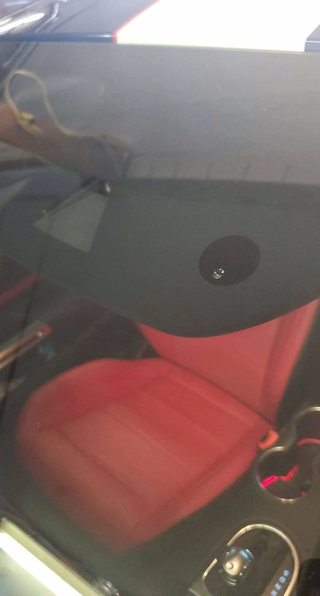

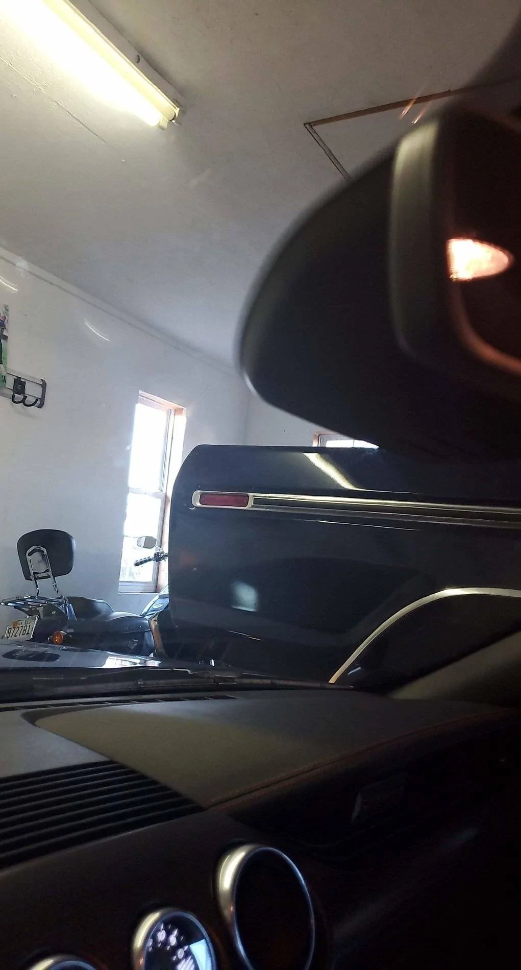

For a non smartass answer I went out and took a few pics of where it's coming from. My car is garage kept. The fluid is in definently not water it smears around when I wipe it off. Just was wondering if anyone else has had this happen
