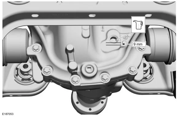

Fords recommendation as stated in the workshop repair manual states 9mm below hole for all differentials for the S550. That said I did run mine 8 oz overfull (coming out the hole) without problem. However, I have heard that overfilling this axle may cause diff fluid to be expelled out the vent tube. (The vent tube on the S550 runs from the top of the rear-end cover, over to the right rear fender well area, then up. I know of one user who stated that running/racing at speed at Daytona that he found fluid was coming out from the vent tube.
Everyone has their own preference on how to get new fluid back into the diff. Whatever works the best for you, is all I can say, and I hope the input from other users in the forum continue to help others with ideas and methods that have worked for them.

Thank you. What I'll do when the time comes, is check where the OEM fluid level is, and decide what to do.
