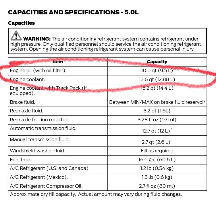

Hey guys,
I just went for the first oil change since I bought my used 2019 GT PP1 in September. Everywhere I look, owners manual, this forum, YouTube, Ford's website, it says the 5.0 takes 10qts. The dealer put in 8.5qts. Only reason I knew they put in less was I looked at the bill when I got home and saw I was charged for only 9qts. The person on the phone told me they were looking at the info on the computer and because my car doesnt have the track pack, it only takes 8.5qts. I can't find anything to validate that. That dipstick is a pain in the neck to accurately read so I am second guessing myself. How much should my car actually take? Also I saw on Ford's website that intervals between oil changes says 10,000 miles, the dealer says 5,000, which interval would you do?

The dealer is smoking crack. 10 qts. Trust the manual not the dealer lube center.

Track pack doesn’t change the engine, the 5.0 takes 10qts. Figure out what oil they put in, add 1.5qts and find a new place for oil changes. Or do it yourself and never wonder again.

He probably just assumed nothing's changed since the 15-17s. I know if I put exactly 8 in mine it's about in the middle of the good zone on the dipstick. If I put 8.5 it would probably be right at the top of the zone.
With the 18+ needing 10 qts, if they put in 8.5 in and your dipstick reads good, it either means you got an oil pan way out of spec or they didn't get 1.5 qts out when they drained it.
I wouldn't even make the assumption that what they wrote on the paper was correct. I'd drain the engine and determine how much oil they put in based on how much I drained, then refill it with the correct amount.

Dealerships like this are why I stand where I can observe how many quarts they put in and then I have the service manager allow me to see the bottles to verify the correct weight oil was put in....in my case, that would be full synthetic 5w50.
The dipsticks definitely suck in these vehicles.
OP, did you drop your vehicle off for the oil change? Always check the paperwork.....and then take up any issues directly with the service manager.

Cannot believe that in the 5th year of the Gen 3 motor we are still dealing with this crap. Tell the moron who worked on your car to show you were a Gen 3 5.0L Coyote takes 8.5 quarts.
