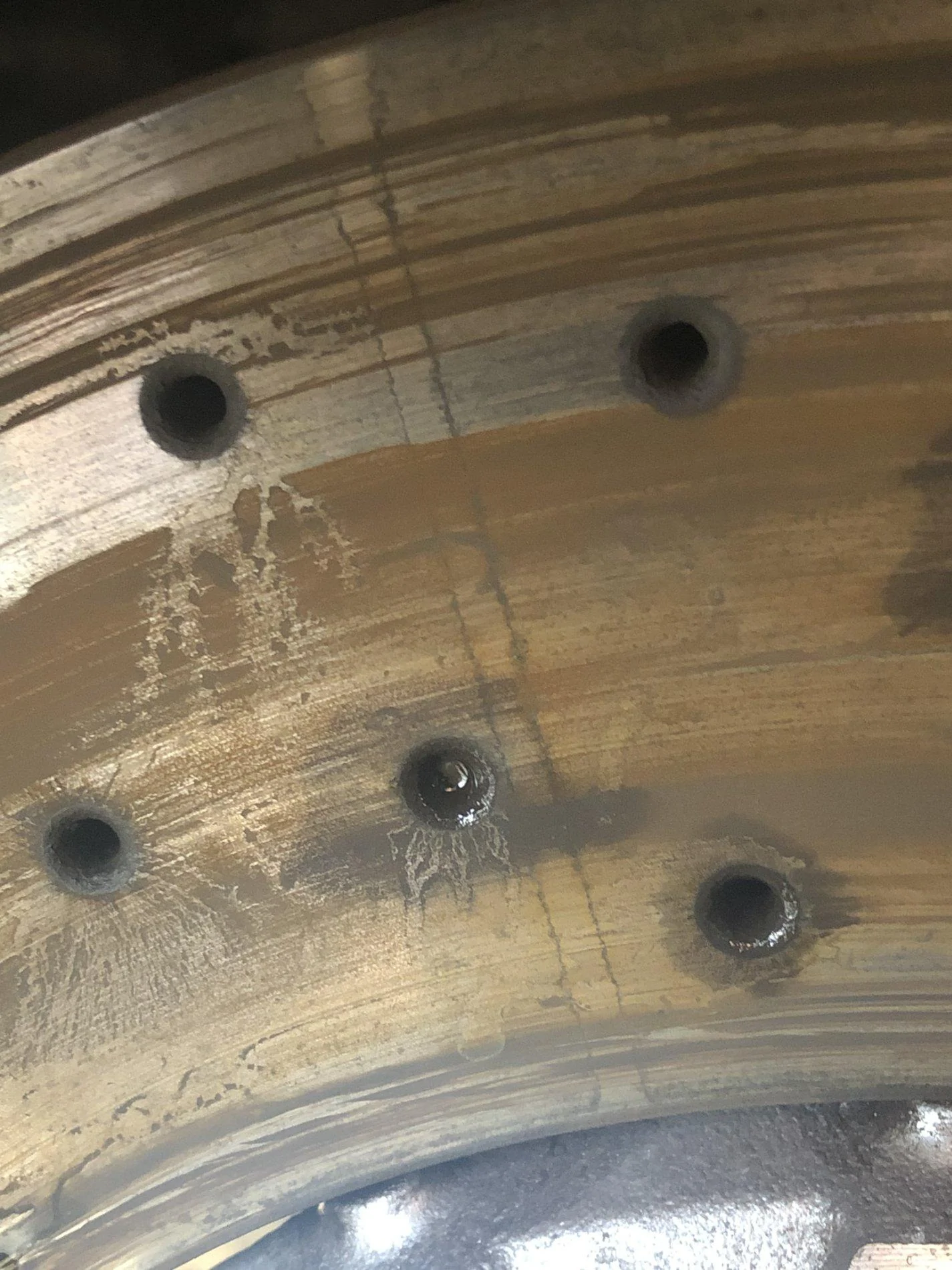

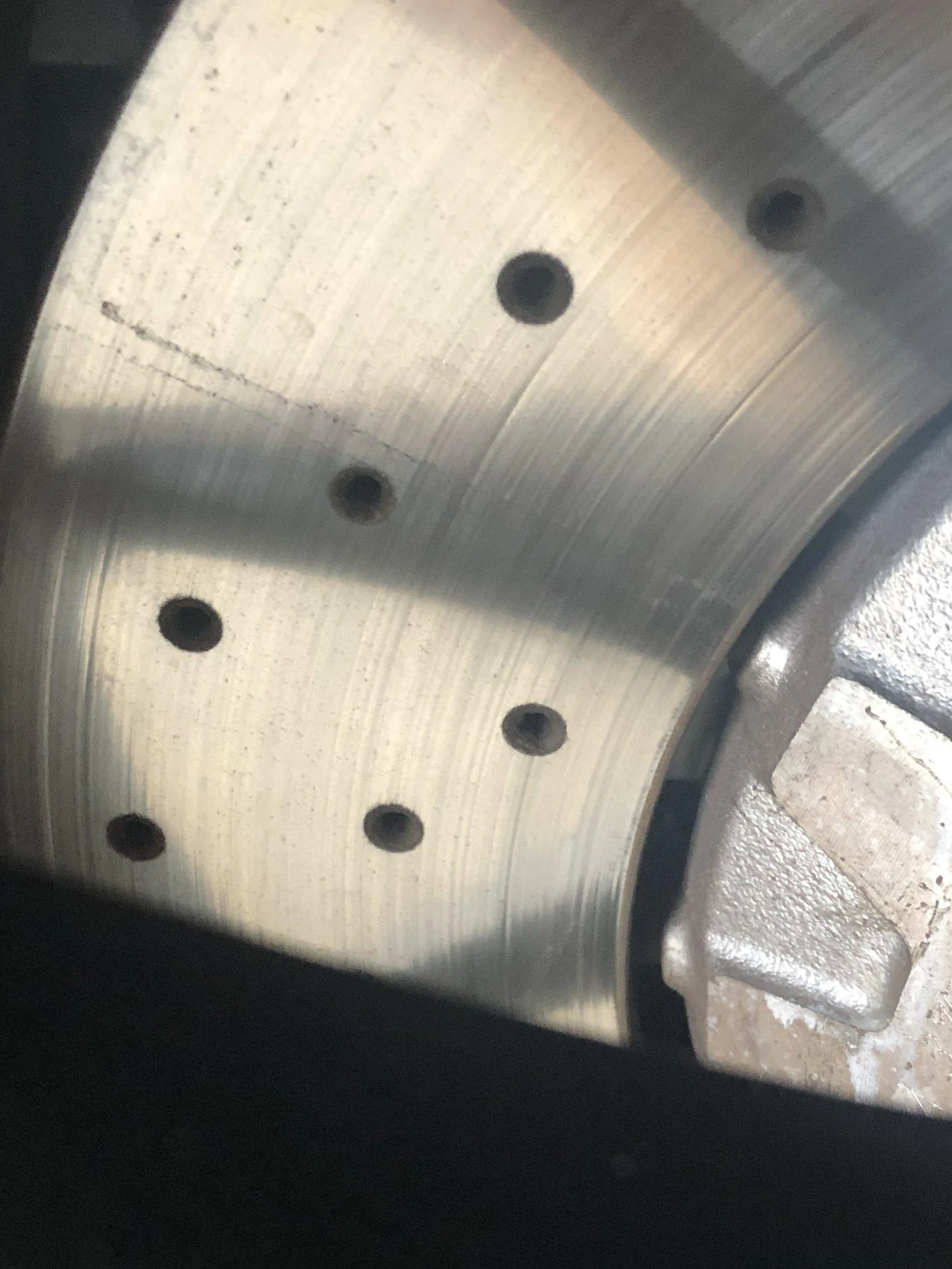

Just got my car out from under the cover and got her out for the first drive of the year. Of course, I did all the normal preseason checks such as oil, tire pressure, leaks etc. When I got back from my 20 mile drive, I double checked everything and I noticed both of my front rotors have a multiple cracks running down the entire face of the rotor, and the rears are cracking as well. I did check them before my drive, but there was some built up corrosion from sitting so I couldn't really see. I didn't have time to take the wheels off last night and see how deep they go, but it is concerning due to the fact they run from edge to edge on the rotor. My car only has 4,4XX miles on it and I haven't tracked it so I'm not really sure how the brakes would have gotten hot enough to crack that bad that soon into their life. I realize drilled rotors are prone to this, but I wouldn't think street use would cause this that fast.
My 2 main questions are:
1. If the cracks are just superficial, are they ok to run or should they be replaced?
2. Considering the mileage, could this be a warranty item for defective rotors or something along those lines?
EDIT TO SUMMARIZE:
My rotors appeared to be cracked. I called the local ford dealer and determined rotors are covered under 3y/36k warranty as long as the damage isn’t from abuse or external sources. I pulled my rotors this evening and thanks to @DCShelby took some sandpaper to what looked like cracks and the void I was feeling with my fingernail was actually pad material creating 2 tiny ridges and a valley on the rotor face. I was incorrect in my initial assumption, but I suppose it’s better to be wrong and overreact than not and have a rotor let loose on the interstate. Thanks for all the help and responses.

Pics would help.
Like you said, you don’t know how deep they go but I would definitely bring it in for a check, possible warranty replacement.

From my limited knowledge, drilled rotors tend to have small spider type cracks emanating from the drill holes, not the edge to edge as you described.
Google it.
Yeah definitely wouldn't be as worried if they were coming from the holes, but I believe the D/S front has one big one that is in between holes. I'll definitely get some decent pics up tonight and get it to the Ford dealer.
Ugg, I edited my post. Forget about what I said about my limited knowledge....It’s very limited :crackup:.
Track Mustangs Online has a good thread on this subject.

IMO if cracks go to the edge they aren't safe. Pics would be good though!

Not cracks in the rotor itself, it’s the pad material that’s been deposited on the rotor that seem to have cracks or flakes. You can take the rotor off and clean them up with a polishing tool. The Autofanatic has a video of it.
They seem to be in the rotor itself. Running my fingernail over the cracks there is a clear void or whatever you want to call it on them I can feel. The video you referenced was to clean up deposits and scoring, which is not what I'm seeing on my rotors.

I put a call over to the Ford dealer we contract with, and the service manager there told me it is a warranty item covered under the bumper to bumper as long as it wasn't damage caused by an external source or blatant abuse. So, looks like I'm getting a new set of rotors. I'll still post up some pics tonight just for the sake of sharing with everyone here.

Definitely appreciate the solid advice on track days or hard driving with drilled rotors. My route home from where I take my car to play has a solid 5 miles of brake free driving where they can cool before they sit. I have yet to track my car, so the heat cycles my rotors have seen have been minimal at best. The cracking I'm seeing is consistent with pictures of cracking I've found on cars with 15-20 track days on them.
