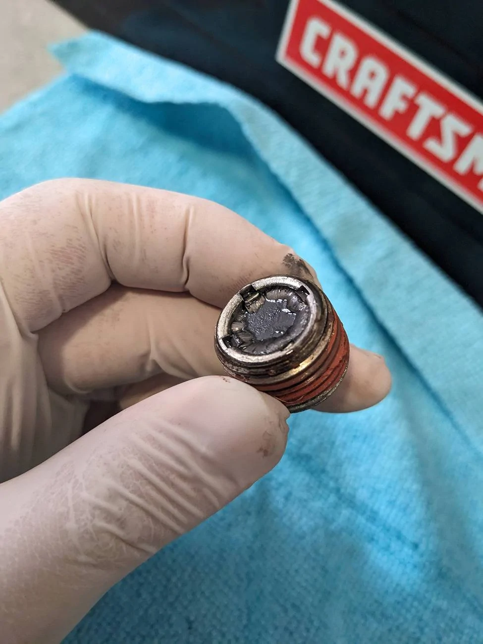

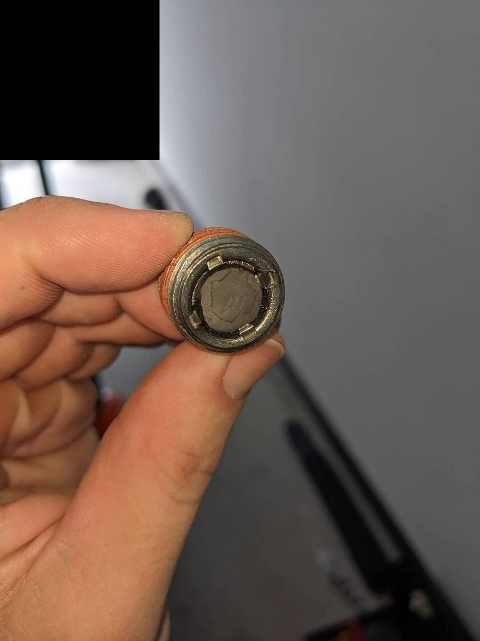

Changed the fluid out today. Pics below for reference. No signs of any leaks anywhere on the diff or axles that I could see, although you'll see there is SOME sort of fluid spot near the rear wheels. I started noticing that in the last month or two, but I figured it was just water/tire shine I was using when I detailed the car. Haven't washed or detailed it in about a month though.
Magnetic fill plug did not have anything concerning as far as what I see, pics below show it before and after cleaning. No large chunks. Feel free to chime in if you would be concerned by what is shown though.

That's how my drain plug looks every time. I wouldn't stress too much about it. IMO, it's your other wheel bearing, especially with it being more pronounced in the corners.
When my wheel bearings went bad, they had zero play. I just kept getting a suspension fault light and fault speed sensor error. Pulled the bearings, sure enough it all went away.
I can't hear anything in the video, but I can tell you mine has an ever so faint howl, that has been noticable since I put the rear seat delete in.
