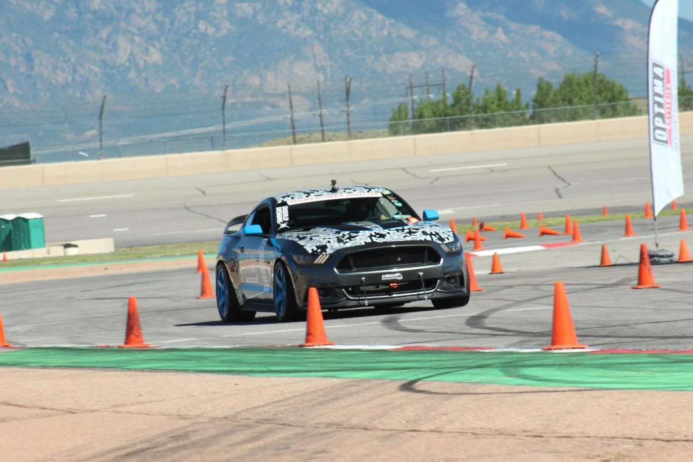

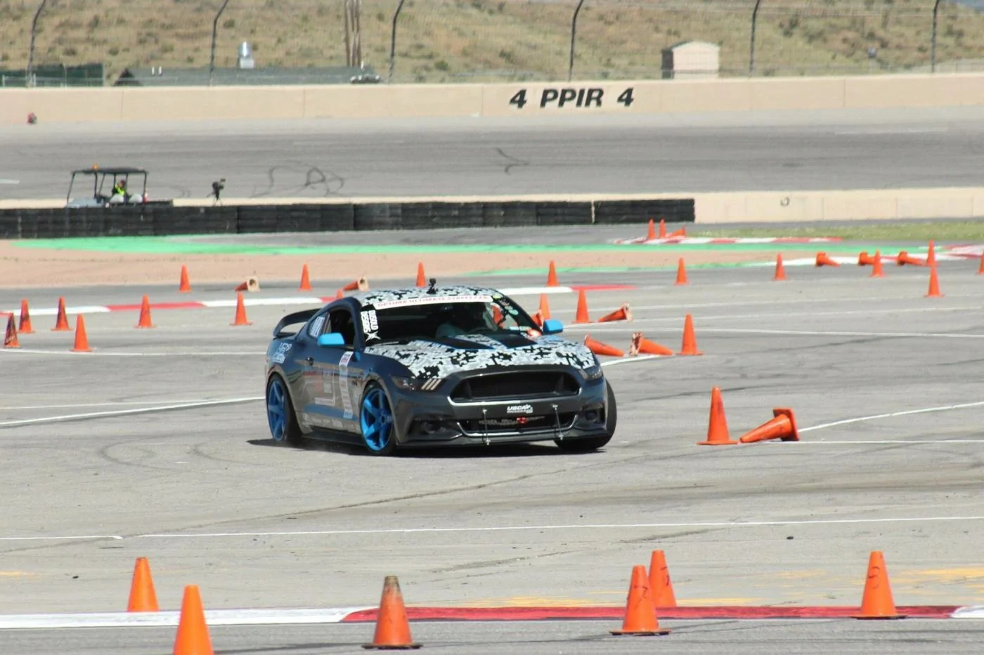

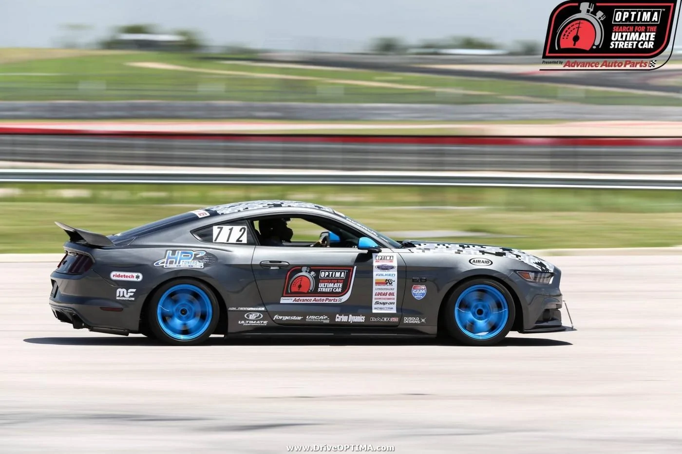

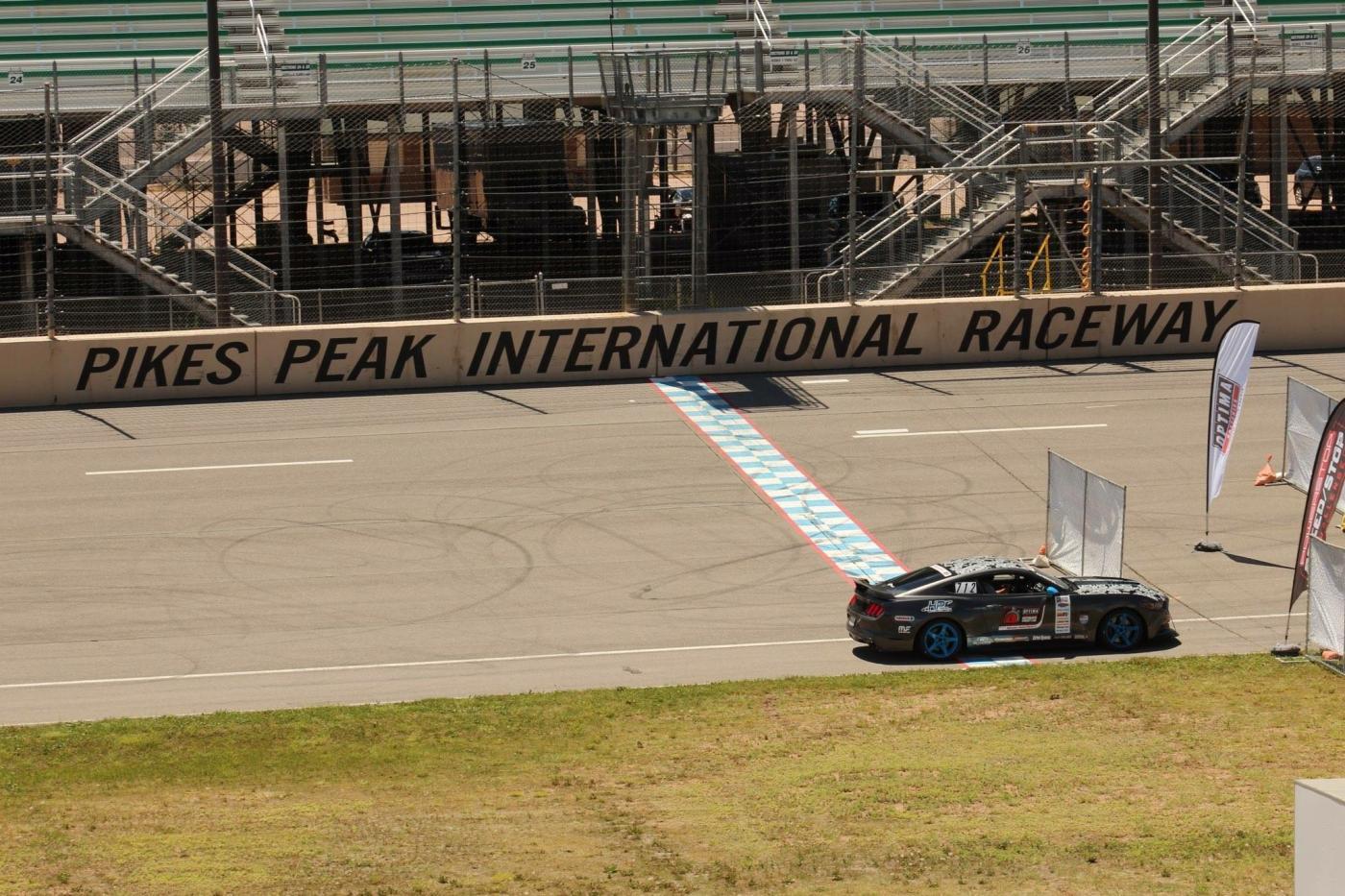

The car preformed great last weekend at OUSCA PPIR event. These events are so much fun, if you have not done one, you need to put it on your list of things to do!

Just an update on "Real World" gains we made on the car in the last year. Power wise the car has stayed the same, but we spent a lot of time in the offseason dropping weight in some key places with Oddessy battery, Baer 2 piece rotors, Tiger Racing Hood, Carbon Dynamics 350R spoiler, and a Driveshaft Shop aluminum driveshaft. The biggest changes were the switch to BFG Rival S tires and RideTech Level 3 coilovers! The amount of grip and control off the corner has really made a difference. We will take it as a given that the times from these OUSCA events were on different days and you can not replicate track conditions, but the drop in lap times is evident.
OUSCA NCM:
2015 Best Lap 1:40.007
2016 Best Lap 1:38.651
OUCSA PPIR:
2015 Best Lap 1:05.444
2016 Best Lap 1:04.055

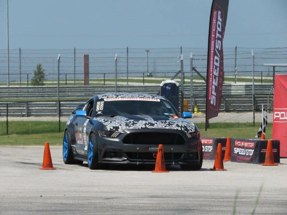

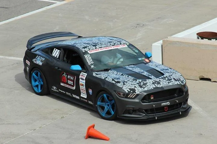

I had a great weekend at the COTA OUSCA event! I was able to win the speed stop, Placed second in AutoX and Road Course, and tied for third in D&E. Once the point were totaled I took home the GT Class win in the biggest class of the season and a second consecutive invite to OUSCI at SEMA! Vegas here we come!
