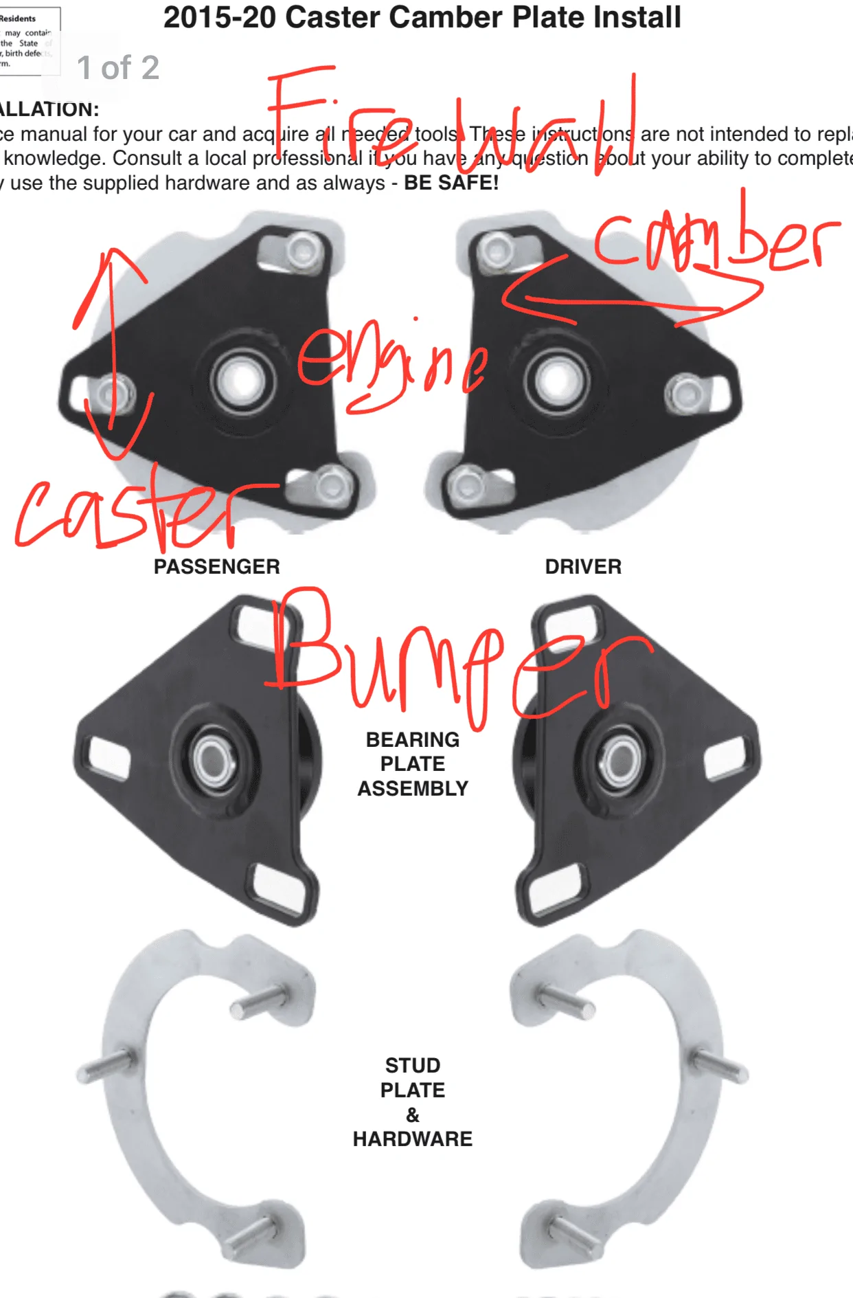

I see the AM Maximum Motorsports install on YouTube, and their plates look similar to the SVE. However, Is there by chance a specific video showing proper rotational positioning of the SVE camber plates when I rebuild the Struts?

From looking at the product page and the one video that somewhat shows it, I think this is correct. The install page seems to show proper orientation.

I think you're right. The design looking very similar to the MaxMotorSports would indicate the slightly curved edge on the triangle plate would go forward. If the front strut stud is most inward, then that would make the camber slots on the triangle plate perpendicular to the drivetrain, which is what it needs to be.

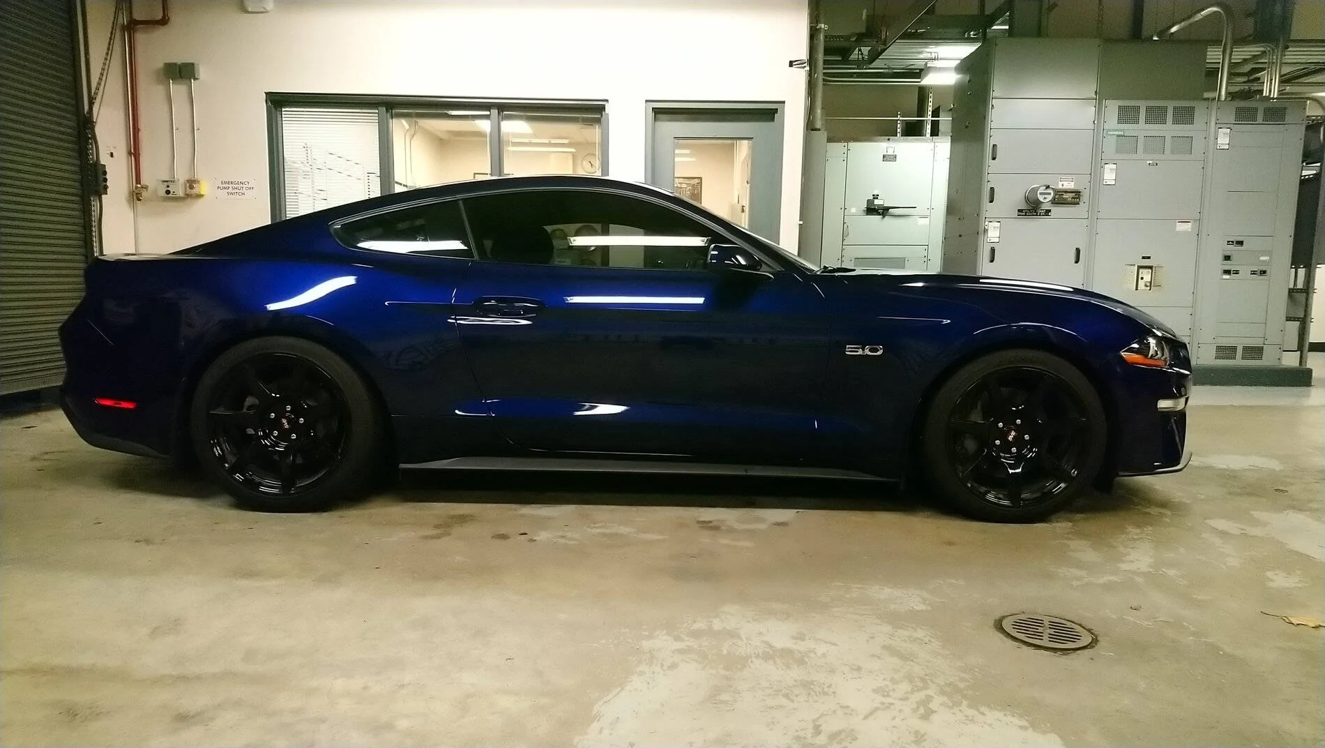

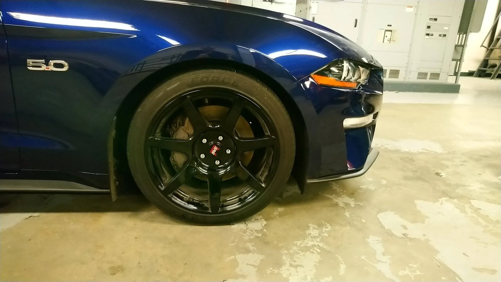

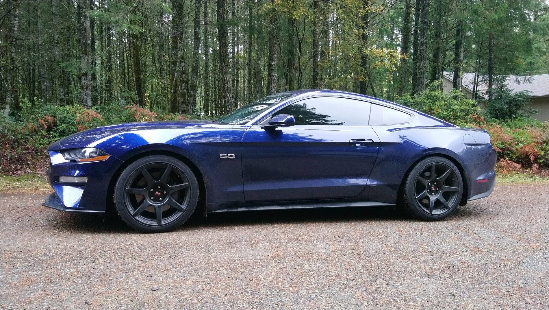

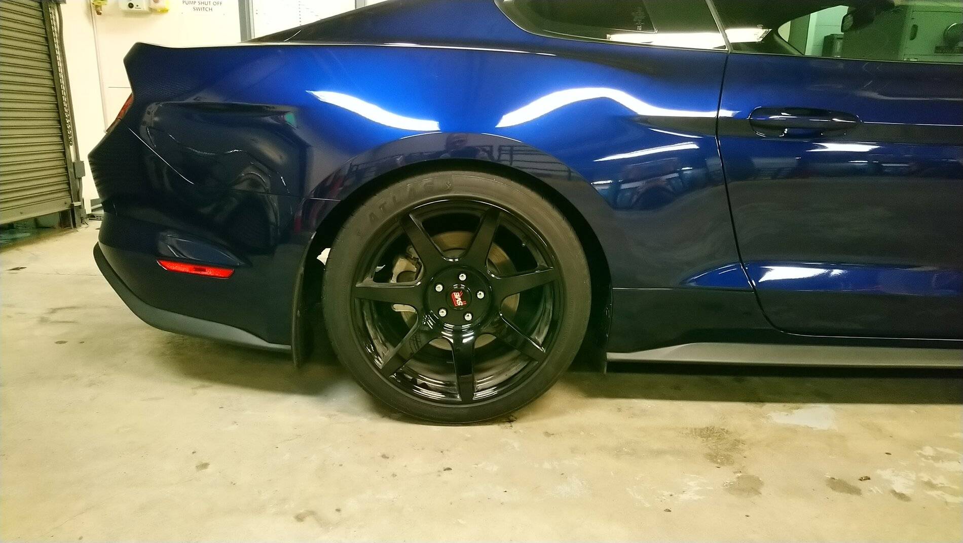

Just got done with an alignment. I asked the Tech, (who's a Challenger owner) to clock all bushings front and rear. He knew exactly what I meant. Thank Heavens, because I took it to Leslie Swab, and they looked at me like I was from Mars when I mentioned this. The guy at Point "S", formerly Big "O", understood my jargon.
Anyway, the front is still the same, 1/4" higher than the rear at 27.25" rear, 27.5" front. I'll just drive it for several months to work everything in. If it's still 1/4 high in the front, then I can get a set of Steeda Spacers for the rear, and some Rear Camber brackets, since the rear camber is at 2.5 degrees. I may want that a little less. Outside of that, everything seems to run pretty darn good.

The front just doesn't seem like it dropped much at all. It better settle, because it was a lot of money and work to get a 1" drop for better performance. So far, not so impressive. Time will tell.
