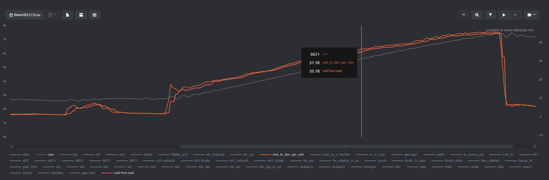

Do you have a BAP? If not add one, or buy the DW400, and still add a BAP.
I took your log and did some math in excel and reuploaded it to my datazap.
First I thought clutch slip, but nope your RPM to OSS indicate no problem with clutch or transmission.
I notice your load is slightly low from what I would expect. I suspect your fuel pump is maxed out.
The way I check this is I take your load as a fraction and through some math convert it to a rough MAF value. Then compare what your MAF sensor says and what the ECU is saying from load. Usually they are dead on, except in transients, unless you have a fuel issue that was compensated for.
From the picture you can see MAF from load is lower than than your MAF sensor. The ECU is compensating for a lack of fuel rail pressure relative to its inferred pressure tables, my guess. Then again its through out the entire range, so it could just be a vacuum leak.
Oh and why is this hurting performance? The car is thinking its moving more air than it really is, so everything is setup for that airflow instead of the actual airflow. Your KR slowly made its way to 8*, this is what the stock tune does. Get that down to 2-3* and having all the timing available right a way makes a big difference in the way the car feels.

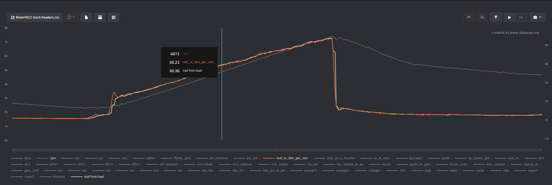

Wow, I guess I'll check for a vacuum leak. Could my fuel pump be going bad? I've never heard of anyone needing a BAP for just bolt ons. Thanks! I guess I'm not crazy after all. Also you mention airflow, I'm not using the stock MAF sensor. I bought the PMAS No Tune required intake but never switched back to the stock MAF sensor once I got a tune. Could this be tune related for them not taking that into account? I told them I still was using the PMAS MAF sensor.
Also here's my log before the Longtubes. Are you seeing the same thing with this one as well?
https://datazap.me/u/brianh922/lund-e85r-18-mani-lu47s-stock-headers?log=0&data=1
Nope, Load coverts to MAF dead on. If your tuner knows its the Pmas no tune MAF in a Pmas housing, They should have it where it needs to be. What happens tho is if your fuel pressure is low, since its inferred, they can end up raising the MAF to compensate. Could just be an exhaust leak causing a false lean too, since it happened after exhaust work.

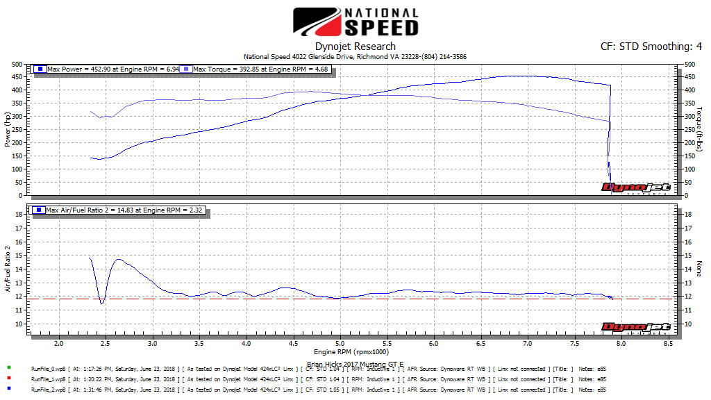

Well my dyno confirmed it must be me. 453/393. Did 3 pulls, 2 with the hood closed and one with the hood open. Both of the hood closed pulls were consistent with 446/386. Mark I didn't make any changes to car other than double checking the vacuum routing and make sure there wasn't a leak. So is it just the way my tune is setup or is there something possibly wrong with my fuel system?
