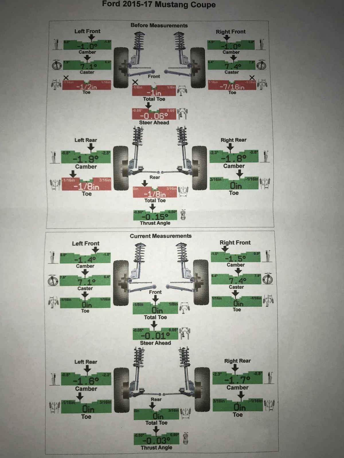

Car is done, back from alignment. I'm sure ill have some sway bar/end-link adjustments and another round of rebound adjustments on the dampers to make. Car still looks bone stock from the outside other than the tow hook mount now poking out from the lower portion of the bumper cover. Have yet to drive it other than back from the alignment shop as ive had the flu for the past 2 days, but i did push the car through a right hand sweeping corner at speed and the front end felt much tighter (front control arms) whole car felt flatter (sway bars). Looks like Ill be heading to Thunderhill again sometime early next year. This time I will take the necessary tools to make track-side adjustments to the sway bars and end-links.

Well, last night, I finished adjusting the sway bars (stiffening) threw the new wheels/tires on and *&^%, my rear sub frame is out of alignment. Drivers side rear is poking a good 1/4 inch (camber 1.6) and passenger side rear is well tucked (camber 1.7). I have the Steeda sub-frame alignment inserts, but I guess they don't completely eliminate it all and require manual adjustment. Going back up on jack-stands tonight to see If I can get it moved over.

Just spoke to Steeda, they said that if I have their alignment dowels in there, then there is no way my sub frame can be misaligned, and yet my rear end is all out of whack, so not sure what to do. I am still inclined to check it and see if it can be moved at all. I read elsewhere on the forum that this problem existed and the individual adjusted with the dowels in place. Any thoughts?
SJulian10mm
SJulian10mm
Jan 16, 2017
373
113
Marysville, Jefferson
Mustangless
Got it sorted, camber was way out of whack on that side. Steeda Camber arm jam nuts had loosened and the adjuster backed out, I probably had positive camber on that side.

Just ordered the QuickTrick Xtreme, I am doing my own alignment. Tired of paying the alignment shop $190-230 to do an ok job and round off my jam nuts. Steeda would it be possible to get new camber arm and toe link jam nuts?
