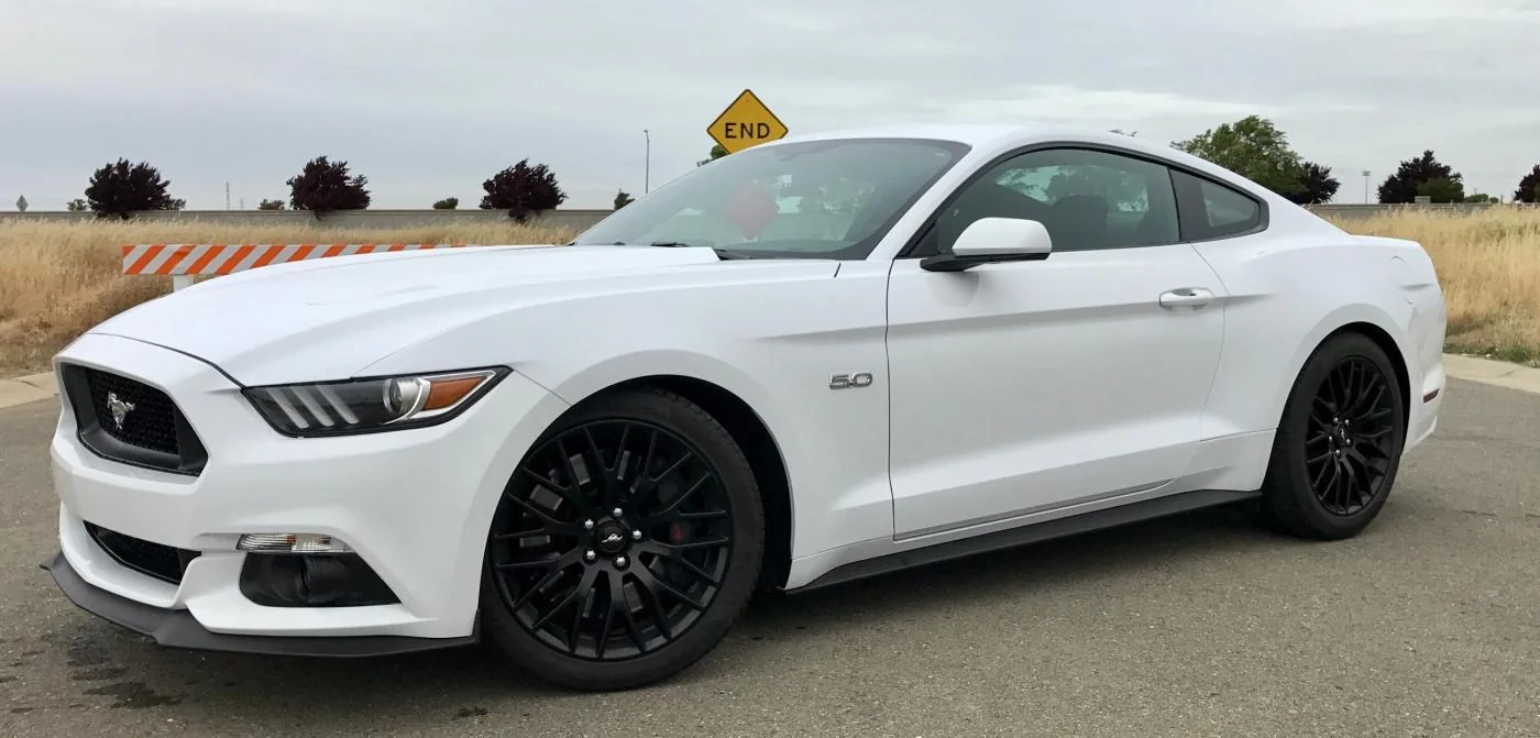

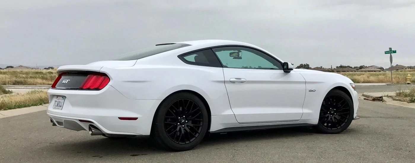

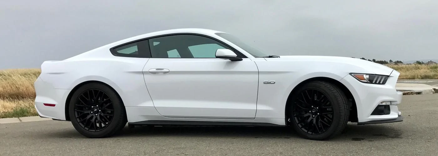

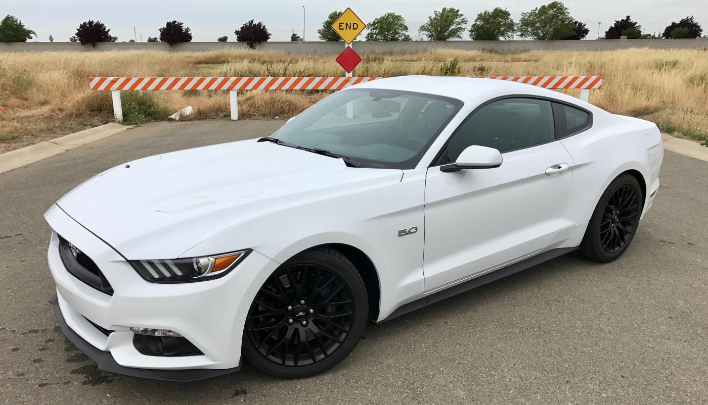

Here is the car in its current form...looks stock, but its far from it...kind of a sleeper if a 5.0 Mustang can be a sleeper! Just being able to put power down the way it does makes it much quicker than a stock one, never-mind PP2.
