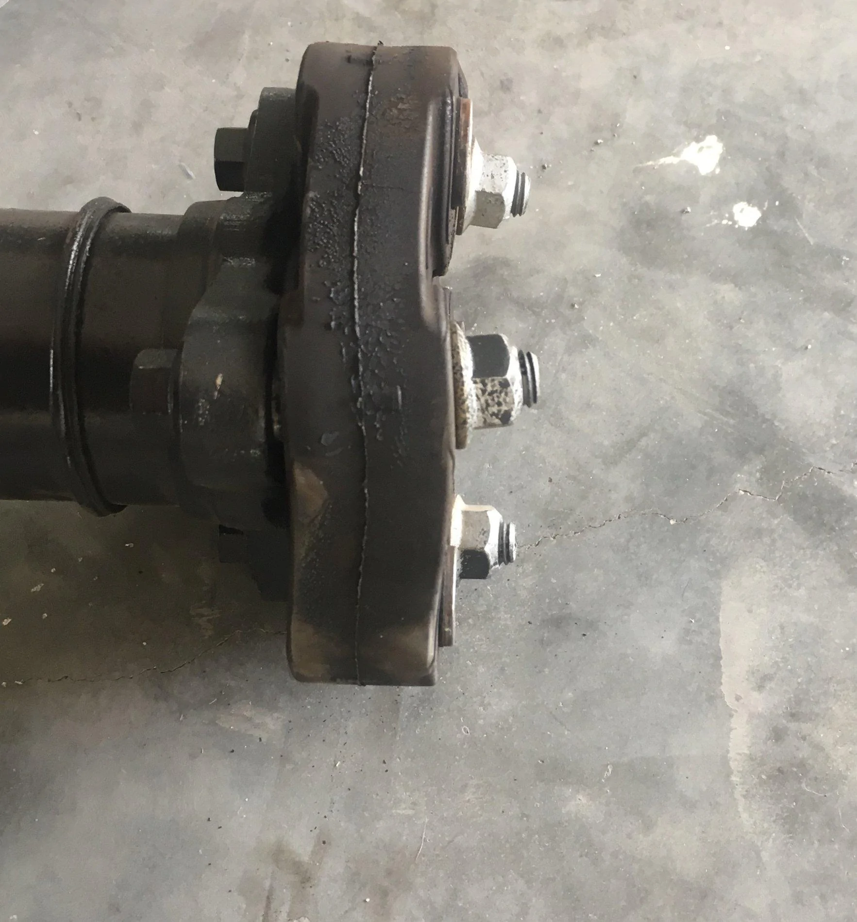

Manual life on the strip dictates that the shaft may not even be an optional upgrade, unless you want to keep replacing bolts in the guibo....
I went QA1 for several reasons. Cost wasn’t one of them...:curse:
As @Dalton@Evolution mentioned, a CV is pretty handy when getting the angles right (less to deal with).
The fact that they actually torque test them is also promising.
Finally, not destroying the underside of the car (or yourself) IF it fails is a pretty handy thing.
