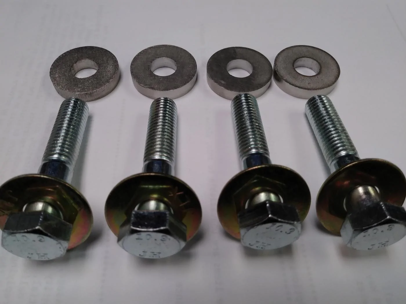

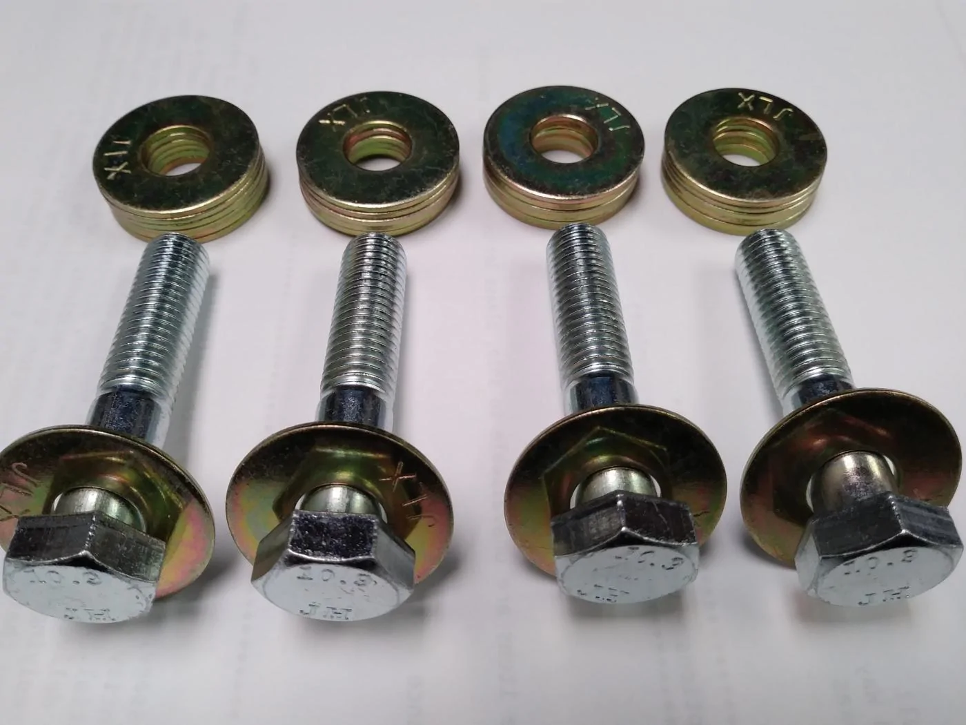

Well the OP wanted to know if there was a solution.
Many of you have shimmed the trans down, with success. I myself have experienced similar success.
So that said, this is not a BMR part # or an "official" part....but I spent some time putting together some hardware if any of you are interested.
Two options.
1: Adjustable Shim Kit. $40 shipped
-Adjustable from .068" to .396" using (6) shims per mount that are .068" thick
-(4) new Grade 10.9 bolts that are proper length to account for shimming, with zinc coated washers
2: Fixed Shim Kit. $47 shipped.
-Fixed .250" shim kit.
-(4) Stainless Steel shims, precise fit, that are .250" thick
-(4) Grade 10.9 Bolts for proper thread engagament, with zinc coated washers.
If you want these, you have to call me. They are not a specific BMR product and do not have a specific part # - I have to manually enter the products.

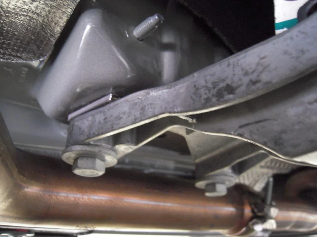

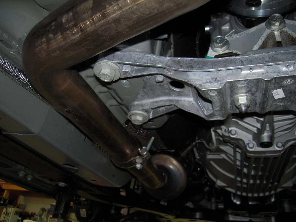

Here's a couple snaps of the crossmember and with the shims installed...
1/4" shim took my output shaft angle from down 1.5 degrees to down 2.5 degrees. Pinion angle is +3.5 degrees.
Whats the torque spec on the 10r80 cross member bolts?
Dominant1
Jun 17, 2016
94
3,724
1,129
Dr Frankenstang
2016 gt/cs auto 3:55 gears
18 mm bolts 85 Ft lbs
