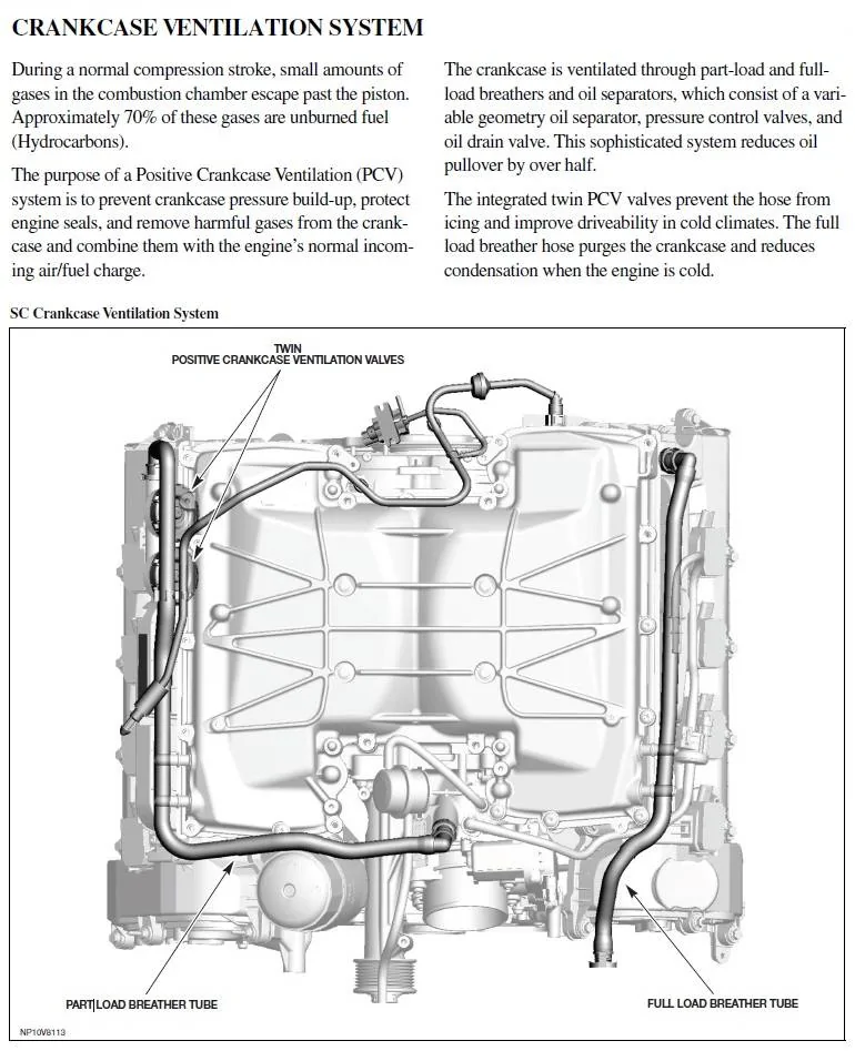

This ain't a 2-stroke or a drag only engine. You need a crankcase breather & metered PCV valve.
Every 700+hp factory hellcat / redeye / Audi / Ferrari / even 2000hp Heffner Performance TT Lamborghini's today is equipped with just such a layout. Dunno why street driven coyote guys think otherwise.
But if yer a fan of oil leaks, ring flutter, etc., by all means run what ya want. Just my opinion.

I mean in theory, the setup I purchased is just a fancy breather setup. Is it not? Hoses run from the factory PCV hook ups to a vented can.

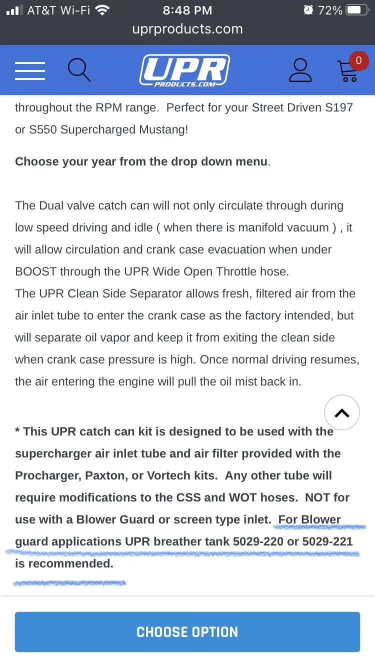

Interesting and a little confusing as the one I purchased and linked in my first post says it’s great for supercharged vehicles running a centrifugal blower. Yet the one you linked says it’s specific for boosted applications lol.

The closed system is not needed.
It is 99% for emissions. Boosted or N/A there is no vacuum to the PCV valve under WOT.
My point more or less is understanding CCS vs. OCS.
99% emissions or not, capturing 70% of unburned blow-by hydrocarbons and reintroducing them into the combustion chamber with limited pullover isn’t a bad thing for an on road vehicle.
Now, if we’re talking all out competition on the ragged edge power wet sump engines we need to start a different discussion.
So we’re all clear, I’m not good with poisoning the air if it can be avoided, I’m not good with Catless modern street driven vehicle’s but that’s just me being me.
