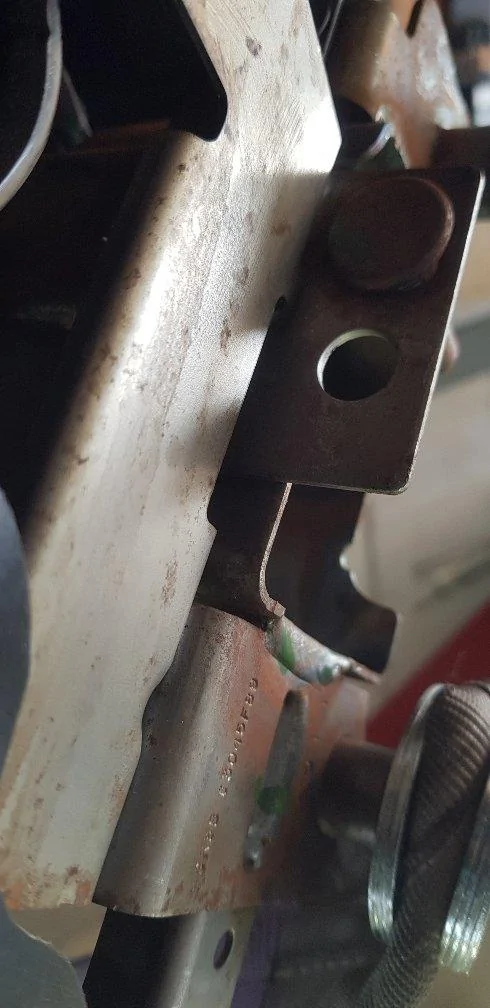

Looking at the location of the leak, I don't see how it would cause rust on the side of the dash?
Funny you should mention...exactly the same thought I had yesterday. I'm beginning to think that the issue I had last year was different to this one related to the grommet. The place that had it last year did refer to a repair to a seam behind the A pillar - very vague, but I think that was the original, bigger issue. Then in the background, a small amount of water was getting in through the grommet too!

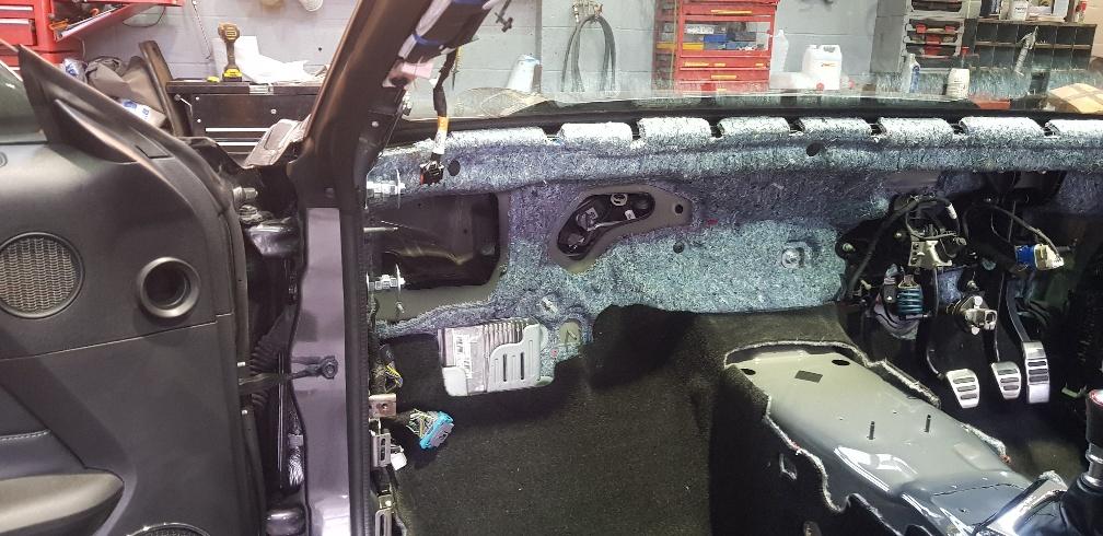

The surface corrosion is on the cross-car-beam. Typically, this area of the interior we regard as a "dry area" and thus, usually such components won't require being made from a corrosion resistant material, or having a coating applied.
Therefore, even in the presence of excessive moisture, in this case, the water logged NVH panel, behind the dash-panel/bulk-head. Some superficial surface colouring may occur.
I can only imagine what it must feel like, to have your car dissassembled to such an extent, but it will go back together, very well.
Hopefully never to need such work again.

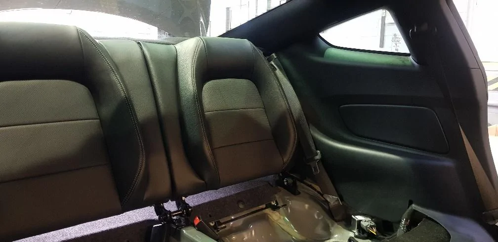

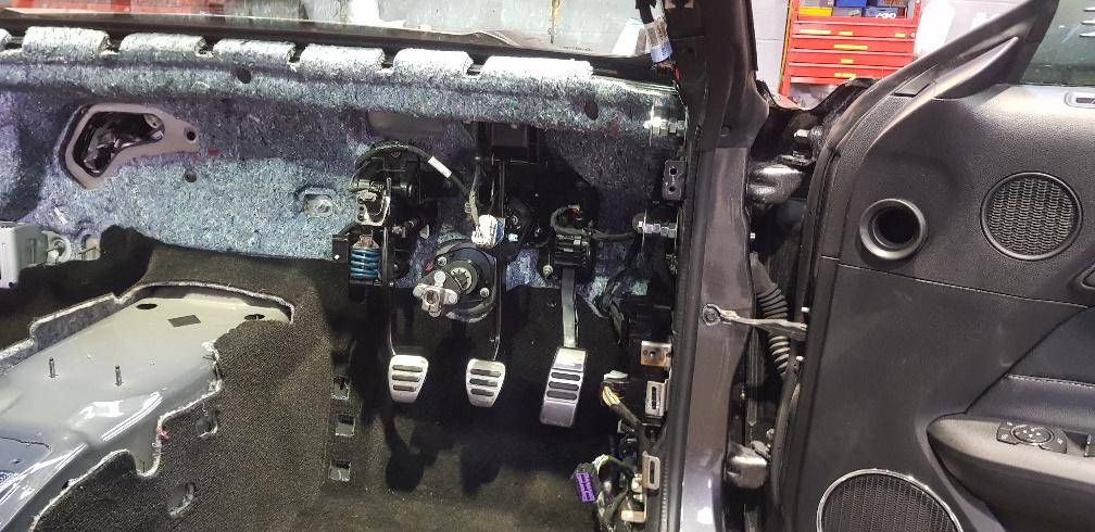

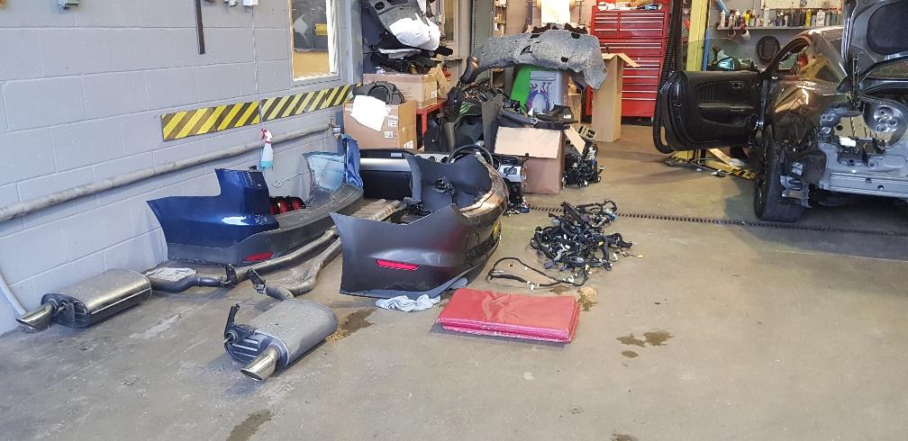

Wiring loom installation is well on the way now - the body one. Soon to be followed by the dash loom, and addressing the corrosion on the cross beam.
getting artistic now with the progress shots lol
No arguments about them doing a thorough job. Exhaust is off too :inspect:

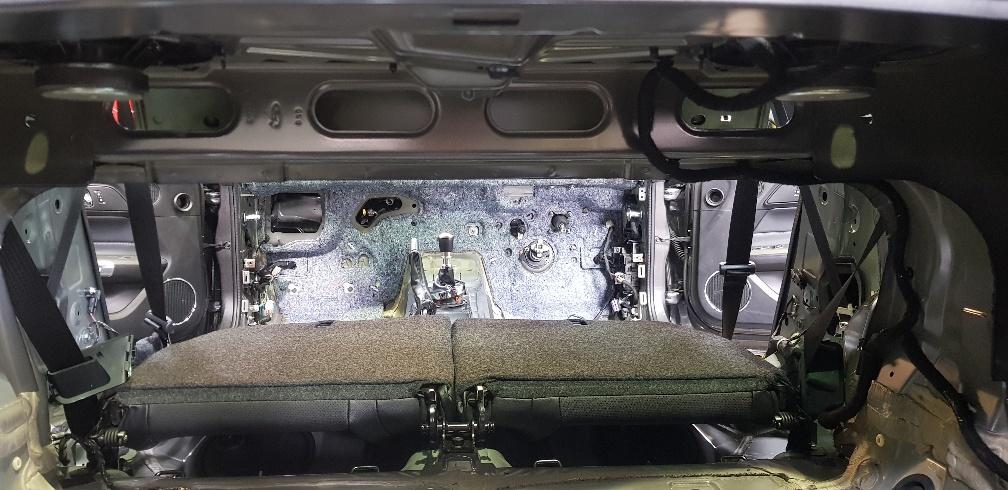

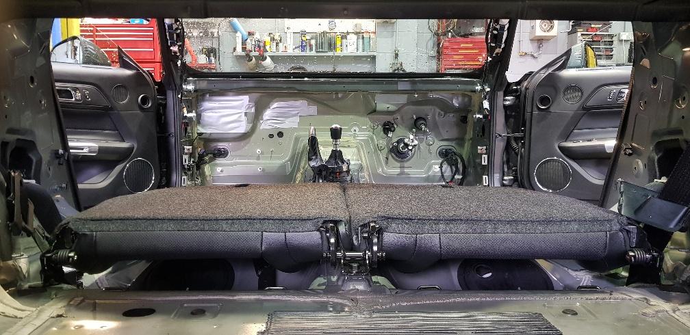

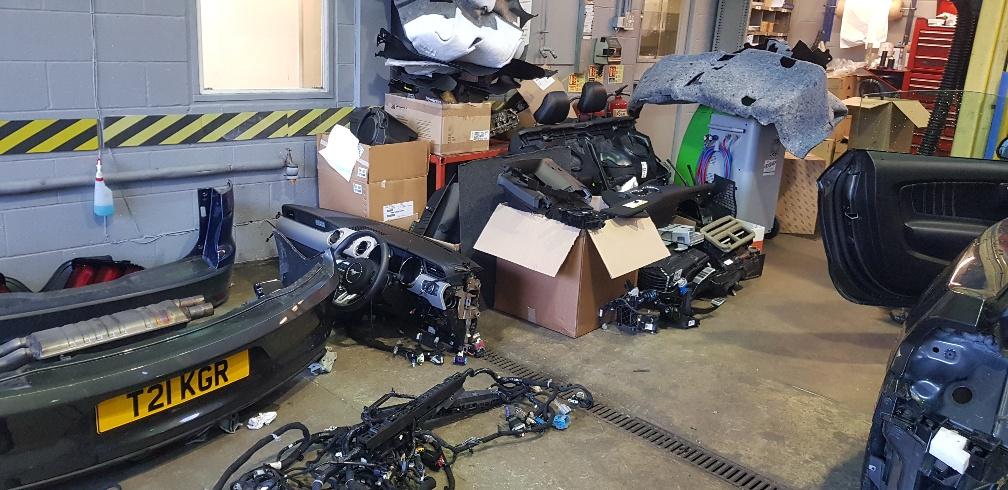

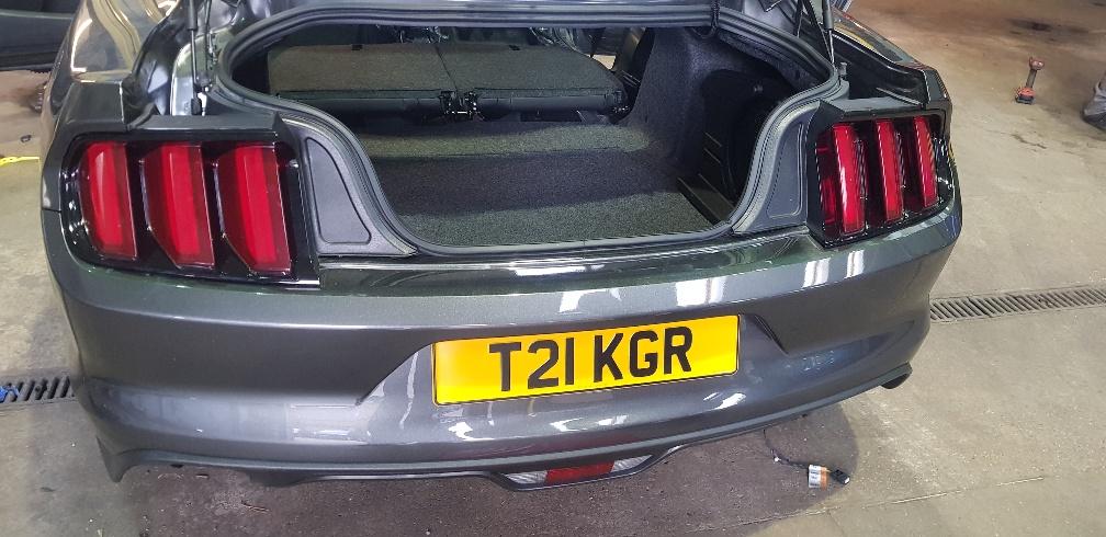

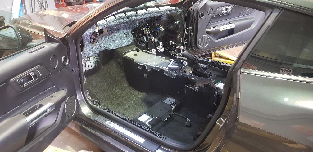

May as well keep this updated with all the photos...starting to become a "how to build an S550 - step by step"...
The technician is flying through it I must say :clap:

Very interesting. I take it that's the clutch assist spring to the left of the clutch. Wonder how many bits will be left over when they're finished :wink:
Free weight reduction!
I do lose sleep over the thought of a less than perfect reassembly tbh. Ford will get an earful on the subject when they call tomorrow with their thoughts on a goodwill gesture.

Corrosion cleaned up;
Having seen a couple of examples of this now, it does appear to be common - young Manders had a look at his. Admittedly his was cleaner than mine is - but the main bar across the back shows a similar situation in terms of corrosion.
Not sure how far along they are with the reassembly but I'm sure I'll be updated today! Eagerly awaiting Ford's answer on my gift of goodwill also (assuming they don't come up with a fresh excuse to delay til next week).
