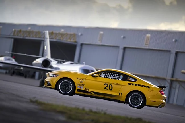

Hey Andrzej, I had sent you back an email late yesterday, for a minimal drop we have our minimal drop springs available
https://www.steeda.com/Steeda-S550-Mustang-Minimum-Drop-Lowering-Springs--Linear-15-17_p_13494.html
if you want all around height adjustment we offer our pro action coilover setup as well, it is used on everything from daily driver street cars to our #20 award winnting T1 race car, these also give you rebound adjustment to dial in the car the way you like best
https://www.steeda.com/Steeda-S550-...table-Rear-Ride-Height-Kit-15-17_p_12594.html
