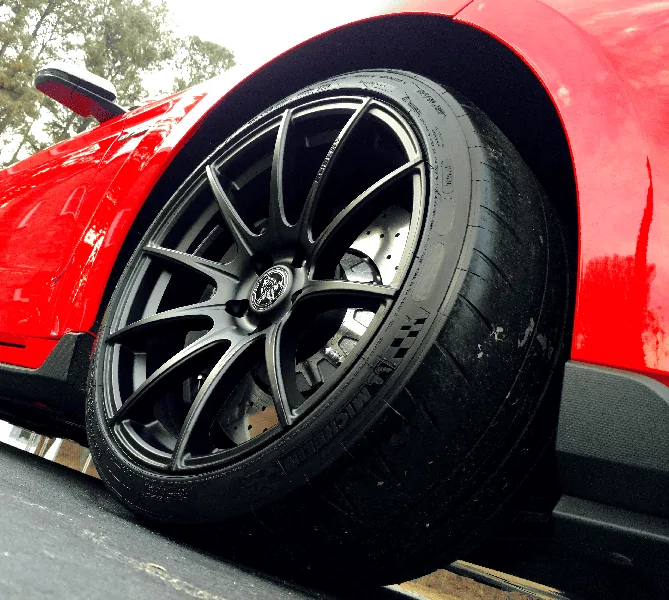

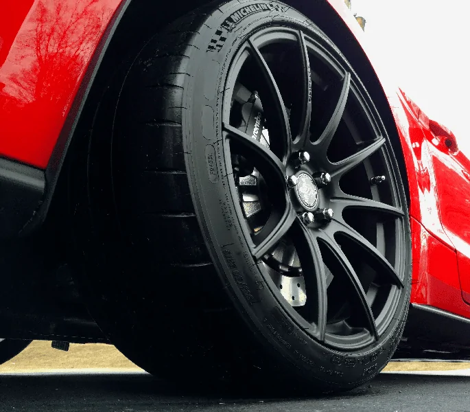

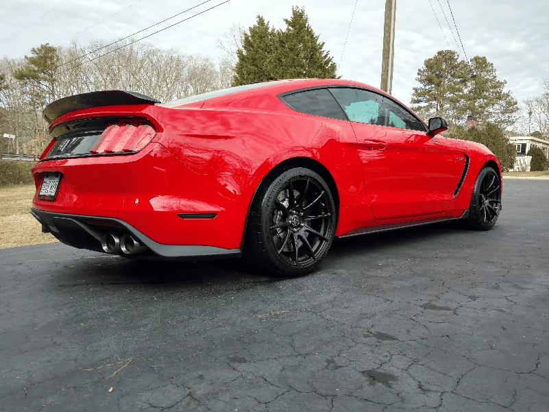

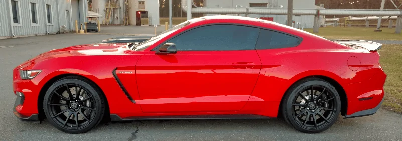

Posted these on a couple of the GT350 Facebook pages... my new Shelby Venom wheels & Michelin Sport Cup 2 tires mounted up & on the car! Hope the pics turn out OK, had to resize them considerably lol
19x11 GT350 specific fitment from Shelby's Cyber Monday sale
+26 offset, 7" backspace up front
+62 offset, 8.44" backspace out back
Michelin 305/30-19 Sport Cup 2 (98Y) all around from the Walmart sale
Ford TPMS39 tire pressure monitors from Tire Rack
Dorman 14x1.5mm acorn style lugnuts
These are basically Weld Racing/Forgestar CF10 wheels with a little additional milling on the wheel faces & the requisite Shelby branding. They weigh in at a hair over 10 lbs lighter for the Venom wheel/SC2 tire combo than the stock wheel/MPSS tire combo. I estimate 6 lbs per wheel & 4 lbs per tire difference. Had to source lugnuts from local AutoZone after finding out the hard way that the factory lugnuts would not fit, despite being told by Shelby on 2 separate occasions that the stock lugnuts would work perfectly :frusty: Still going to order some nicer ones, perhaps in titanium after the holidays. Next up, springs, swaybars & DSC V2 ride controller :headbang:

Very nice!

Surprised to read that the cup Tires are that much lighter...nice
Looking set-up

Looks good. Hate that I missed the "Walmart sale" lol.
The 305 30's give a lot of wheel gap.
