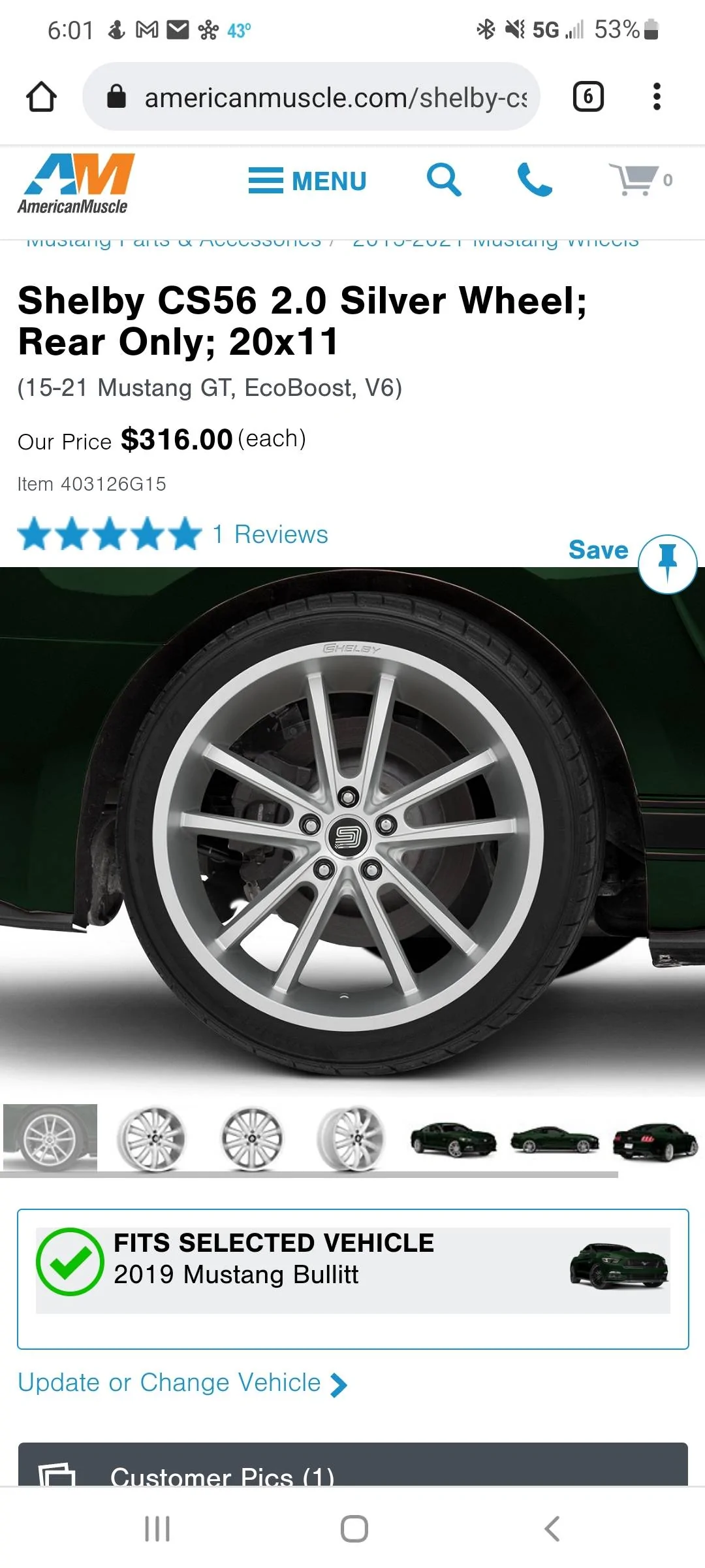

Hey guys so I bought a 2020 Shelby GT350 full loaded Recaro seats.
So I live in Mooresville, NC we get little snow but temperatures do dip below 40. I always have put All-season tires on my mustangs last one was a 2019 Ford Bullitt and I have 20in shelby wheels that were on my 17 Gt and for a bit on the Bullitt. I went to the American muscle site and put the GT350 in for wheels selected the wheels that I own. It comes back that they won't fit my GT350. I have not tried to test fit them yet. Anyone have a clue why it would not fit.???

Likely they will not clear the larger calipers on the GT350.
Rick#7
Jun 28, 2017
401
206
Hudson FL
2015 GT 50 Years Appearance Package

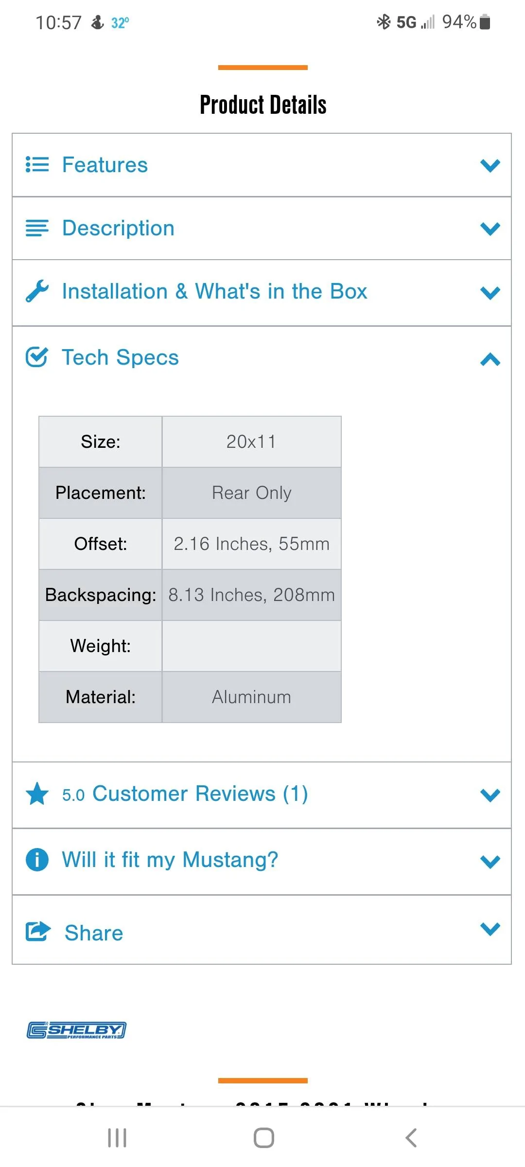

Bingo! I also have 20" Shelby rims on my '15 GT (but mine are Razors), and the web page for them even stated "will not fit with big brake option". The GT350 has even bigger brakes, so even though your rims have the Shelby name on them, if they were engineered to fit a standard Mustang they're not likely to get past the GT350 calipers.
The other issue is offset. You didn't say if you have the same size rims for the front or the 9" version of those, the ones in your post should be fine in the rear but OE GT350 rims have only +24 offset in front, GTs typically use +30 to +35 offset to fit a 10.5" rim, the rim you posted has +55, so even if by some odd chance it does fit over your brakes, you'd still need a spacer to put the tire flush with the GT350 fender.
