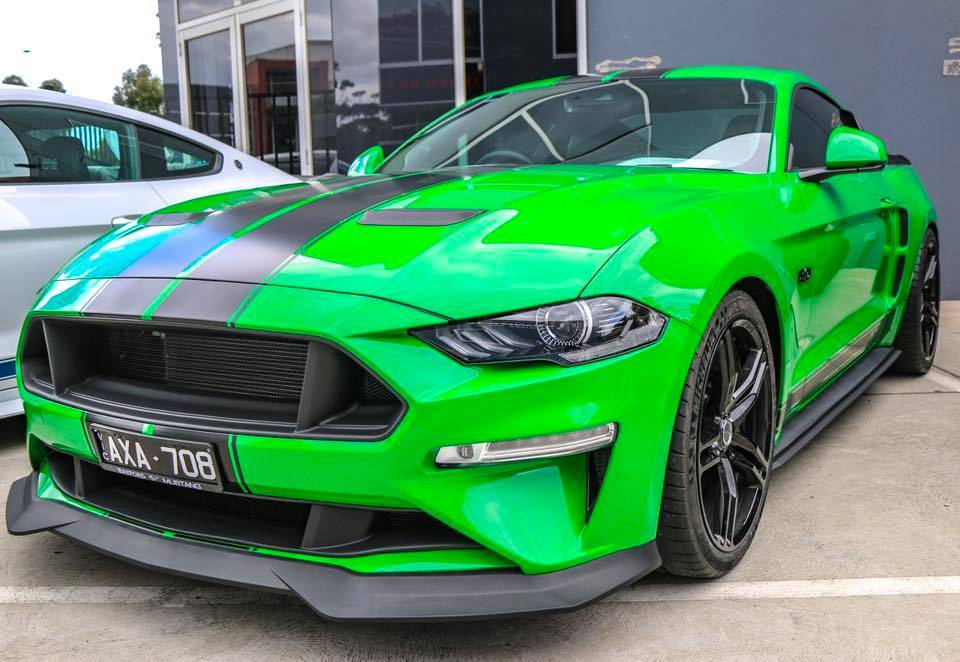

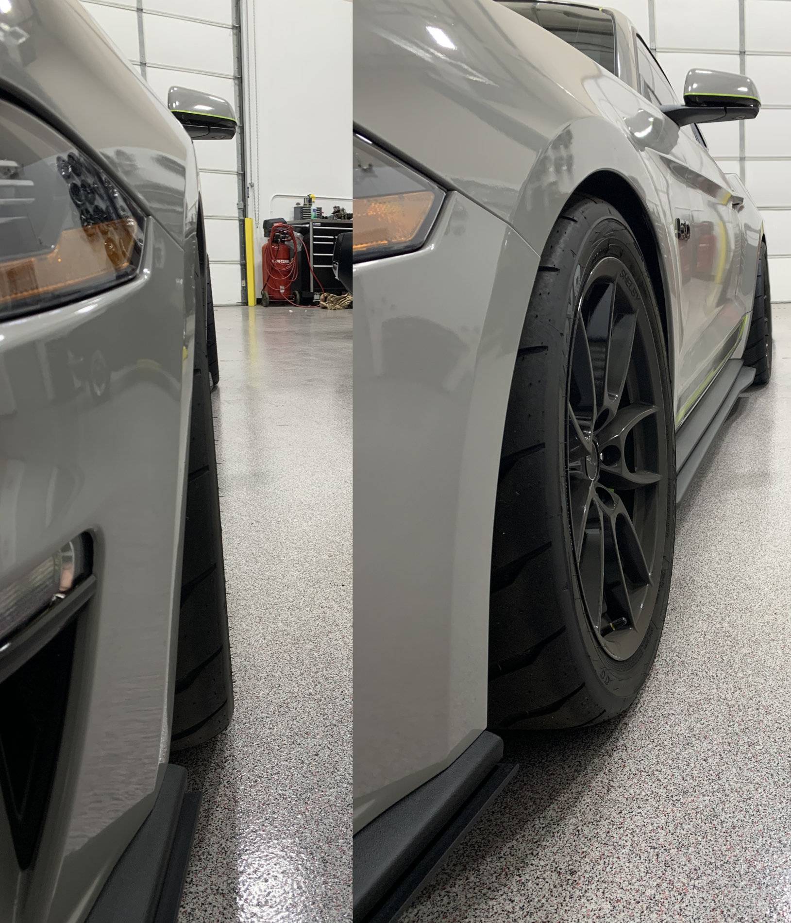

We've run both the CS14 and the CS5 on our R&D car. The +40MM offset does sit inward of the fender by a bit, which was by design as we wanted it to fit without rubbing no matter what ride height your car sits at. The +34 on the CS5 is a bit more aggressive and does sit closer to flush with the fender. We can't really speak to the width of spacer you'd need to make them sit flush as we generally don't advocate their use for safety reasons. We can maybe provide a pic to show you where the CS5 sits in relation to the front fender if that would help!

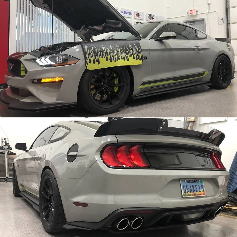

Happy to help! Went out and snapped a few pics of the CS5s currently on the car. The tire combo is a Toyo R888R 285/35ZR19 front and 325/30ZR19 rear. This setup looks a bit more aggressive than the 20" with lower profile tires, but still doesn't feel too "stockish" despite the smaller diameter. The tires are stuffed on there, but still have a lot of clearance.

What did you have to do, if anything to ensure clearance? Did the 285 up front fit without issues
Can you please post more pics. I have a magnetic 19 gt and have been debating on these wheels but have not been able to find any pics on car. Thanks.
