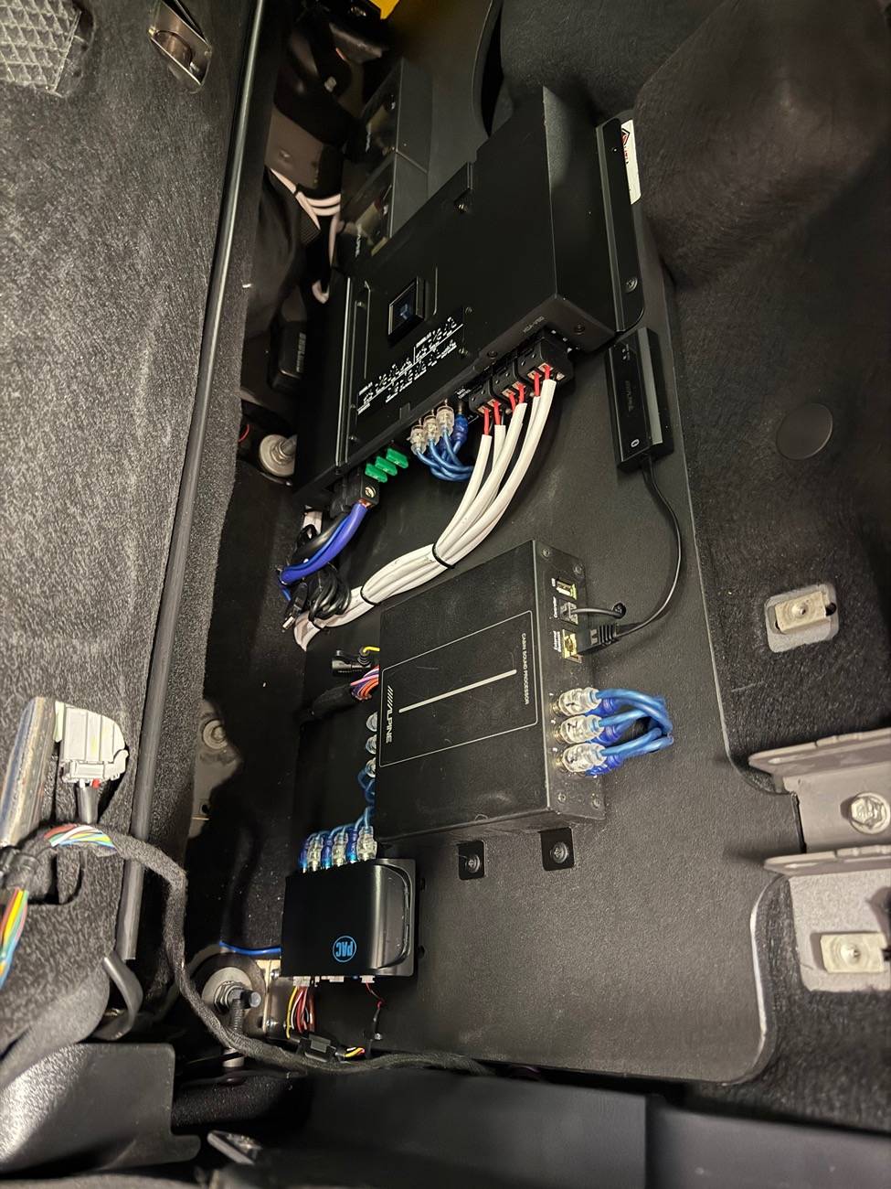

Look in to a pac unit. You can interface an amp setup. Just did this on my 22/450 with b&o. Little tedious to setup but works very well. I used a dsp setup but don’t think it was necessary. Just didn’t want to take it all back apart to add it if it needed it.

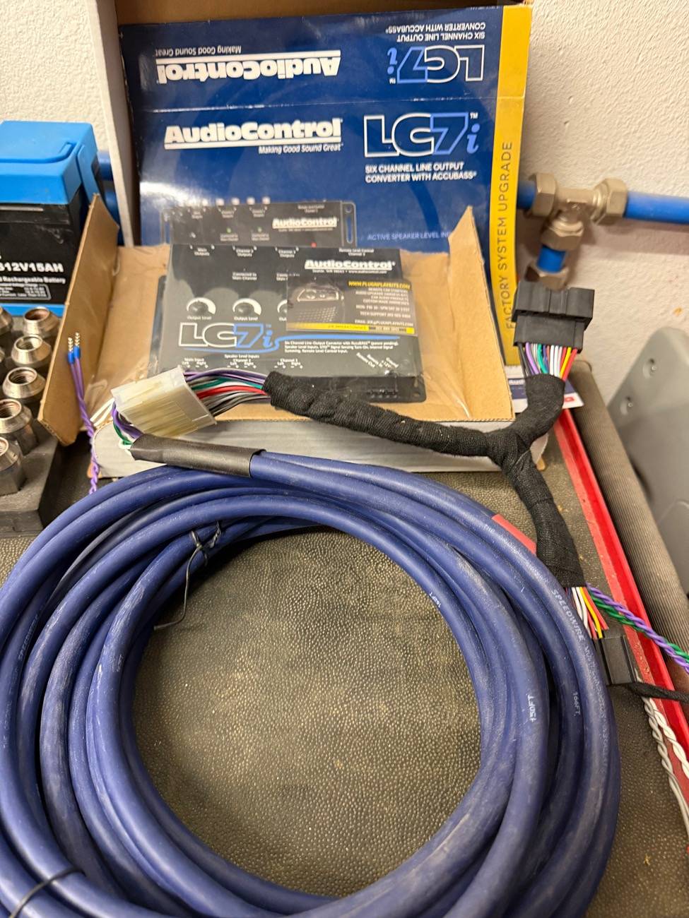

So non b&o, with Sync 3. That correct? Big screen, with navigation basically. If that’s the case there‘s another route you can take then the pac. Here’s a photo of what can be used for that. Basically a harness to line out put. Lets you hook up an amp. If you stay with a 3-way setup in the front, most have adjustments on the x-overs for the mid/tweet, you won’t need a dsp. This harness/setup was for a 17 F250 sync 3/nav, non b&0. Used a few of these in the same trucks, worked well. Only trick is in some case’s you need to get in to forscan to adjust for the factory bass roll off at 3/4 volume.
