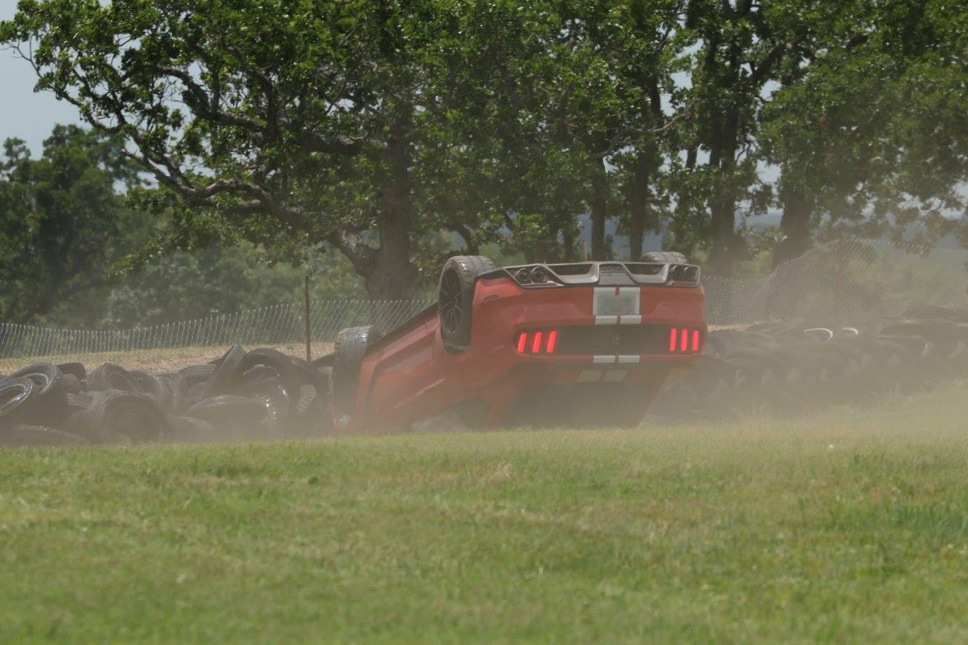

There is risk in life.
It can happen (roof excursion)but it is a personal choice as to what safety equipment you add that goes above and beyond HPDE requirements. A Schroth ASM harness and HANS is a minimum in my book for a car this capable. Vastly greater chance of a frontal impact then a roll over.
No structural issues in this roll over.
