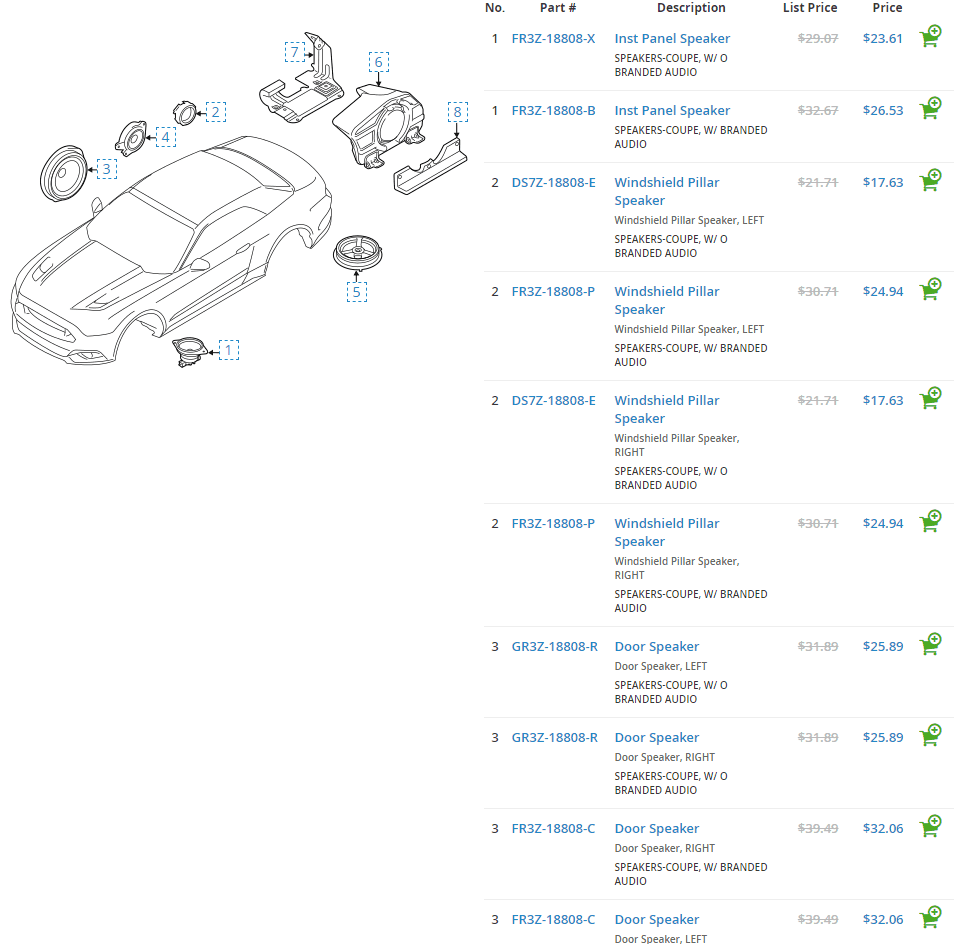

There are different speaker part numbers between the standard and the branded (whatever that is) systems. A-pillar tweeters for example: DS7Z-18808-E vs FR3Z-1808-P. It would be interesting to do an A/B comparison sound quality test between 2 cars with the same music and the same EQ settings. But if you are planning on throwing any money and time at this, I would recommend aftermarket speakers unless you can get your hands on some free drivers from someone who went from branded to aftermarket. Many with the B&O systems were not happy with the sound.
What's really confusing though is there is no difference in part numbers that I could find from 2015 to 2019 even though we had Shaker as an upgraded option and B&O in later models. If the part numbers on Tasca's website are correct, then what makes the B&O any different than the Shaker other than a re-brand? My guess is Shaker added a sub and B&O added upgraded speakers.

The part numbers were confusing me as well between 18 and 19 cars. I own a 19 and looked into adding the B&O Pro stuff, but all the part numbers are still pointing to the 15-18 Shaker stuff.
If anyone has better access to Ford Part #s and can get the real B&O part #s, I'd love it.
