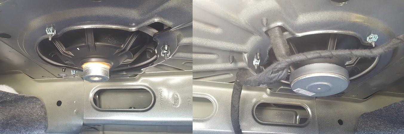

Rumbloki
Dec 13, 2014
27
Austin
1973 Mach 1
Are the left and right rear speakers supposed to be different?
