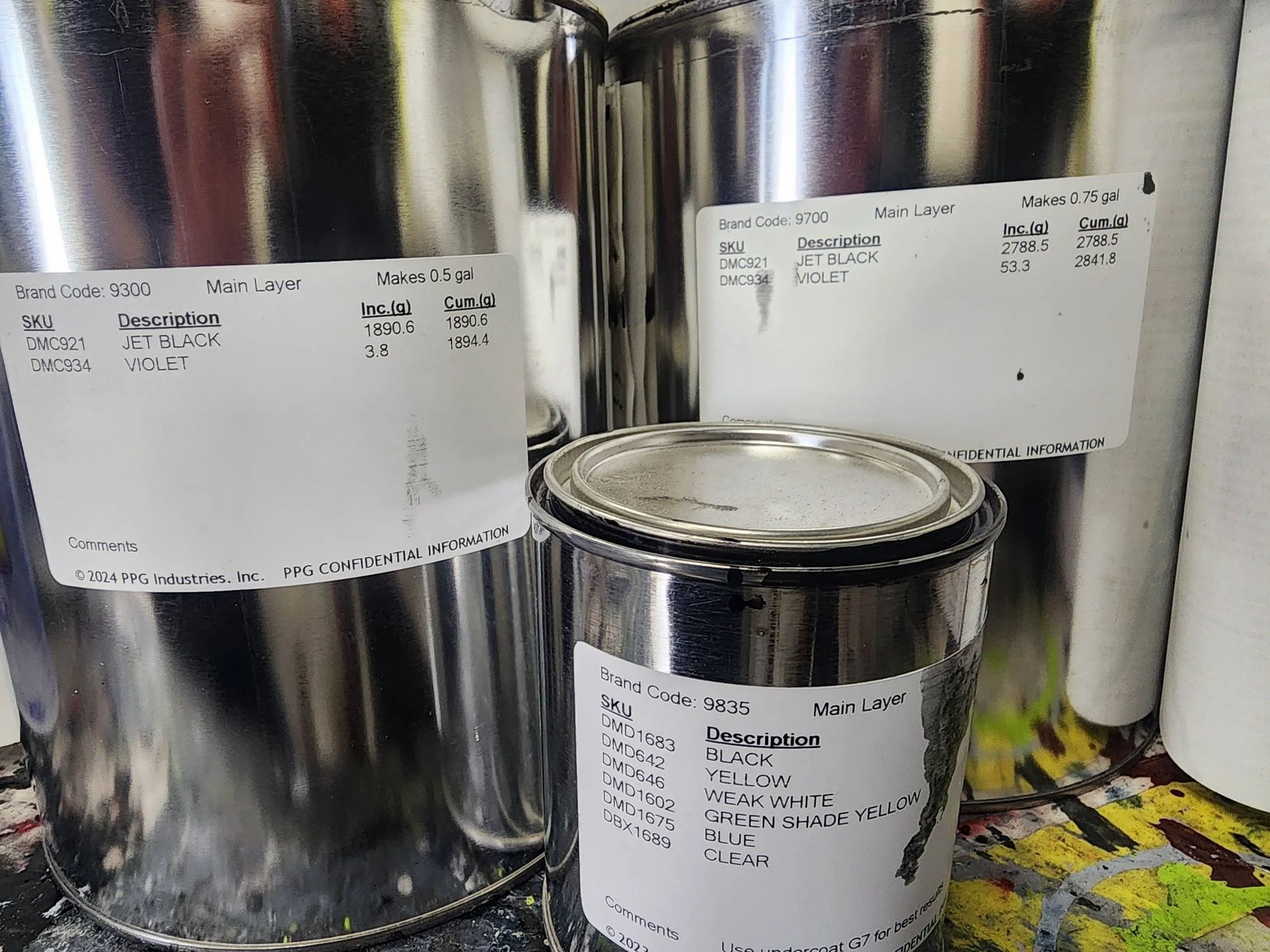

Short answer no. In the sun it is totally noticeable. As previously mentioned 2015 and up shadow black consists of black ,matte base and a touch of blue pearl. Here's a pick of 3 "gloss blacks" none of which are the same and definitely look different from each other in the sun. IF i have time I'll try to do a spray out of each to show to difference.

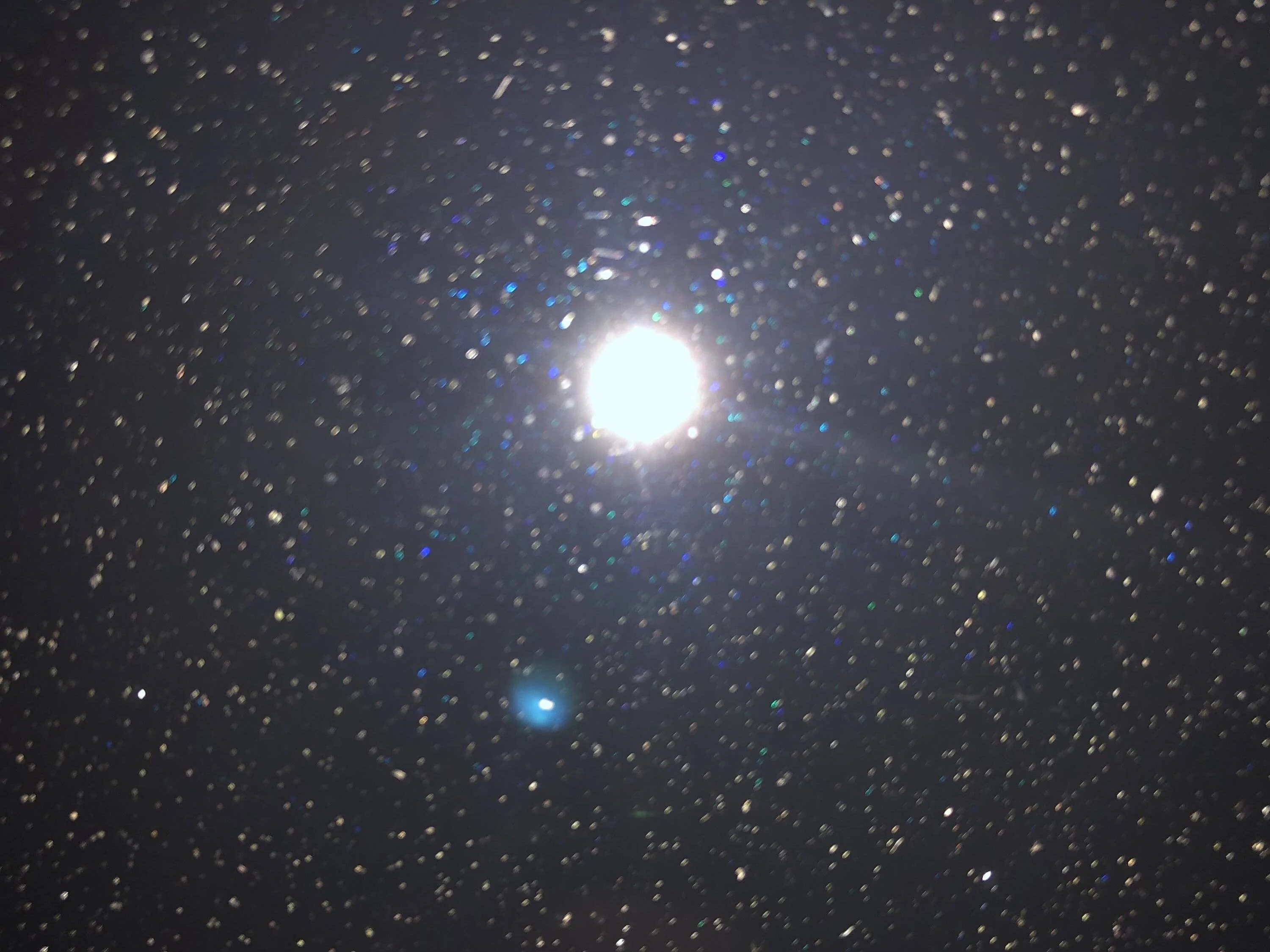

I posted this on another thread :
Off topic but yeah, I will echo that - and I've even read shadow black owers saying there is no flake in it ... lol
I almost bought a slightly damaged 350 spoiler that the owner told me was ebony, yet on the close up of the damage you could see the sparkle.

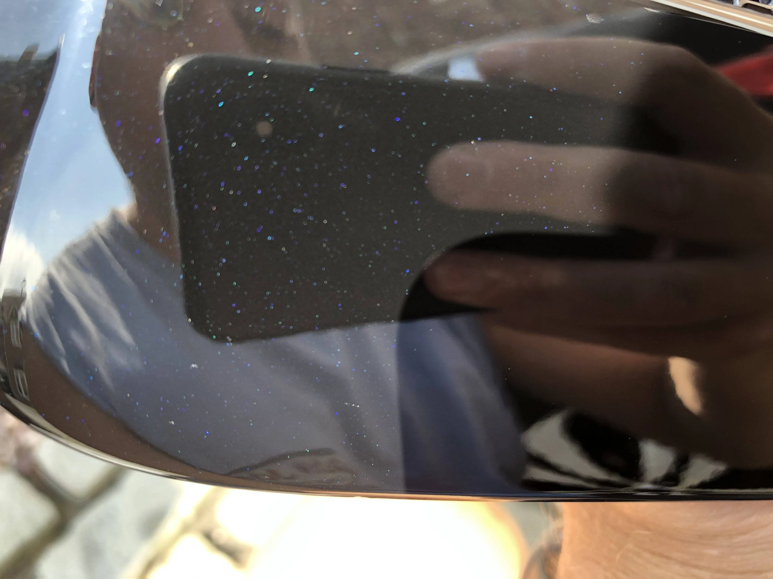

Shadow black :

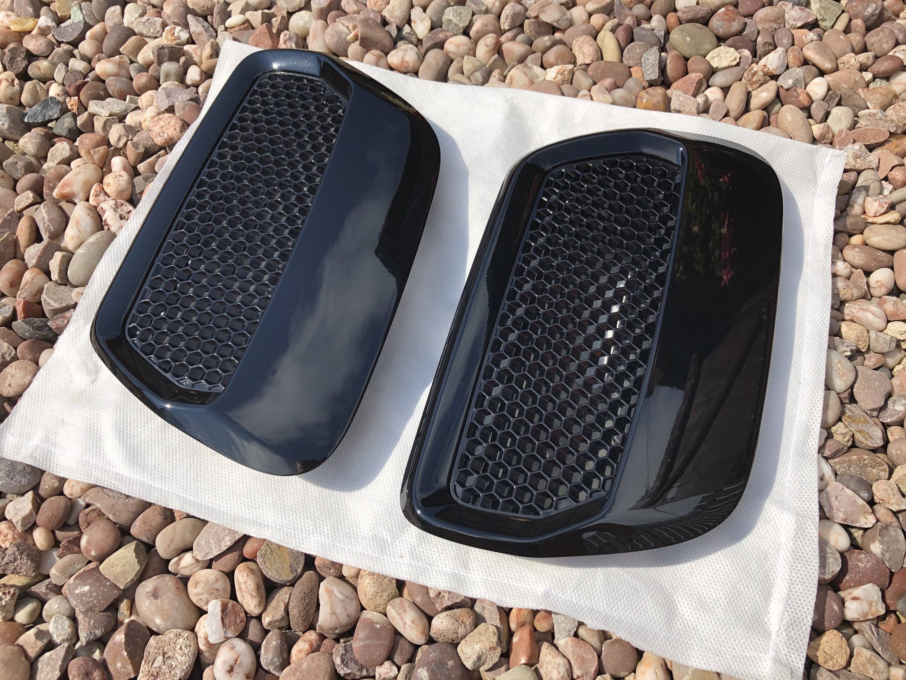

Also shadow black, on the exact same roof and vents ...
It is difficult to capture (in focus) on a phone camera.
I suspect Ford put it in just to add some 'sparkle'. Catch a direct reflection of the sun on a shadow black part (so it's dazzling you) and then move around, the reflection flashes and sparkles - it adds a nice subtle visual effect :like:
