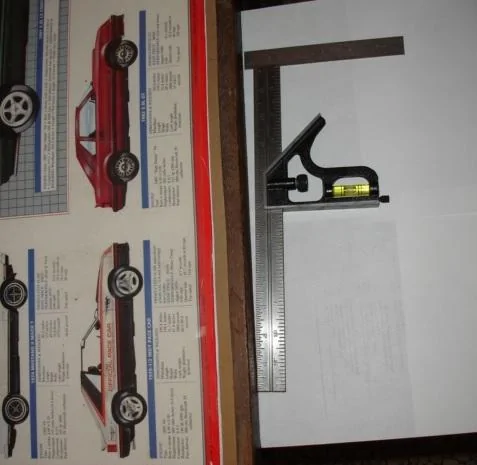

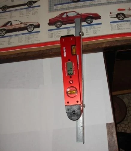

Been doing my own alignments for about 35 years using various ways of measuring camber. Still use parallel strings stretched between jackstands for toe, though. I determine caster from two camber measurements and the 'steer angle' at the wheels.
I'm now using a digital angle finder with the leg extended to suit today's larger wheel diameters.
Way back in the beginning, I used this ↓↓↓ and calculated the angle using trig functions on a calculator.

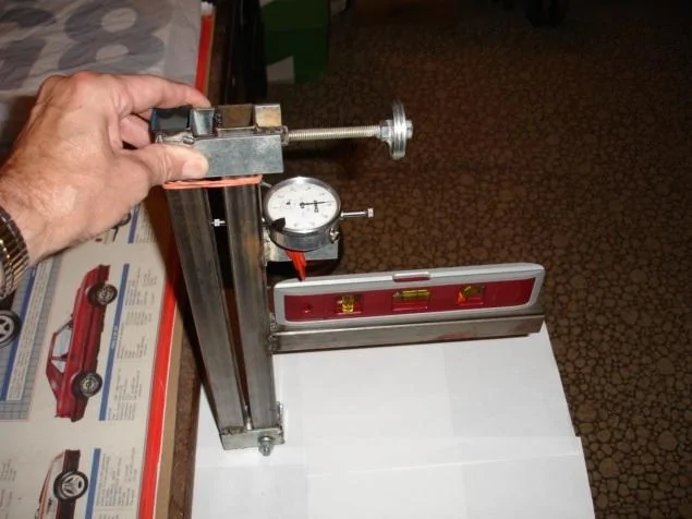

Somewhere along the line I built my own camber gauge. With an .001" dial indicator it can get better than 0.1° resolution, so it beats the digital gauge in that respect, but it is more cumbersome to use. Picking a convenient length between the pivot and the dial indicator means I multiply the dial reading by 5 to get camber in degrees.
I've never had any bad results using any of these measurement methods as long as I take my time and double-check everything at least twice. Caster measurement isn't as good as camber or toe, but it seems to have been close enough.
