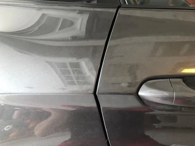

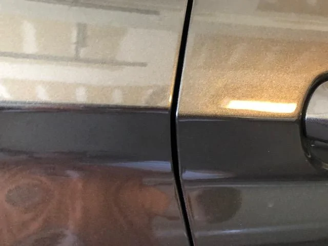

My passenger door came misaligned from the factory - the character line didn't line up, didn't notice it right away, but once I did it bugged the hell out of me. After searching for how to align it with no luck, I was resigned to taking it to the dealer. But then Cobra Jet posted a pdf from the service manual (https://www.mustang6g.com/forums/attachments/door-alignment-pdf.373955/), so I gave it a shot today. Wasn't easy, as the bolts were very hard to get to, and I was working by myself so I had to use a jack to hold the door in the position I needed while re-tightening the bolts. Luckily I pulled it off and it looks good. Before and after shots below.

Nice job! I work in the body shop at Ford so I've always been critical of body fits, and panel imperfections. That..would have driven me nuts!!

Yea, you'd think something that obvious wouldn't have made it past quality control. It's not like a mild panel gap that could be hard to see. It's the character line on the side of the car! Why even have a character line if you can't line it up properly?

I couldn't tell you how stuff like that gets out. I know it's not supposed to. At our plant we sometimes run into issues if the normal operators aren't there. If a replacement has to be trained (rare on a job like this) the first few that he does by himself can turn out like this. But.. It should've been caught by one of the final inspectors. It's an embarrassment to employees like me. The vast majority of us actually care how our product looks and performs. Had that been caught out in the lot somebody would've been wrote up, or worse.

Nice fix. I’m going to intentionally NOT check mine now.. lol. That would send my OCD into overdrive.

The picture may not look too bad, but mine was very obvious. I got tired of people saying "nice car ... hey your door isn't lined up.”

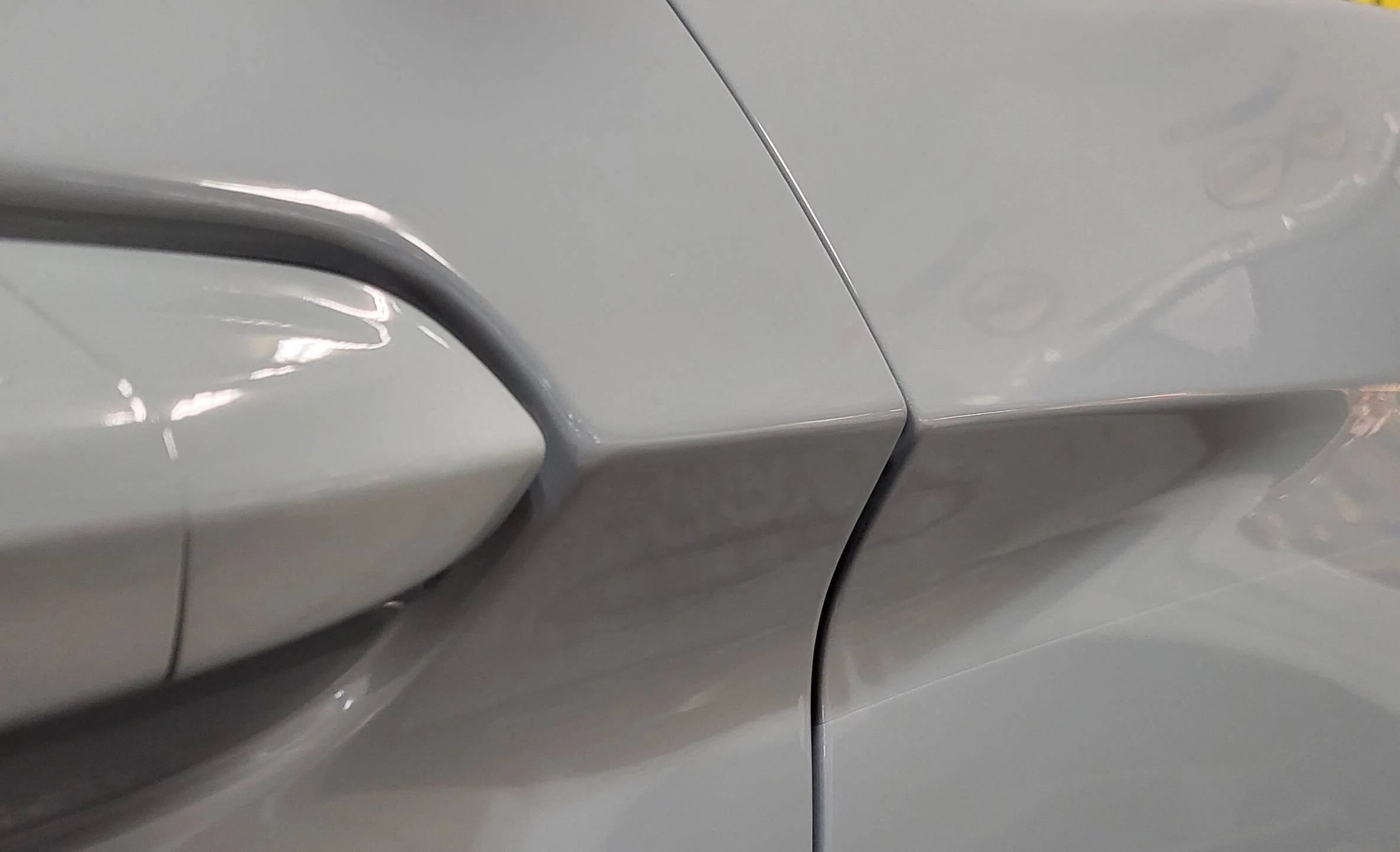

Great job! Entirely worth it, the results are just right. I am fortunate that my doors fit right on the back ends, but I need to pay some attention to the front ends and the fenders. Also the hood seems to sit a little lower in the rear than in the front. Most folks won't notice, but I can't stop seeing it.

3 years later and the same stuff.
I saved the pdf. Thanks!
I think I'll let the dealer handle it at first oil change.
Same scenario, didn't notice it at first, but...
Only difference is mine is on the drivers side.

Mine is lined up but the door just looks like it's open 1/16 or a 1/8, can I just move the stricker in a bit to suck the door in?

Nice job ! It's always pleasant to see someone tackling a peeve with cautious patience and making it work out just right ! Thumbs 👍
