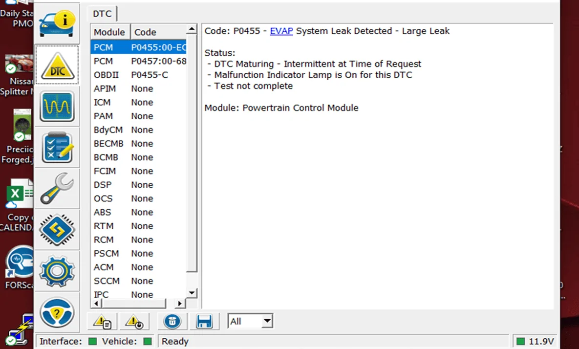

Thanks. Yes, that is correct. Actually i used Forscan and cleared up the code P0455 but it came up again. Reading around found some key points of failure (Hose, Gas Flap, Sensor).
I already made a appointment in the Dealer to see if it can be repaired by the Emission Warranty 5 years or at least get the estimate of what specifically is the problem. Let's see before i go further.
