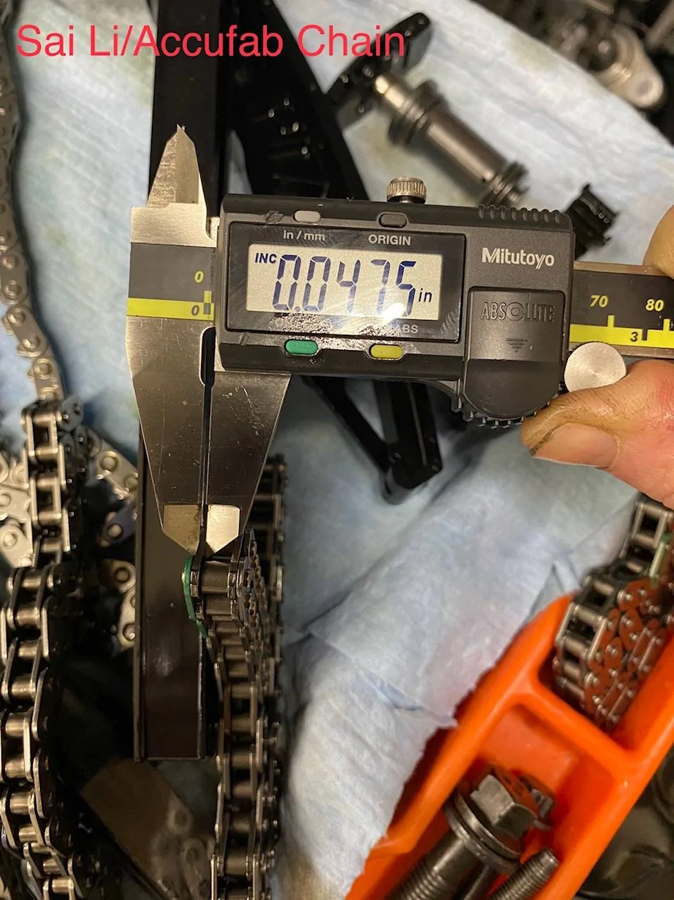

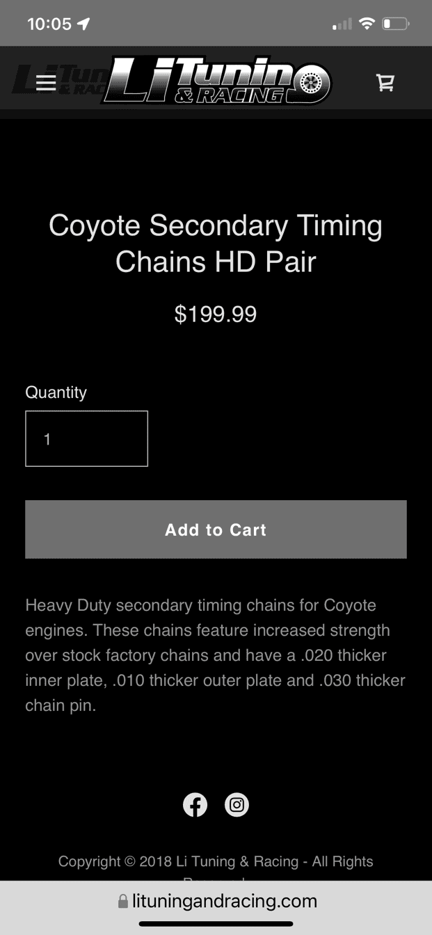

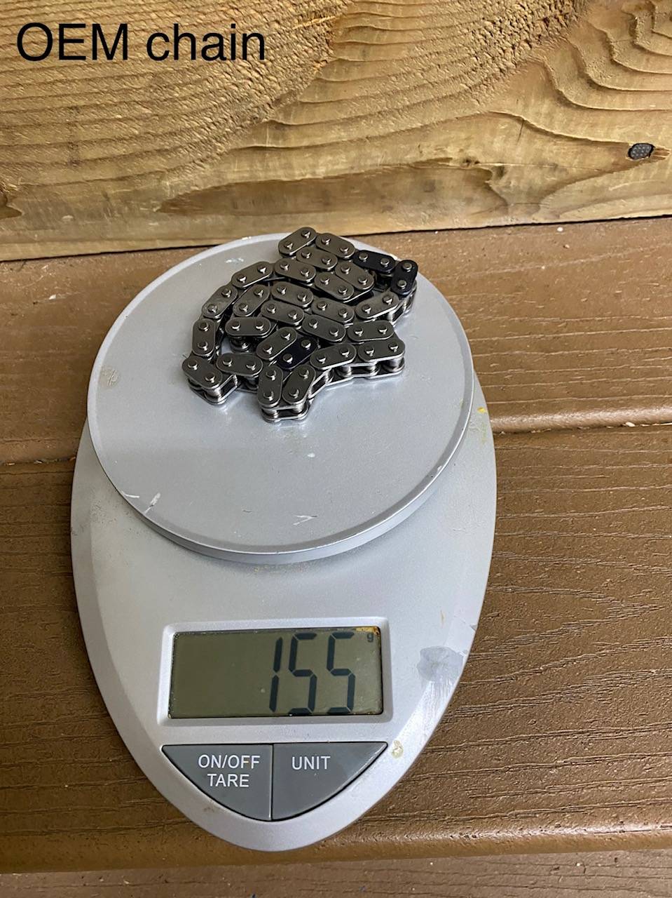

While installing my OPG/CSS I decided to do a few extra upgrades. Boss tensioners, MMR tensioner bracket, GT350 primary chains and upgraded secondary chains were on the list. Having previously dropped a secondary chain on an 03 Terminator, I tend to worry a bit about them. When I started looking around, it seemed like Sai Li had a good option with their "Coyote Secondary Timing Chains HD Pair" and they were in stock with only a 2-3 day ship time so I placed the order.

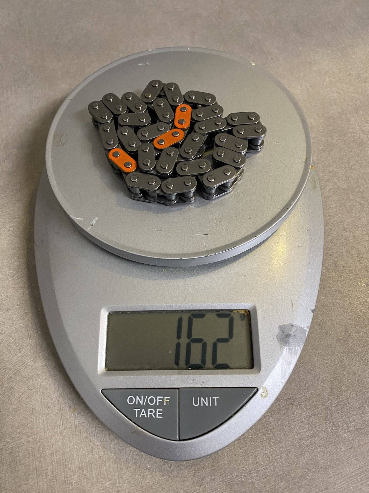

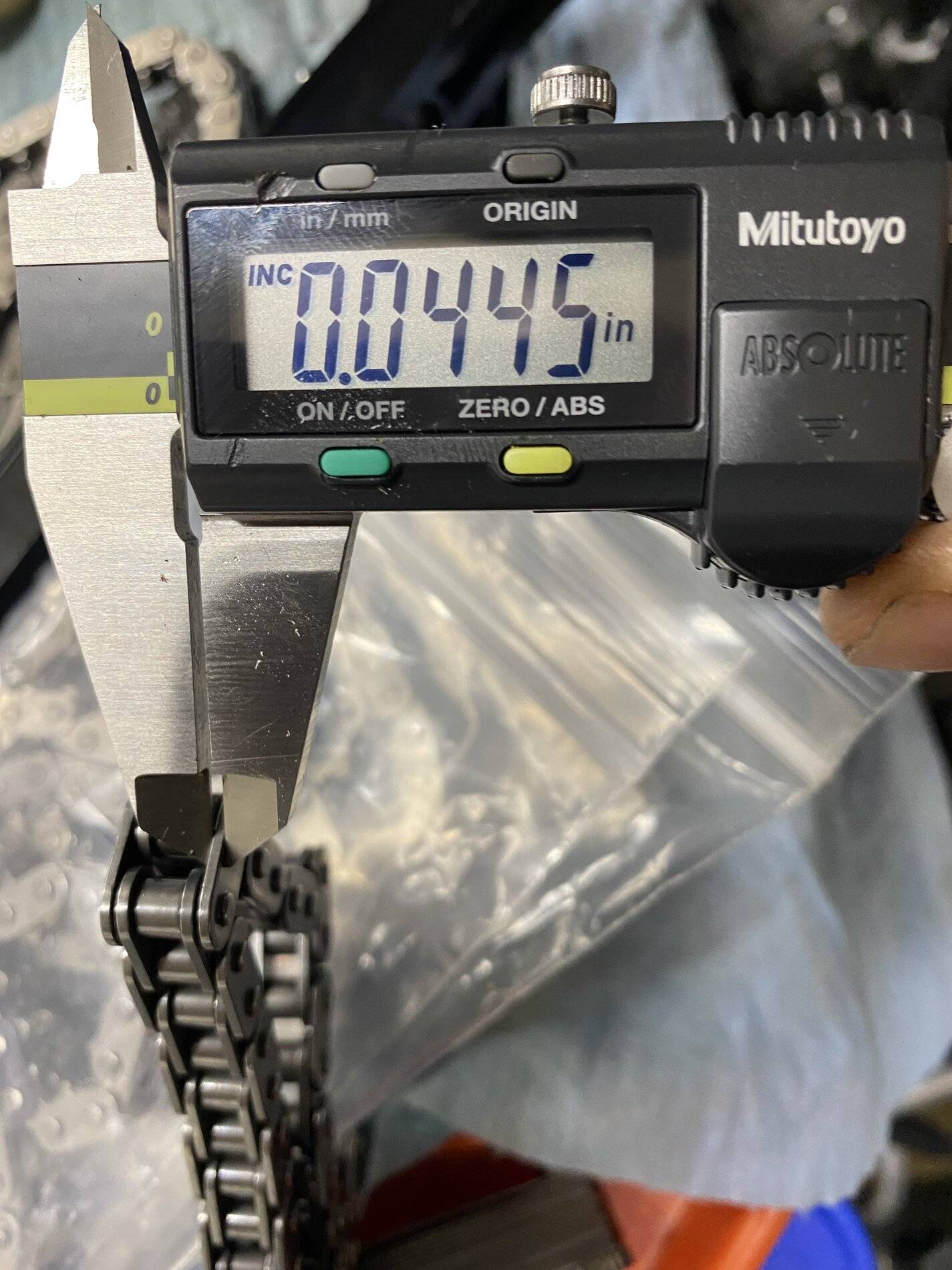

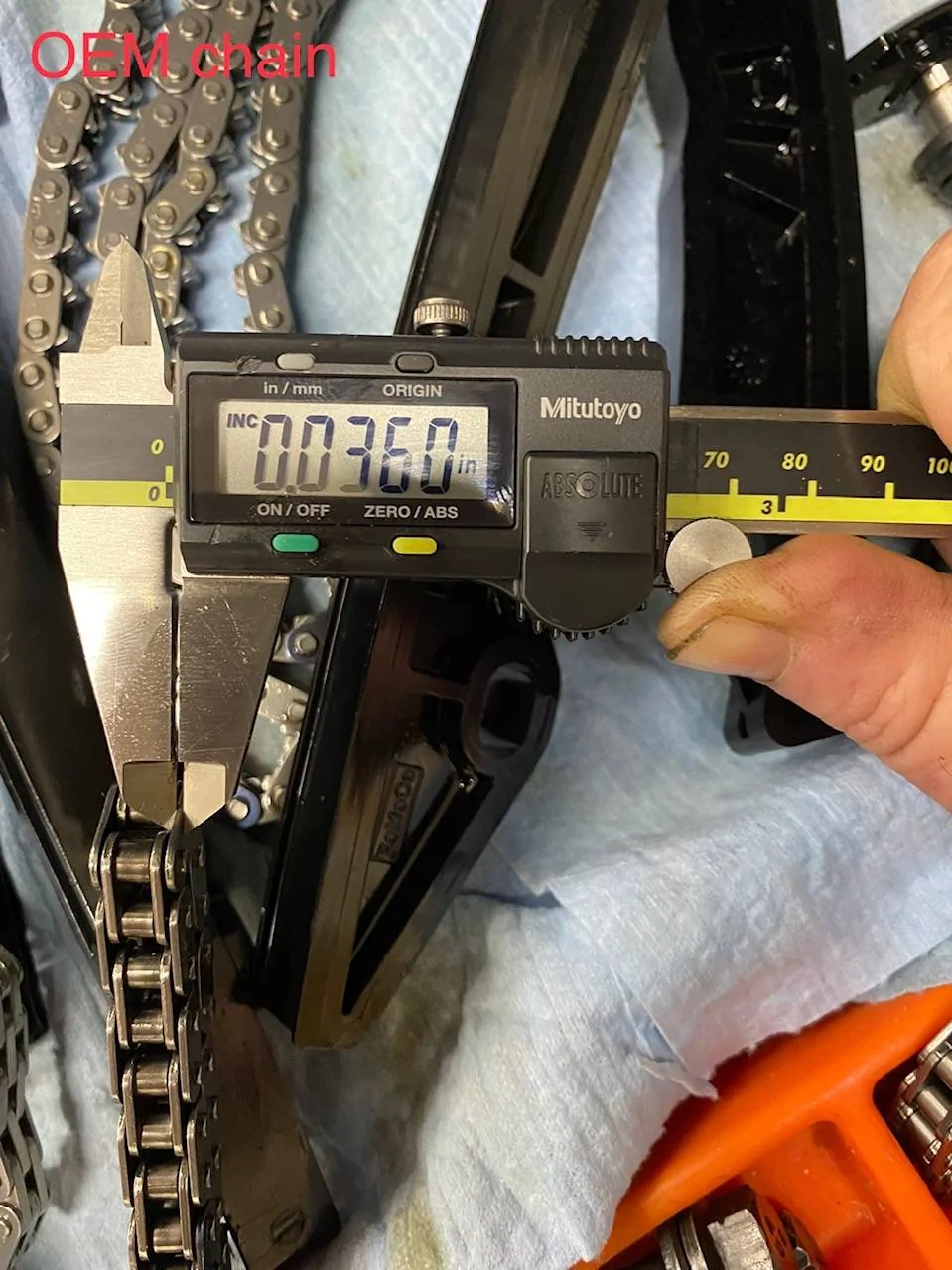

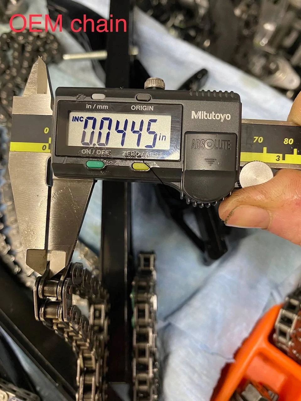

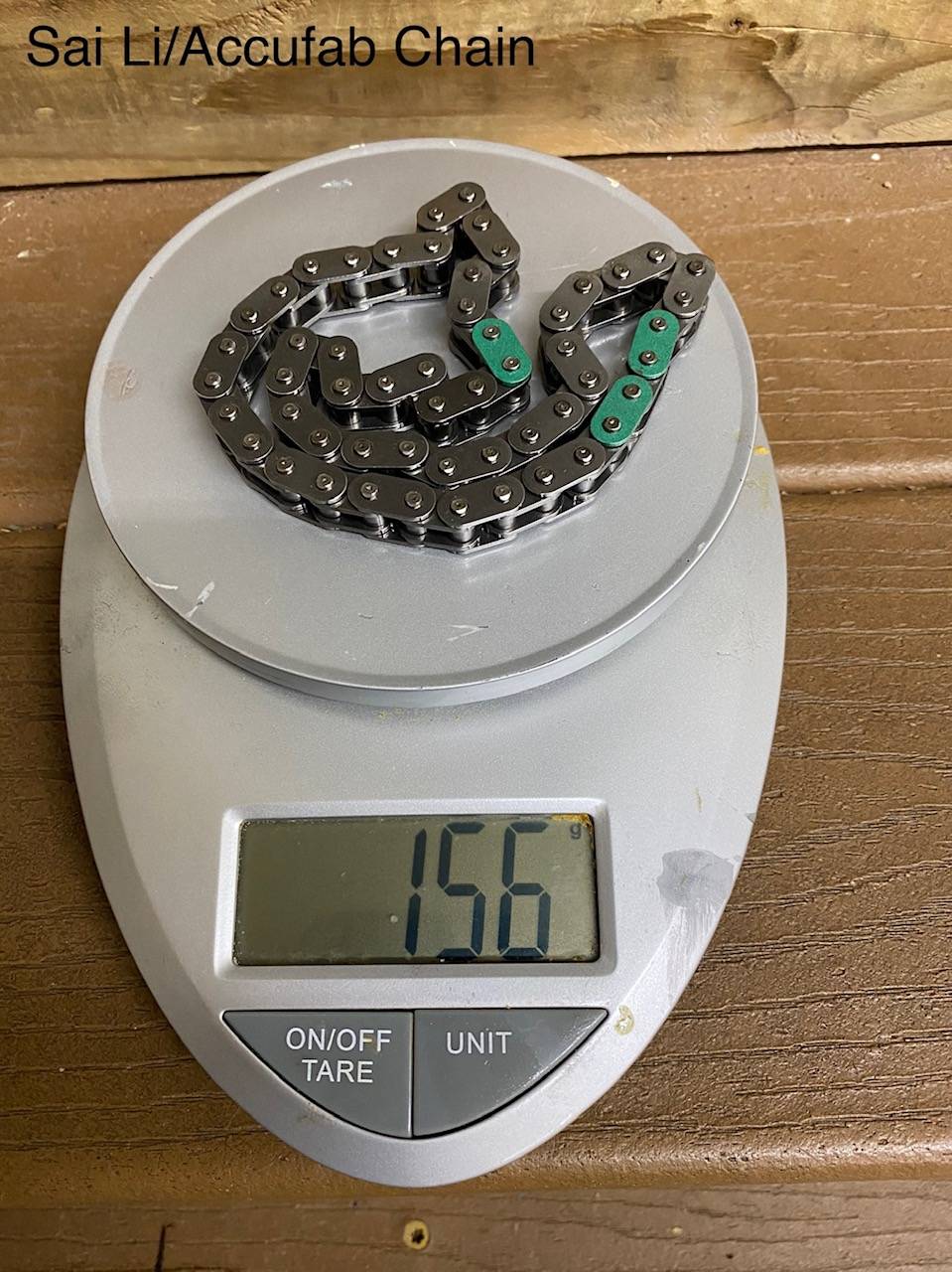

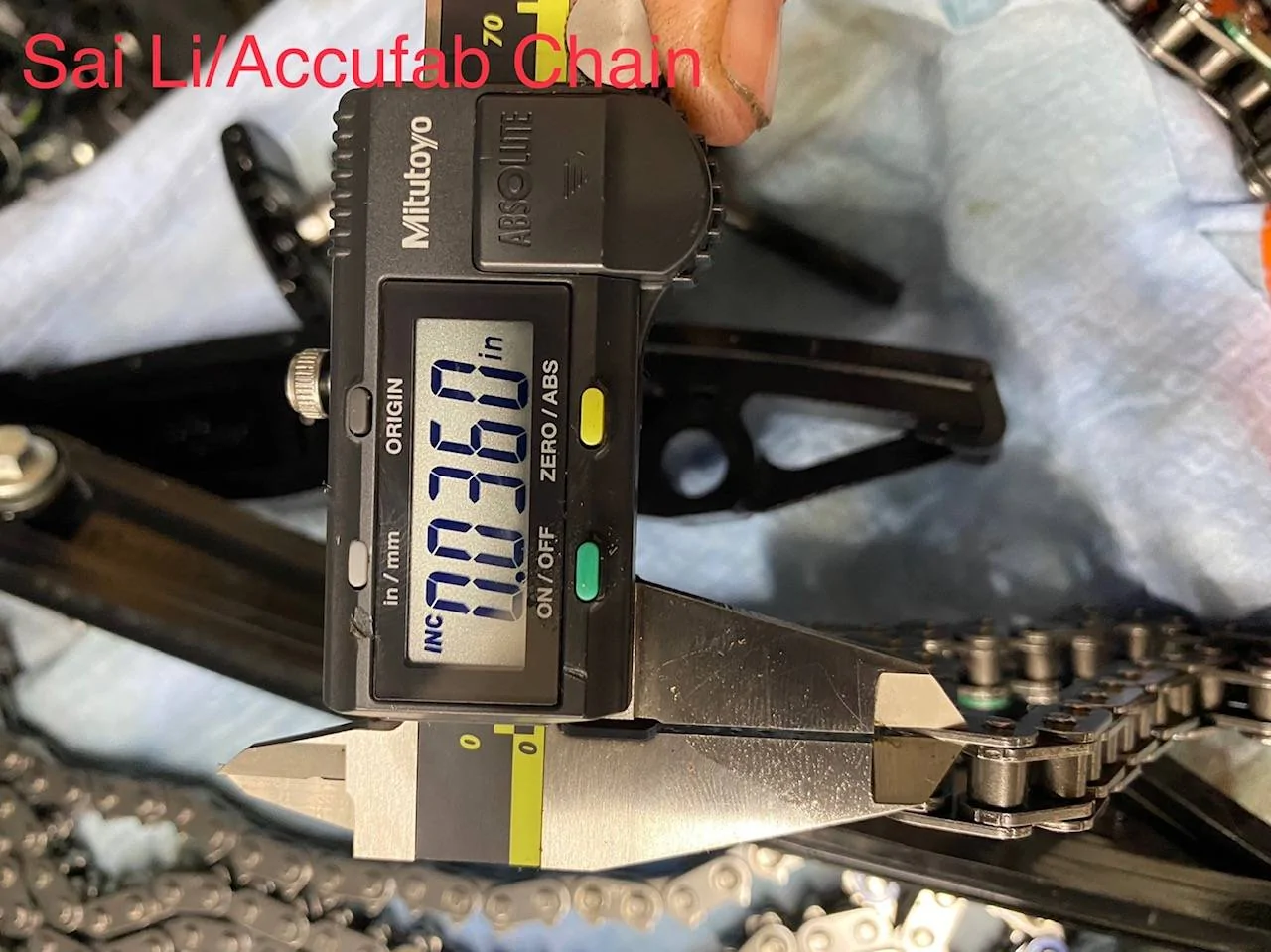

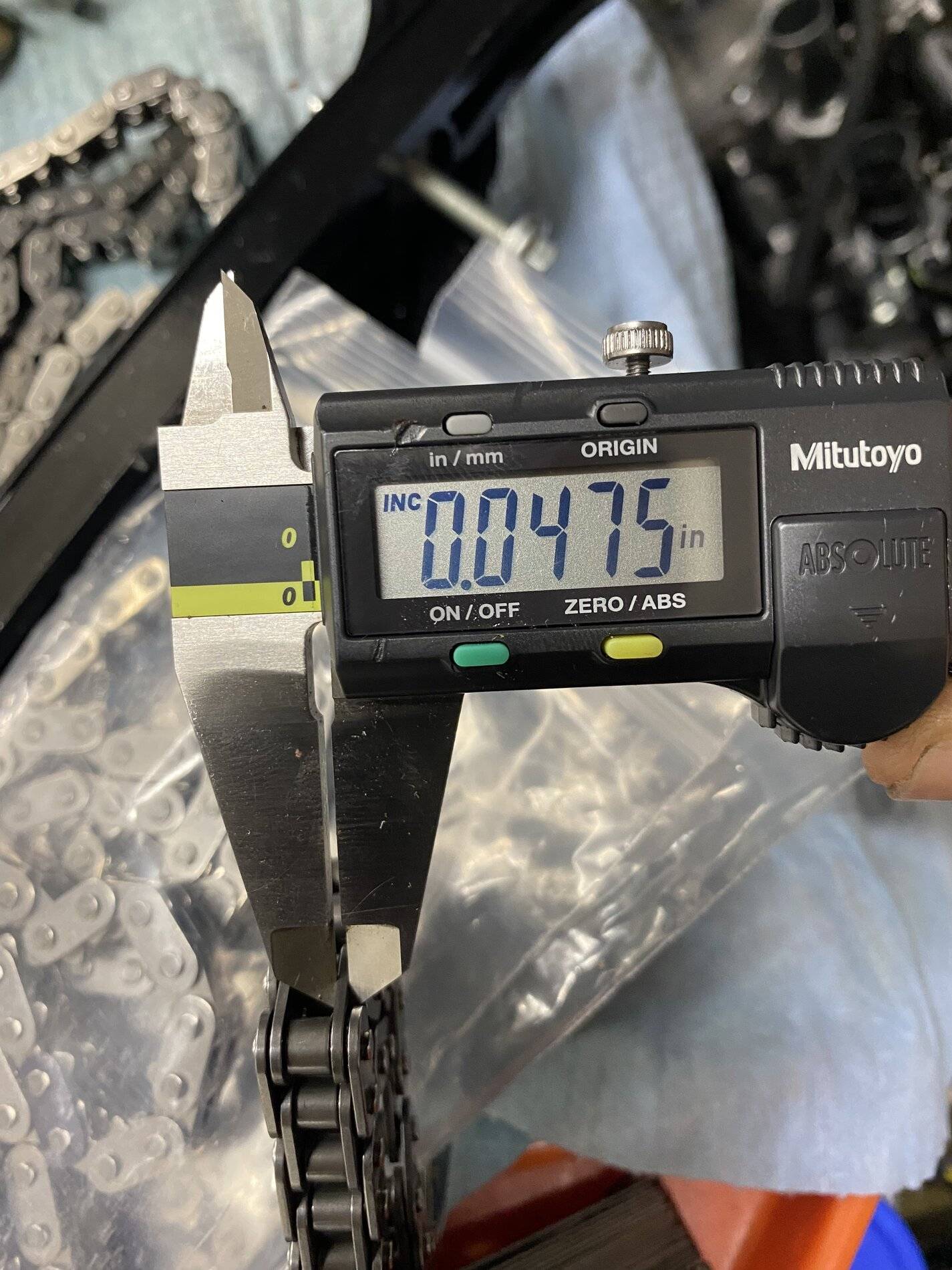

Upon opening the package they really didn't appear to be much, if at all, different from the chains I had removed so I pulled out the scale and caliper and this is what I found

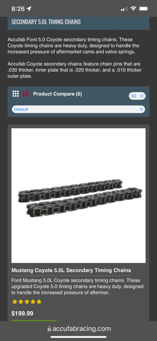

As you can see, what I received was hardly heavy duty as compared to OEM, and hardly lived up to the claims. I was unable to accurately measure the pin size without destroying both chains, but from what I could tell there was little or no difference, certainly not .030. Because I wanted to give him an opportunity to explain, I reached out to Sai Li to discuss my findings. I was told that Sai would return my call, but that never happened. With my project now on hold I decided that I trusted Accufab to provide me with the chains as they have been around almost 30 years and I have done business off and on with them for almost that long. Considering it was Friday and I was already held up by the Sai Li chains, I elected to spend the additional $75 to have them here on Saturday.
Accufab clearly does not show the green links in their ad, but to my surprise, when I opened the box, I had another set of the exact same "green chains". I did open one of the chains to confirm that weight and measurements were identical. Prior to reaching out again to either company I wanted to do a little further research. I reached out to my Ford parts specialist and confirmed that the part number are and have always been the exact same for 2011-2020 Coyote secondary timing chains just in case Ford actually upgraded the chains at some point and the measurements advertised were in reference to an older chain.

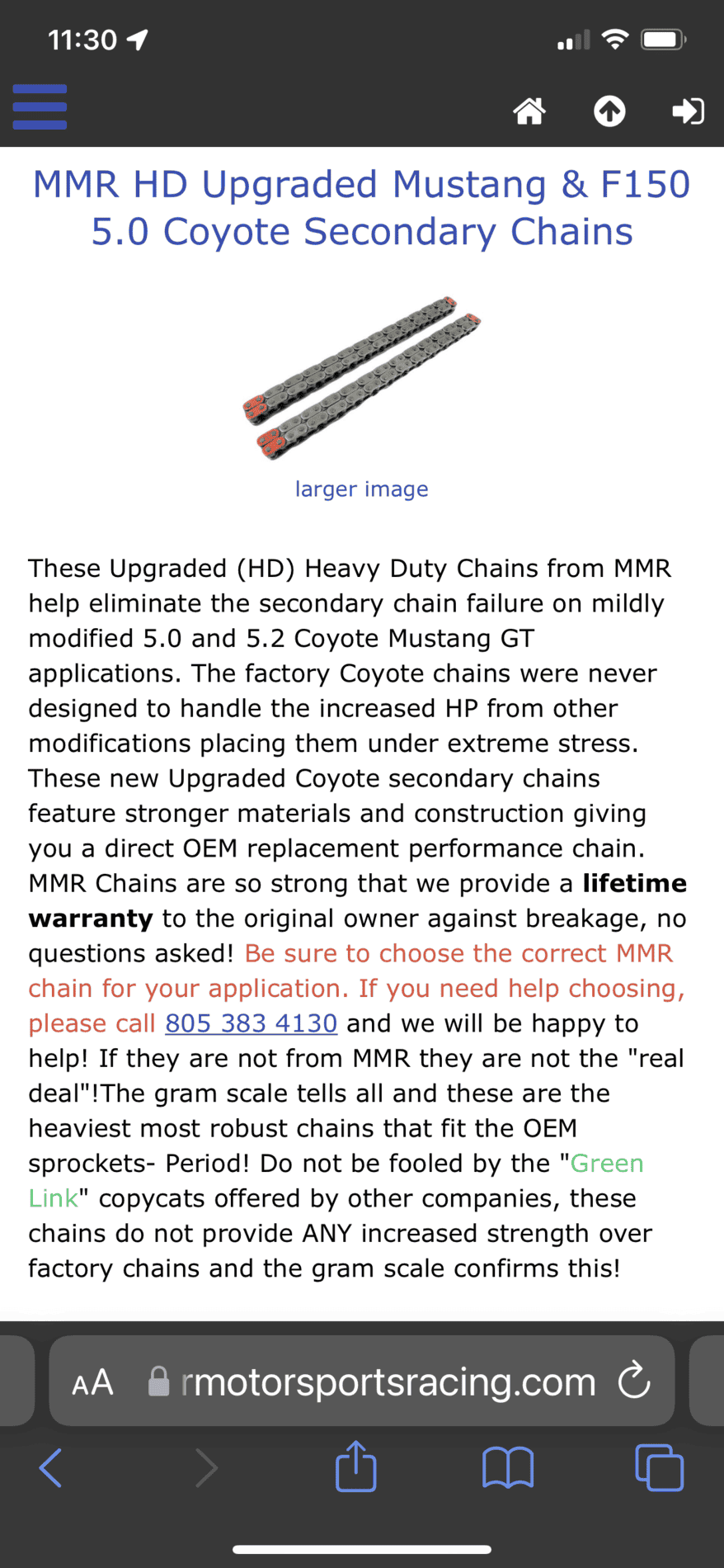

It doesn't seem that either of them wanted the opportunity to defend their overpriced (non)heavy duty chains. At this point I have ordered MMR chains and will update this with those specs when I receive them tomorrow. I found it interesting that MMR references the "green chains" as copycats that are no stronger than stock.

lol 1 gram extra of material in a whole chain compared to the OEM one? Pretty sad.

MMR for the win! In all honesty, I would have ordered the MMR instead of the Accufab last week, but they were closed for inventory. I got the MMR chains, an MMR T-shirt and overnight shipping for less than the pre-shipped price of the “green chains”.

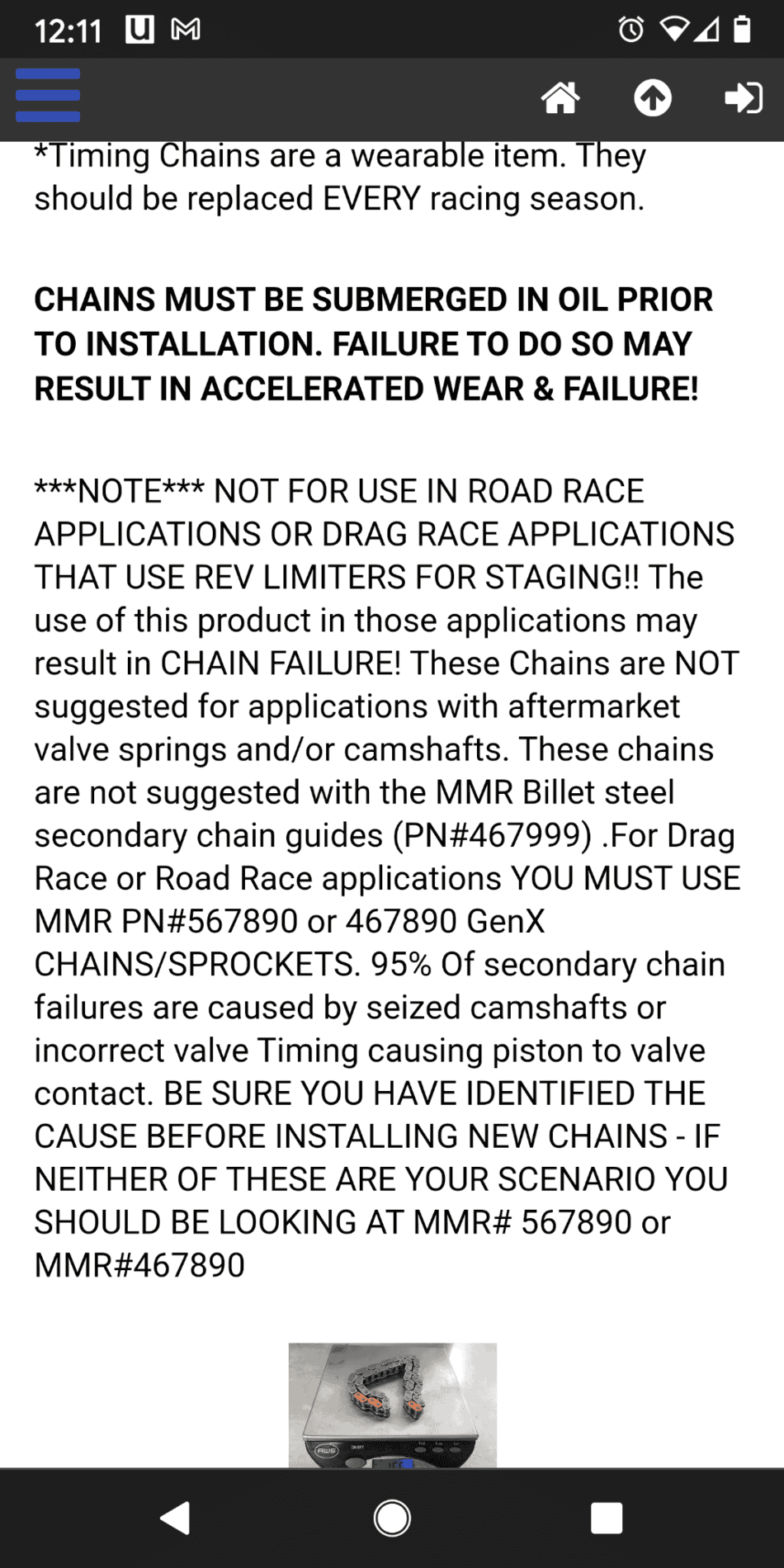

I came to the same conclusion you posted above last year. Apparently it is known, but not necessarily on this forum. But dont forget MMR's disclaimer about the red link chains. MMR says these chain are not recommended for use with aftermarket cams or springs. If you run stock components, you should gave just ran stock chains...

Yeah, I read the disclaimer. I figured that’s more of a CYA for them than anything. I honestly think the Coyote secondary chain failure rate may be a bit overplayed and over the weekend I had convinced myself to stick with stock, but when it came down to it I still had this overwhelming desire to put the timing components back stronger than I found them. I doubt I’ll ever run upgraded cams, but springs might be in my future.
Collecting parts for a build I was getting ready to buy chains. I had heard MMR was the ones that were actually bigger. However, the disclaimer kind of confused me. If I were to get different springs and valves, and turn higher RPMs I shouldn't use these chains. But the other two options are nearly the same size as stock, then should I run stock?

I think that’s a CYA. They want you to move up to their phaser delete option with billet guides for cams. I can’t blame them. They’ve been blamed for a lot of failures over the years, some maybe justified, many probably not. You’d probably be fine with stock, but the MMR is clearly a stronger option without going all out.

Correction, it is clear that the MMR chain is heavier and slightly thicker. But that does not prove that it is stronger....

I understand CYA's. But would you buy Pistons that are marked not for racing, pants that say not for wearing or shoes that say not for running?

Valid point, which is why I gave both retailers the opportunity to explain why their chain was stronger despite clearly not meeting the advertised improvements (or really any visible improvements at all). Neither had any desire to do so. I will say that my secondary chain failure was a result of an outer link failing, so the substantially thicker outer link on the MMR definitely helps me sleep better at night.

Without testing data, one will just have to assume the thicker and heavier chain is stronger. Who knows, testing could reveal that the OEM chain is superior. Example with motorcycle chains, a 520 aftermarket chain is dimensionally smaller, lighter and with a higher tensile strength than an OEM 525 chain. Food for thought.
