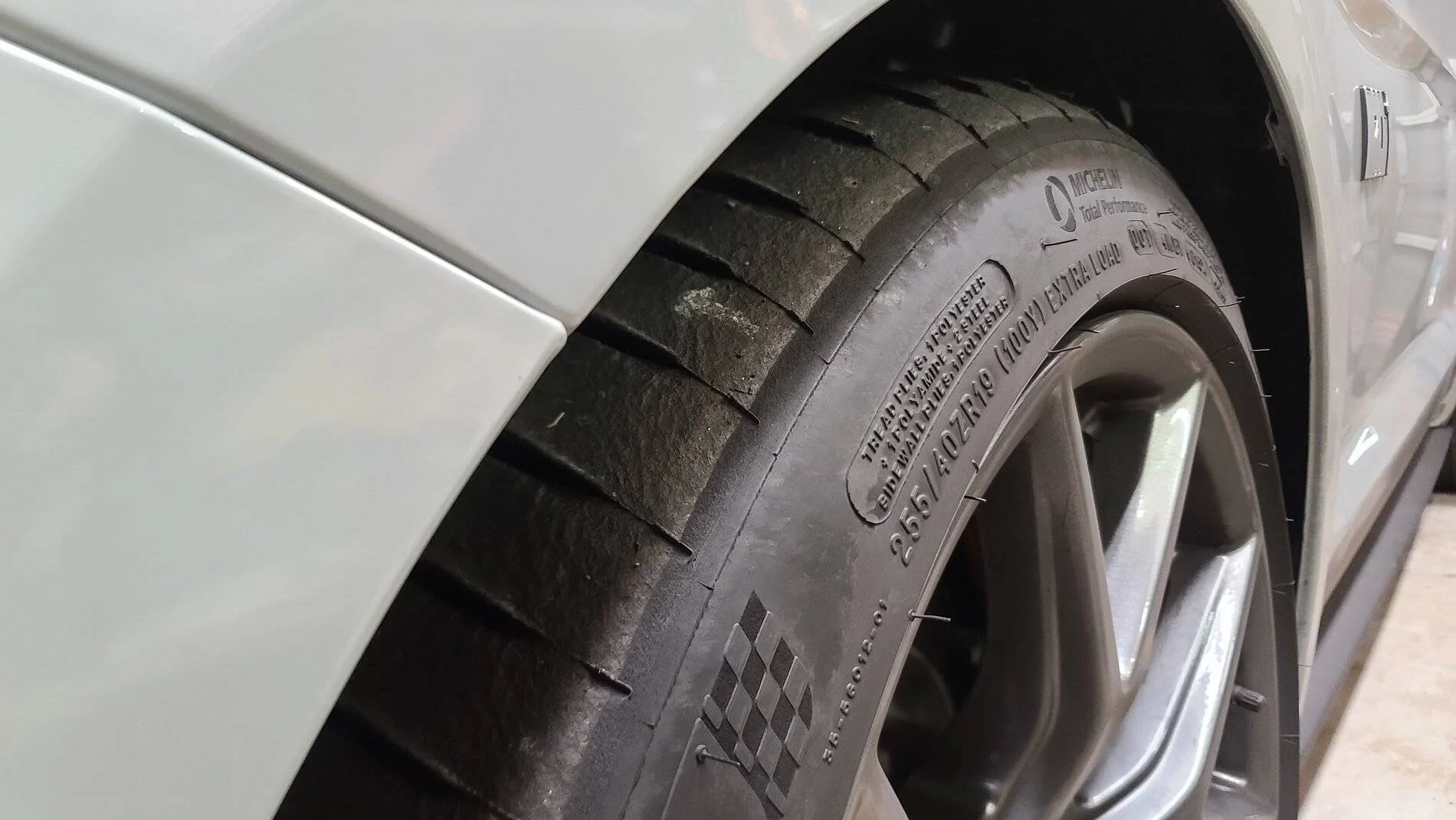

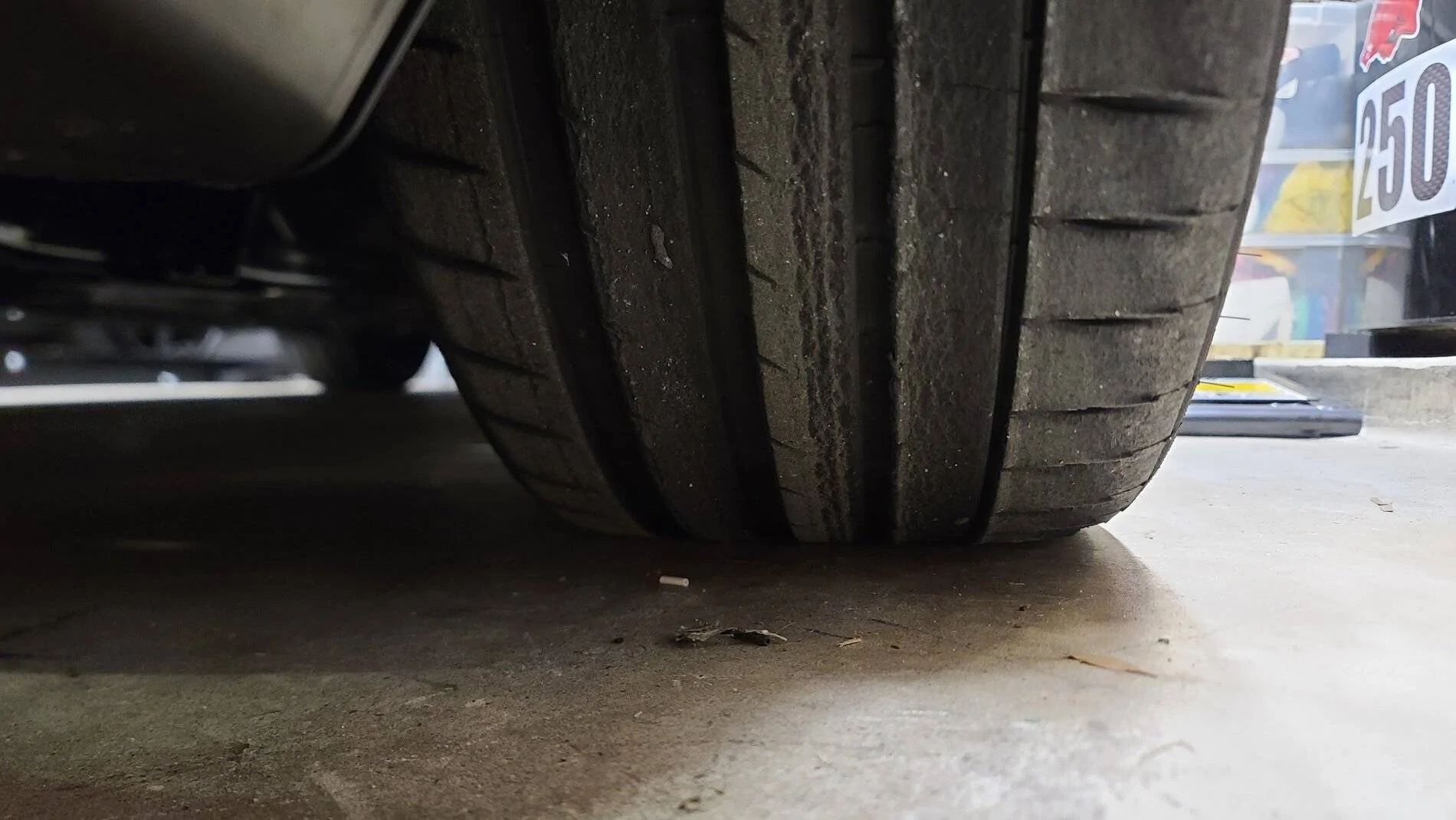

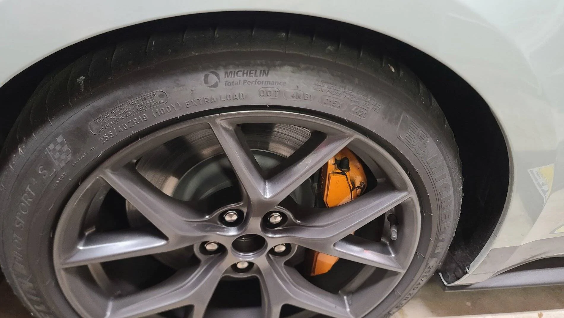

What does the front tire wear look like? Wondering if the front tires are rolling over a bit as most street alignments don't have much negative camber?
Do you know what the front alignment numbers are (camber and toe)?

Apologies for the delay - I've been out of town for the past week.
The car does corner really flat; however, your assumption is correct concerning the front tires rolling a bit. Here are a few photos of the front driver side tire right after the event:
I was running the tires at about 30 cold PSI and right after each run they were between 38 and 40 PSI. I did a very rough camber measurement and it seems each side is nearly -1.2 degrees. I do not have a toe measurement at the moment.
As I mentioned in one of my earlier posts, if anyone intends to track their Mach 1, adjustable camber plates/the handling package is the way to go. I ordered a set of Vorshalg camber plates over the weekend and am looking forward to seeing how the car responds.

If you start at 26-28 PSI cold you should end up around 35-36 hot which should be ballpark. 38-40 PSI hot I suspect the tires are getting a bit "greasy."
You are right, you need more negative camber, probably something closer to -2.5 would be close.
Will be really interested to hear your experience with the Vorschlag camber plates. They are really top quality and should easily get you enough neg camber.
