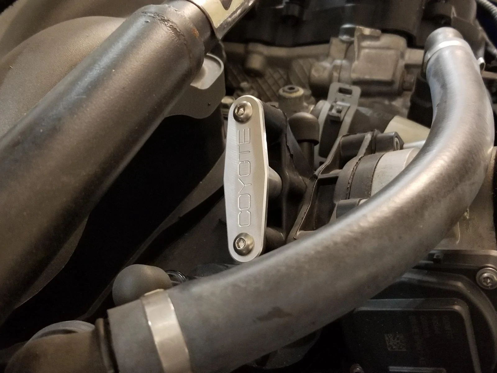

You can add it somewhere in the manifold, you will need to drill and tap the manifold. The walls aren't thick enough to get many threads to catch them though. A better option is to delete the EVAP and put the sensor on there since it sits right behind the TB.

i have seen them in the manifold before. i mentioned that to Ken at PBD and he isnt a fan. im really not either. what all is involved with deleting the EVAP? any pics of one installed there? That does sound like it has potential.

You would buy a EVAP delete plate, drill and tap it for your sensor, then stick it in the place of the EVAP solenoid. That or pull the solenoid out and see if the diameter is the same as your sensor, if it is then tap the plastic, put some teflon on the sensor and thread it in.

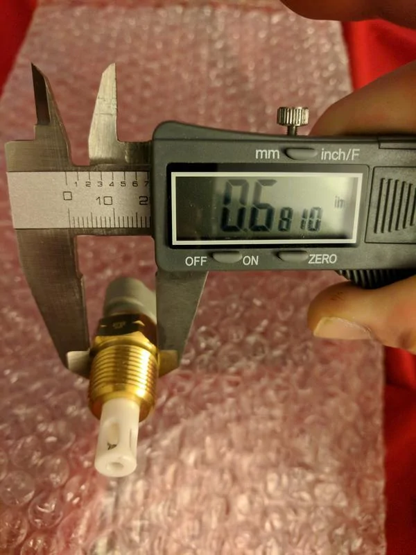

The threads on the sensor are surprisingly large even though the sensor element itself isnt that big. I haven't measured but I would guess that it would not fit on that EVAP delete plate. Drilling out the actual EVAP hole in the manifold and tapping it may work, but it also may be too deep that the sensor element wouldn't be right in the air stream. You'd have to take a look and hold it up and see how it would all line up.
Plenty of people do it but I didn't like the idea of mounting the sensor in an intake runner either. Seems like it would disrupt the airflow to that cylinder. If there is room between the valley and the bottom of the mani, mounting it on the floor of the intake manifold could be an option that wouldn't disrupt the airflow as much. But it would depend on your manifold if there's space underneath.

Here is the size of the IAT sensor if you need it. The threads are NPT but I don't remember what size.
