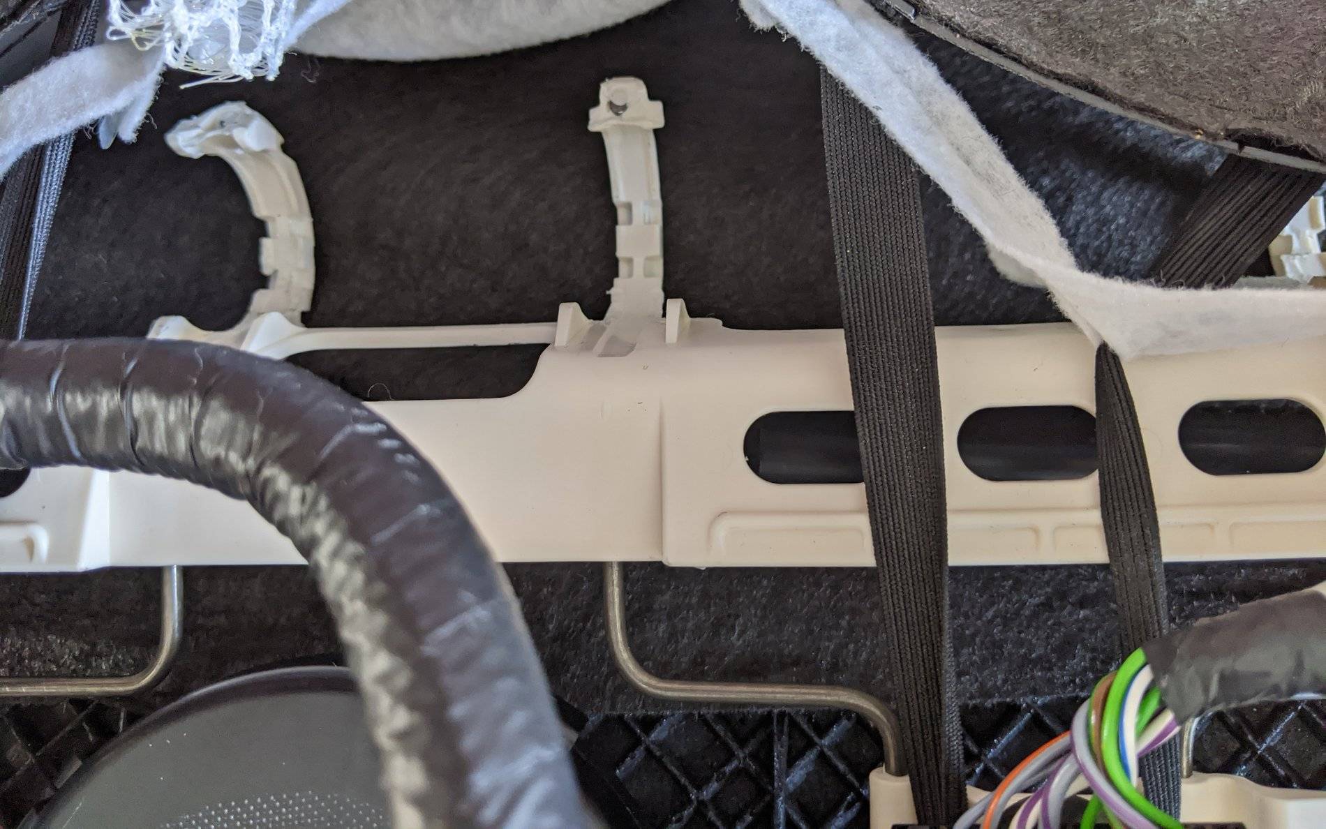

I was at the track for the 1st time a couple of weeks ago and found that I have to recline the seat waaay too far back to clear my helmet - so far in fact that I have to move the seat almost the whole way forward to be able to properly hold the steering wheel. Certainly not ideal.
(Interlude for those who don't know if I'm stupid or not - I did have the seat all of the way down.)
(interlude for those who are 6'4" and can fit just fine - my body length etc. may not be proportionate to yours.)
So after looking around for suggestions and finding none using the existing seat - I do not have the Recaros - I took the seat out today to explore my options short of modifying the floor.
What I ended up doing was unhooking the white plastic 4-hook retainer that hooks the rear of the bottom seat springs to a tube across the back of the seat. The pic is of the retainer after I was done. To get to it you need to unhook the 2 elastic loops that hold the rear seat trim in place and also the 2 plastic clips that hold the back of the seat cushion cover down. Afterwards you can just replace the elastic loops. I left the 2 plastic clips unattached.
I was thinking that I might end up having to zip tie the white plastic 4-hook retainer to the tube it was originally hooked around to keep it in place but so far that does not seem to be the case. I will be driving the car to see how it goes and will report back as to whether I need to make any adjustments. In effect you end up sitting on the floor (and the other stuff under the seat) but I'm a little on the wide side so between the front 1/2 of the seat and the sides it doesn't seem to go all of the way down even if I bounce.
If it crushes down too much I will likely make up a custom foam piece to go under the seat with cutouts for the various connectors to smooth things out but we will see.
After trying with the helmet on I believe that I have gained about 1.5" after settling in with harness on. Still not enough - I really need about 3" - but better than before. It effectively gains me about 3" of leg room as I don't have to recline quite as much.
If this doesn't work out I'm going to investigate modifying the floor to drop the whole thing a couple of inches if practicable. Has anyone done this?
