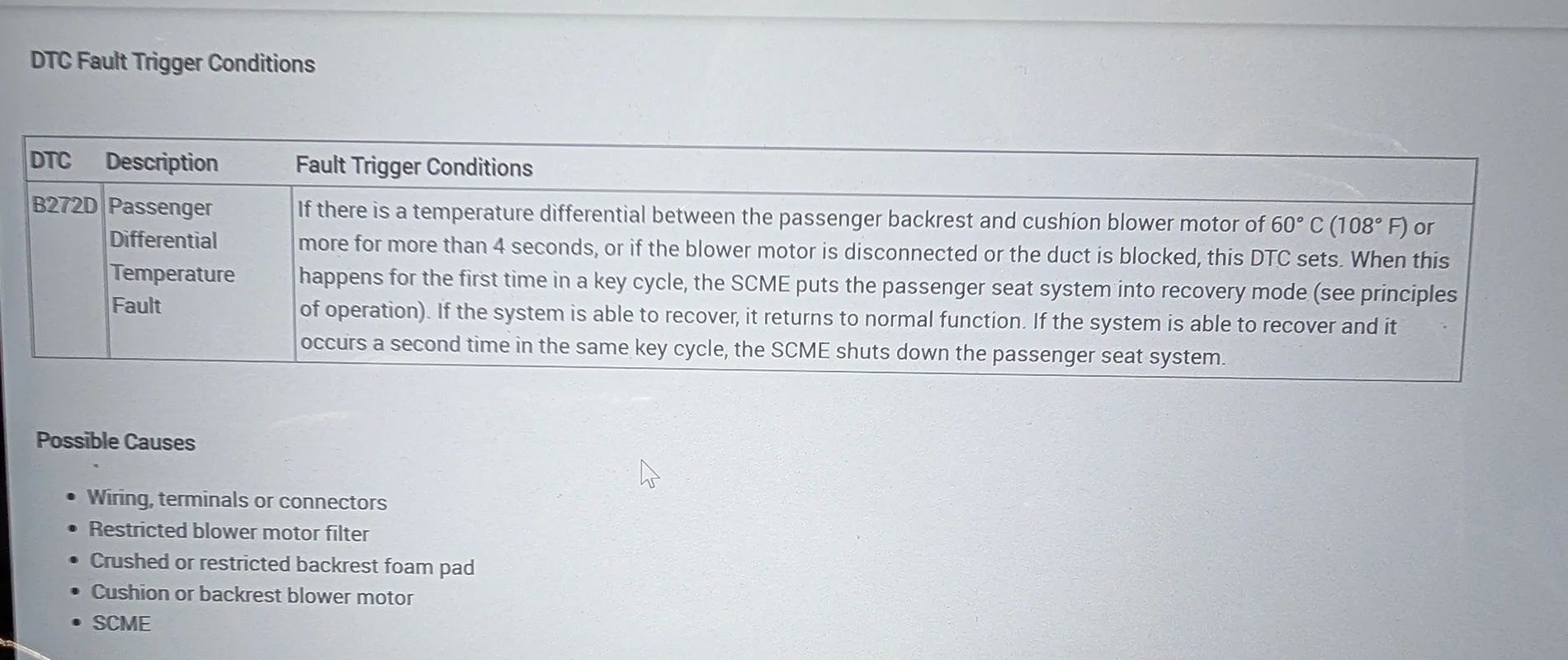

Did the mechanic that looked at the seat heater pull any codes from the module? You may have a shorted Thermo Electric Device in either the seat base or the seat back. The module will monitor the temperature output of both TED's and if it reads a large difference in temperature output between the two TED's it will shut off the output to both of them and disable the fans in the seat until you cycle the ignition key.

Yes: B272D-60 and B272C-60.

B272C - Driver Differential Temperature Fault
B272D - Passenger Differential Temperature Fault
You most likely have a shorted out TED in each of your seats. You will just have to figure out which one is bad for each seat.

Did further tests today with an 8k computer from a friend. Those are new codes.
