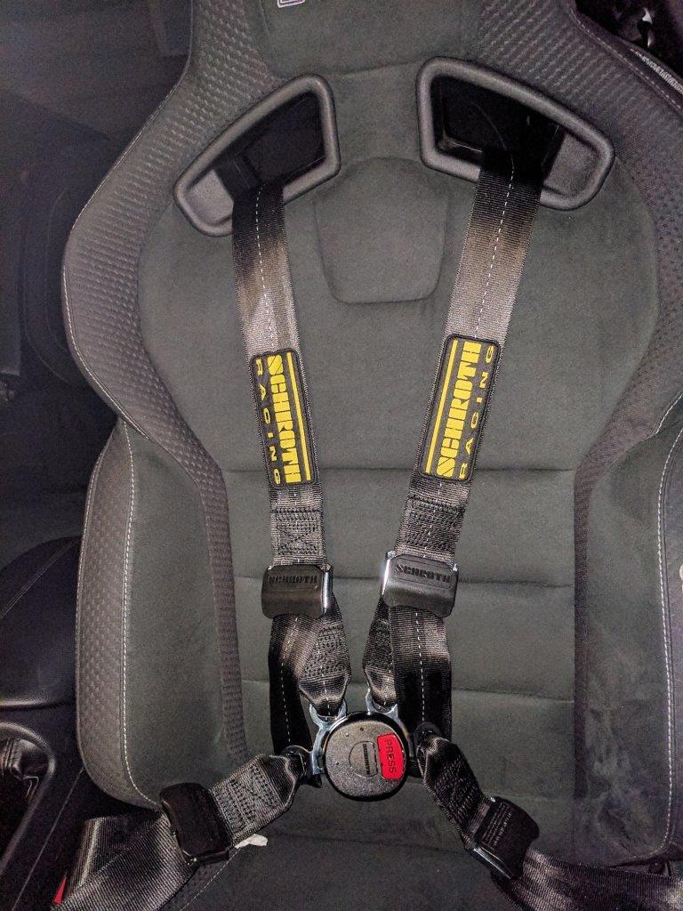

Back to the installation. It was fairly straight forward until you get to the installation of the left side lap belt. To say that was fiddly in Edd China's words was a gross understatement.:lol: You have to partially pull back a plastic trim piece and undo one or two bolts and then insert the belt attachment etc. Anyway that took some time and cutting of the trip piece. Once that was all attached routing of the belts etc was pretty easy. I have used them on the track twice now and they are pretty good. Well worth the kinda high cost involved. A submarine belt would be nice to have...almost impossible to do with power bucket seats.

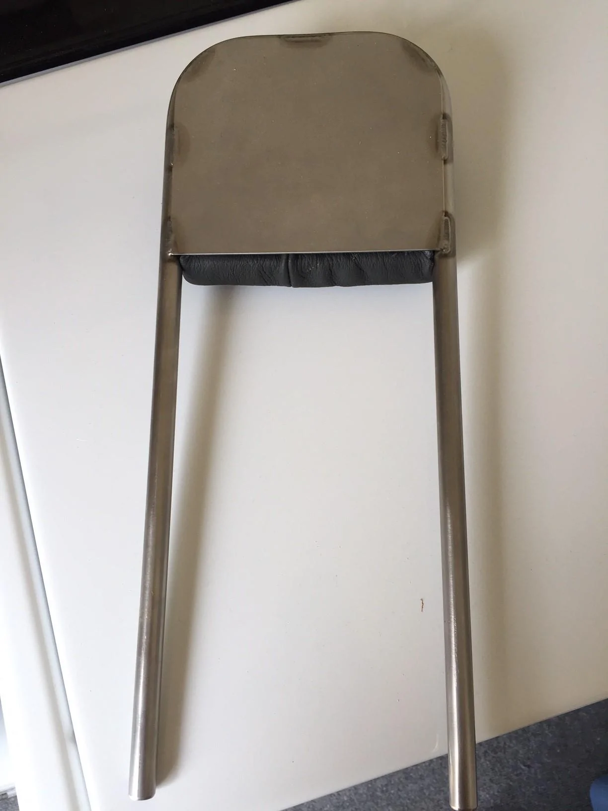

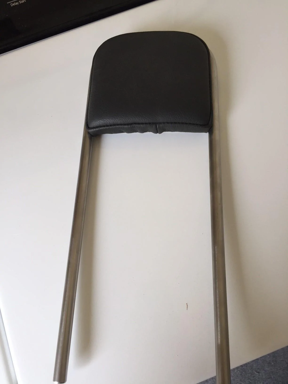

Well when I got home I set about trying to come up with something simple that would do the job for me. What I ended up with is in the pics I've included. Simple stainless tubing same size as the headrest tubing..a plate welded on and covered with some leather and foam. I think it came out very nice and is a clean install for track days. :thumbsup: Rather than remove the belts I just leave them stored on the floor in back of the drivers seat. Now one more point in using them...I believe the instruction mentions putting them on with the seat slid back a bit and thats the way to do it. Then once the belts are kinda snug slide the seat forward until the belts are tight. You just can't pull them as tight as you need them...in my opinion. Anyway this was my solution to a problem I had...but they do work well. Good luck with yours.:cheers:

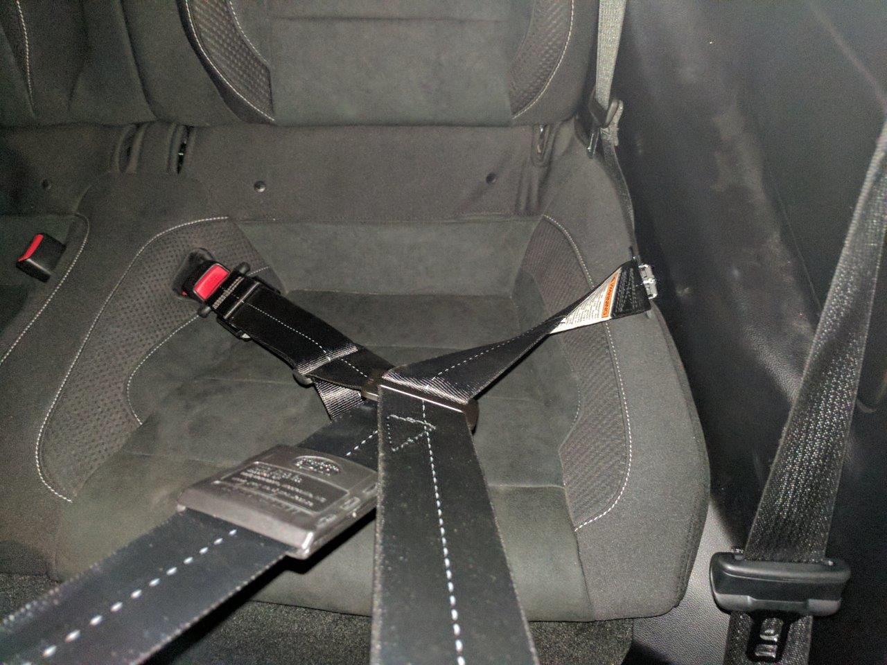

I got mine in today. Just a heads up, you need to trim some of the rear interior panel for the driver male receptacle to work correctly. Not a big a deal and took about an hour taking my time.
Nice fab work!
