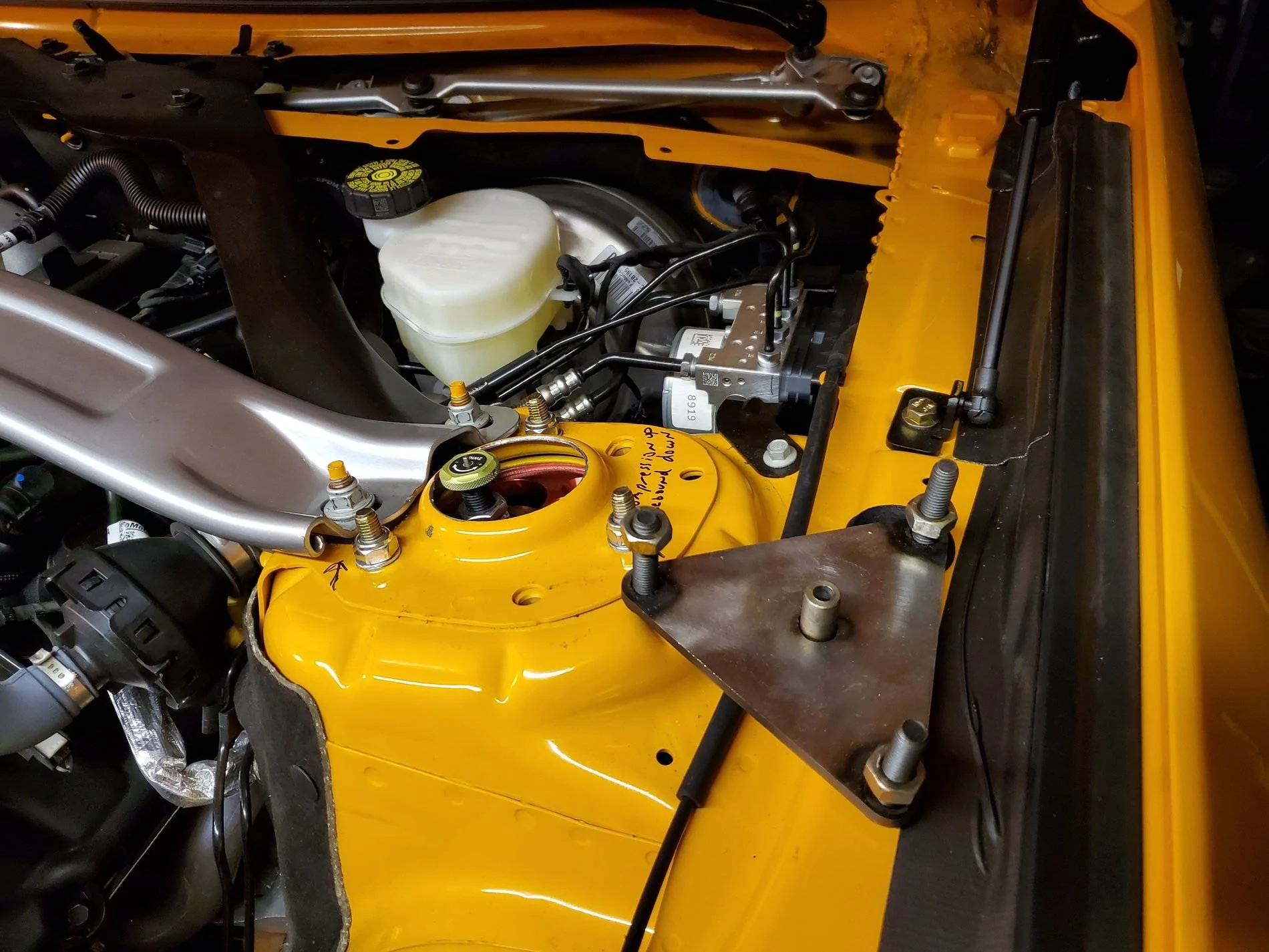

I'm new to mustangs and macpherson struts. I think the spacers and wheel offsets only allow one to use wider tires to clear the strut body. It does nothing for the camber unless one is adjusting at the spindle to strut connection (camber bolts, and the spacers/offsets help gain clearance so this spindle angle change can be made) but that change messes with scrub radius so not a desirable way to gain camber.
Enlarging the strut tower hole only allows more camber if the shock hits the side of the hole. People after more camber enlarge these holes to not only prevent the shock from hitting but also so shocks can be adjusted and to read/adjust the camber plate.
I'm at the limit of the vorschlag camber plates when running the Steeda bumpsteer links/extended ball joins. I want to keep the advantages of the Steeda bumpsteer/extended ball joint. Are there other manufactuer's camber plates with more adjustment range?

The Steeda camber plates to the best of my knowledge offer the most negative camber on the market.
We can get well over 3 degrees of neg camber on the front when you enlarge the strut opening like you displayed.
I wonder why I don't see people just notch the hole instead of cutting out the entire circle. Is it that difficult to cut?
I have the roll-correcting arms without BS kit and thought it handled quite well. The BS kit is now installed so we'll see what new feel it imparts.
My picture shows the jig to cut the circle with a plain hole saw. It is easy. The reason for not slotting it is because racers don't set it and forget it. We might play with camber for a specific track. With a slot we can adjust the camber but have to measure it at the wheel. That is an iterative process. If you cut a circle and your plates have lines on is like the vorschlag plates you can preset and measure at different lines for your setup and know if say I back out 2 lines I'm -1 degree etc. It makes for faster trackside adjustments with a known expected result. I never understood why some plates have no lines? If you have plate with no lines you can scribe them or just use a center punch and match know positions and make dots.
