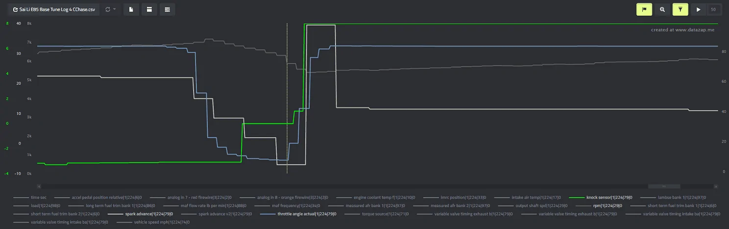

Seriously ready to throw my hands up with this thing. Check out this log.
Pull in 3rd looked mostly ok (slight misfire at 7300? Plugs are Brisk gapped at .030 with 3.5k mi on them).
3rd to 4th gear shift, goes lean and hits +8 degrees of knock on E85!
What would you guys recommend I do?
http://www.datazap.me/u/venumous/50...-14-16-17-18-20&trim=0&tmin=68.54&tmax=145.58
What kinda clutch do you have? The first knock event happened as you let out the clutch and it engaged. you can see the RPM drop from it. The rest came right after as you pressed the accelerator down. From the why the RPMs look, I would guess you may have had a little clutch slip causing some false knock.

Haha my clurch is already not pumped about the newfound e85 power just from logging.
Yeah stock clutch, no surprises there.
