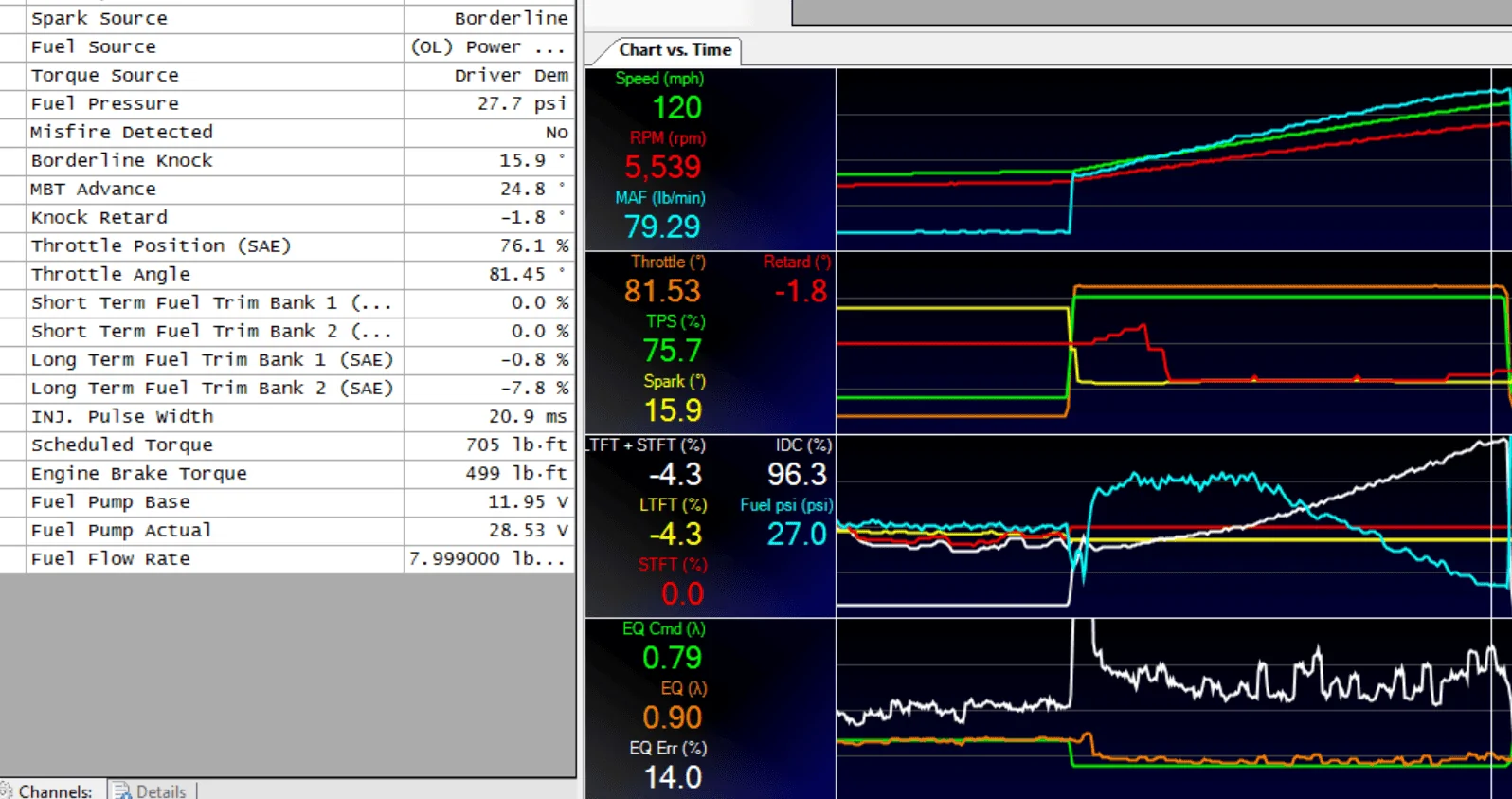

Guys who have done this system install would appreciate your review of my situation here. So I had the system with twin GT350 pumps installed by a professional mustang shop because I didn't want to mess with it. Loaded 93 Tune from Lund, first logs - good, told to do 2500 to 5500 - good, told to do pull to 7200 - good, final 93 tune sent with base tune for E85. Ran car down to E on 93, car took 15.9 gallons of E85 (tested to exactly E85) to fill up, change tune, did idle log, cruise log and short pull to 5500, going lean at WOT. AFR looks fine but STFT is adding 15 to 18%, this did not happen on pump gas.
I guess I can pull the seat and check the pumps by pulling 1 fuse at a time to see if both pumps are firing properly/bad fuse? Any other thoughts? Lund seems to think it must be a pump issue. Sai Li says he has not had a pump this new be bad, though the Fuel Pressure Gauge he sent me was bad and had to be swapped by shop.
Log 93
http://www.datazap.me/u/venumous/50...16-17-18-19-20&trim=0&tmin=169.65&tmax=180.27
Log E85
http://www.datazap.me/u/venumous/50...16-17-18-19-20&trim=0&tmin=303.07&tmax=314.10
