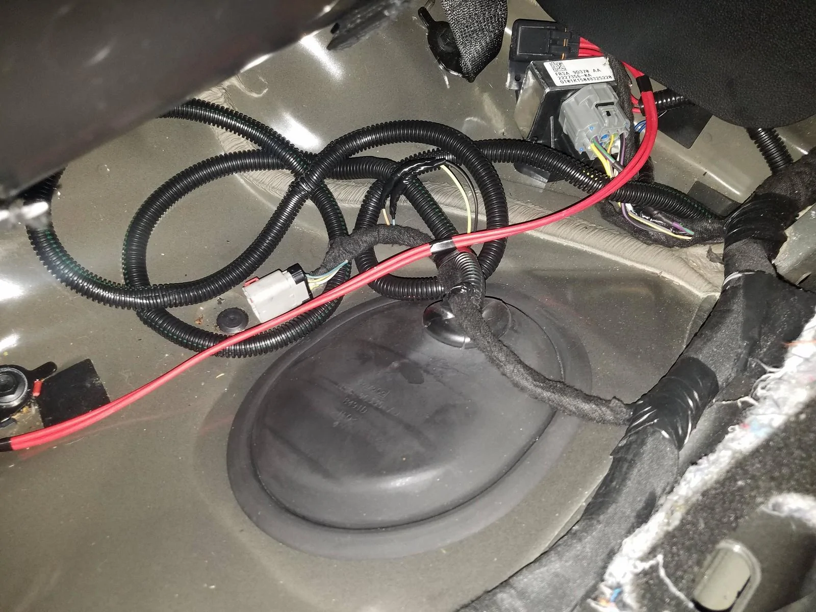

And how you mounted the relays would be great... just trying to do it right
thank you sir.
Jay159866
Sep 14, 2015
398
79
2015 GT 1966 Coupe
I mounted the relays just behind that panel.

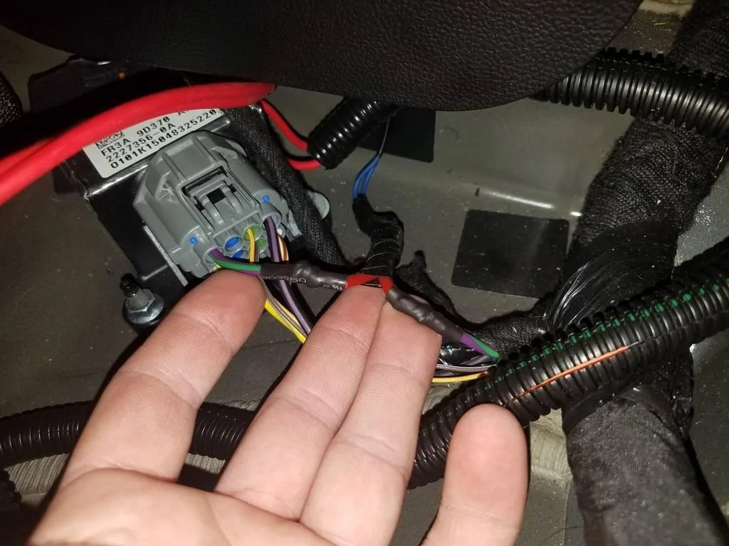

I got them to load off the email from the post. You tapped the purple wire? I thought it was supposed to be the yellow/grey or you get the wrench light ?
Jay159866
Sep 14, 2015
398
79
2015 GT 1966 Coupe
You can tap either one. I used the purple before I knew you should tap the yellow/grey and I already had it sliced due to my BAP.
Go with the yellow/grey for non-continuous priming.
joedrt73
Jun 4, 2016
75
georgia
2016 mustang gt base coupe
You can tap either one. I used the purple before I knew you should tap the yellow/grey and I already had it sliced due to my NAP.
I did wire the yellow/grey and no wrench light. Thanks for your pics and great write up ....

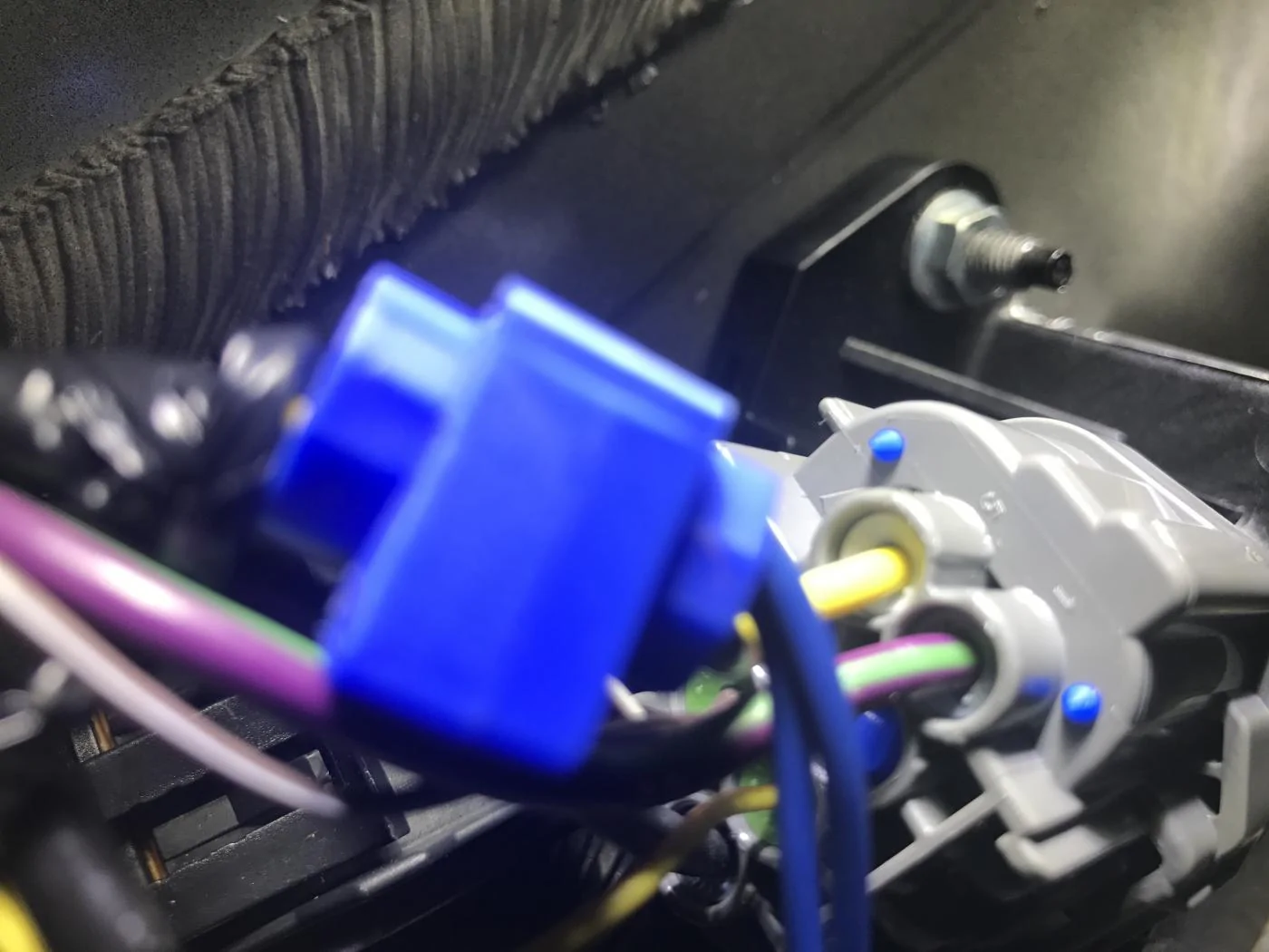

After starting the car a second time I am getting a cel P0627 "Fuel Pump A circuit open". I have to clear the DTC to get the light off. Them comes back on next restart.
I have the yellow wire (pin 5) which is going to the 2 blue wires. It primes and shuts off but still throws the light.
Any ideas??
Jay159866
Sep 14, 2015
398
79
2015 GT 1966 Coupe
Any ideas??

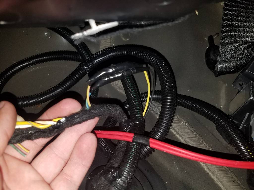

The fuel pump harness wires should be yellow to yellow and black to blue.
The FPDM should be the two little blue wires to the yellow/grey (instead of purple/green like my photo shows).
Is this how you have it?
joedrt73
Jun 4, 2016
75
georgia
Yes. The 2 blue wires to yellow/grey on FPDM connector and yellow to yellow and black to blue.
