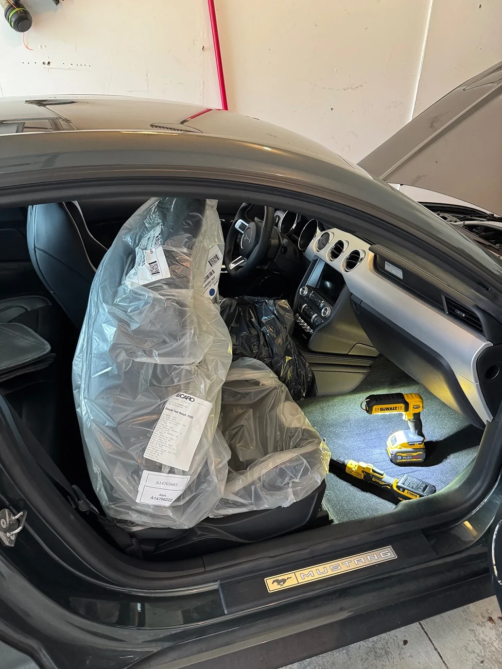

Alright well I have an update, good news and bad news.
Good news: I performed a test fit with a driver's seat. I set it in, plugged the cables in, and started the car. There was no airbag light. S650 driver's seats are compatible out of the box.

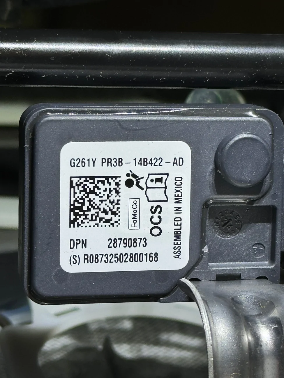

I have a passenger seat in hand and I can confirm that the OCS sensor is different than 15-17 or 18-23.

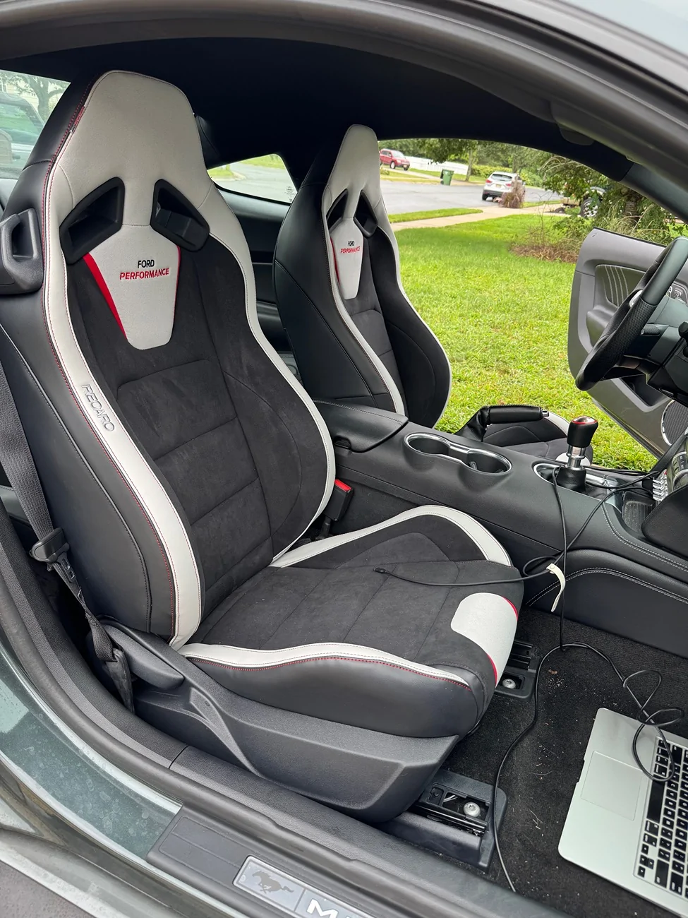

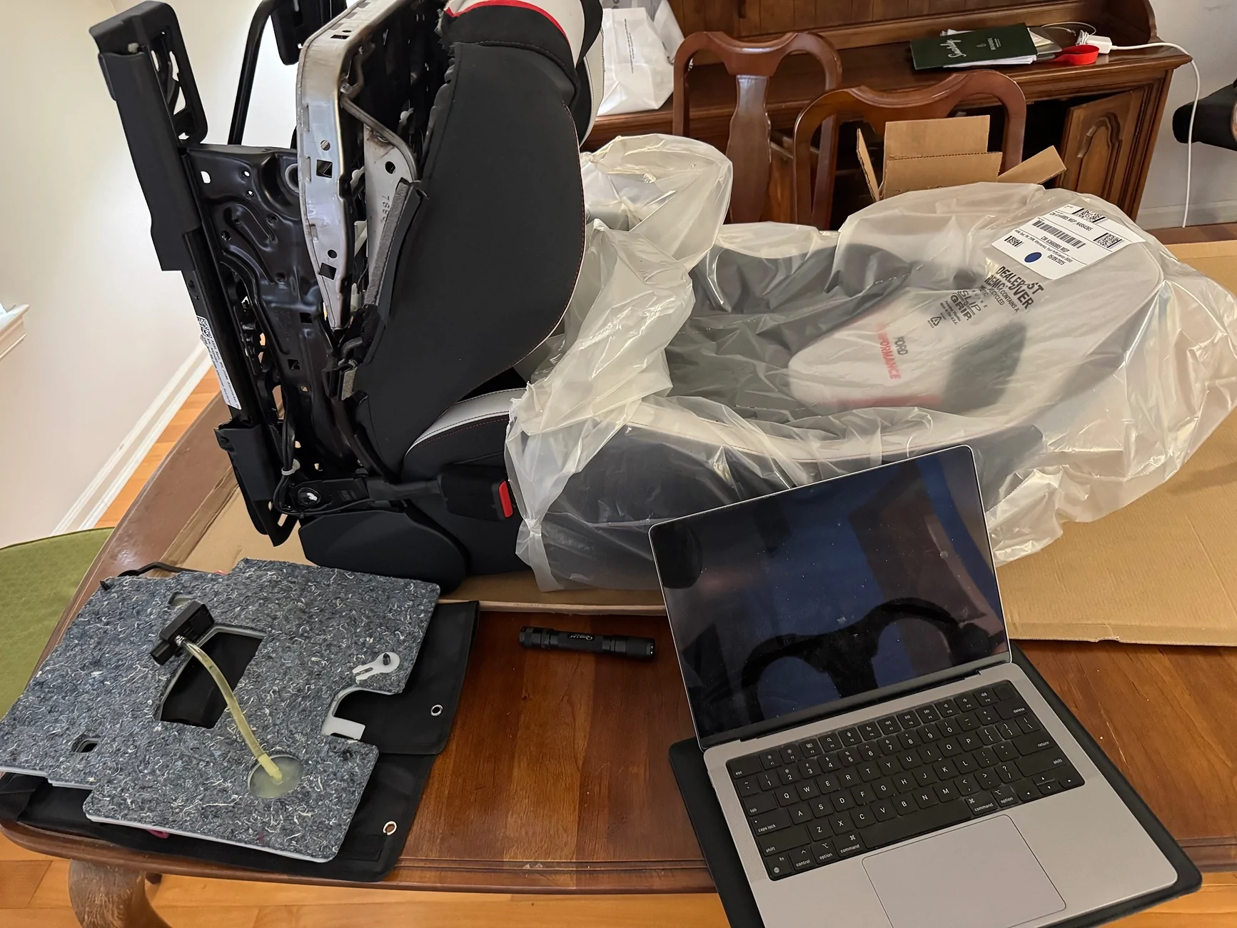

All done. I just needed to swap the OCS sensor and reset codes, same process as putting an 18-23 seat in a 15-17.
Money shot first:

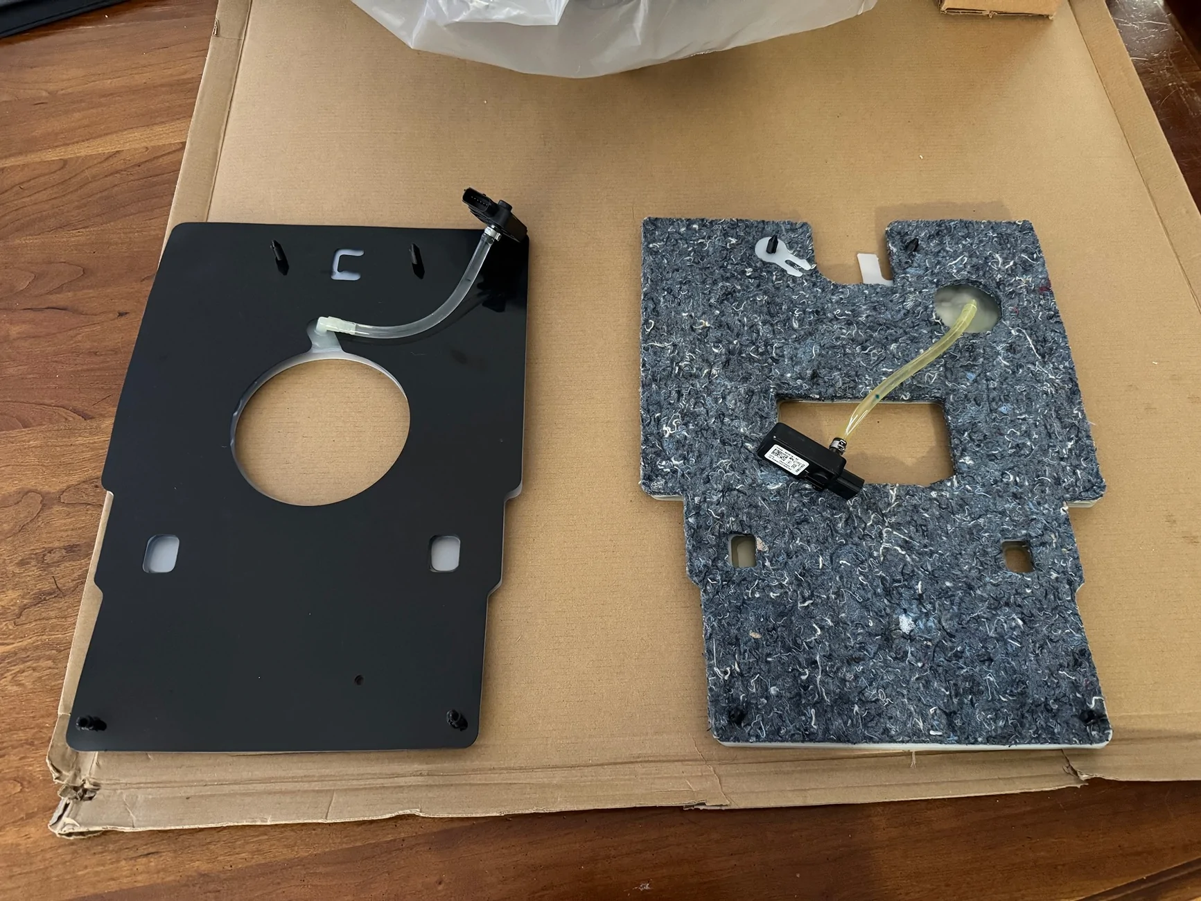

Seat with original OCS sensor
OCS sensors side-by-side, S650 Recaro sensor seems to have foregone the insulation

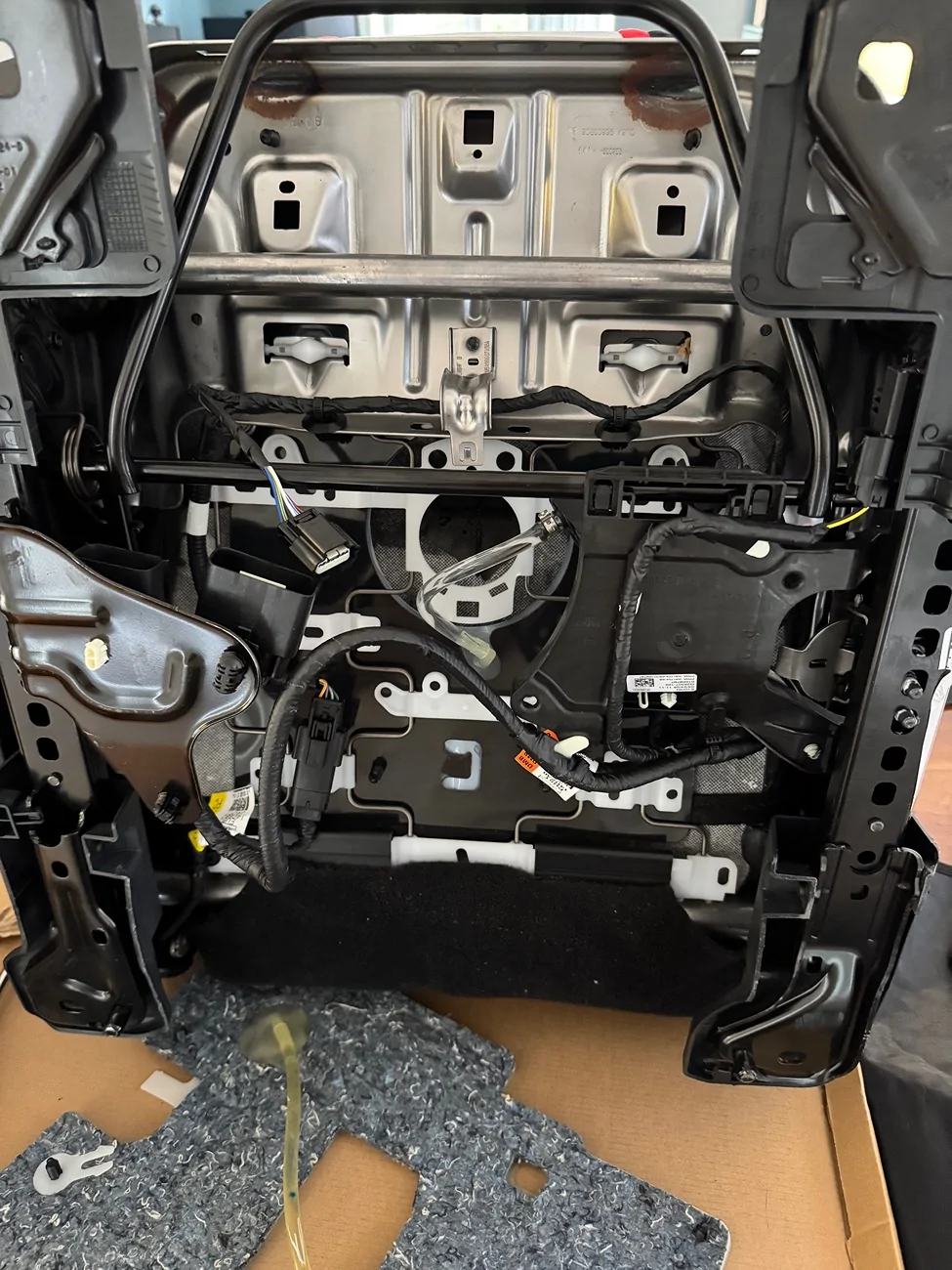

You just need to unclip the seat bottom to remove the OCS

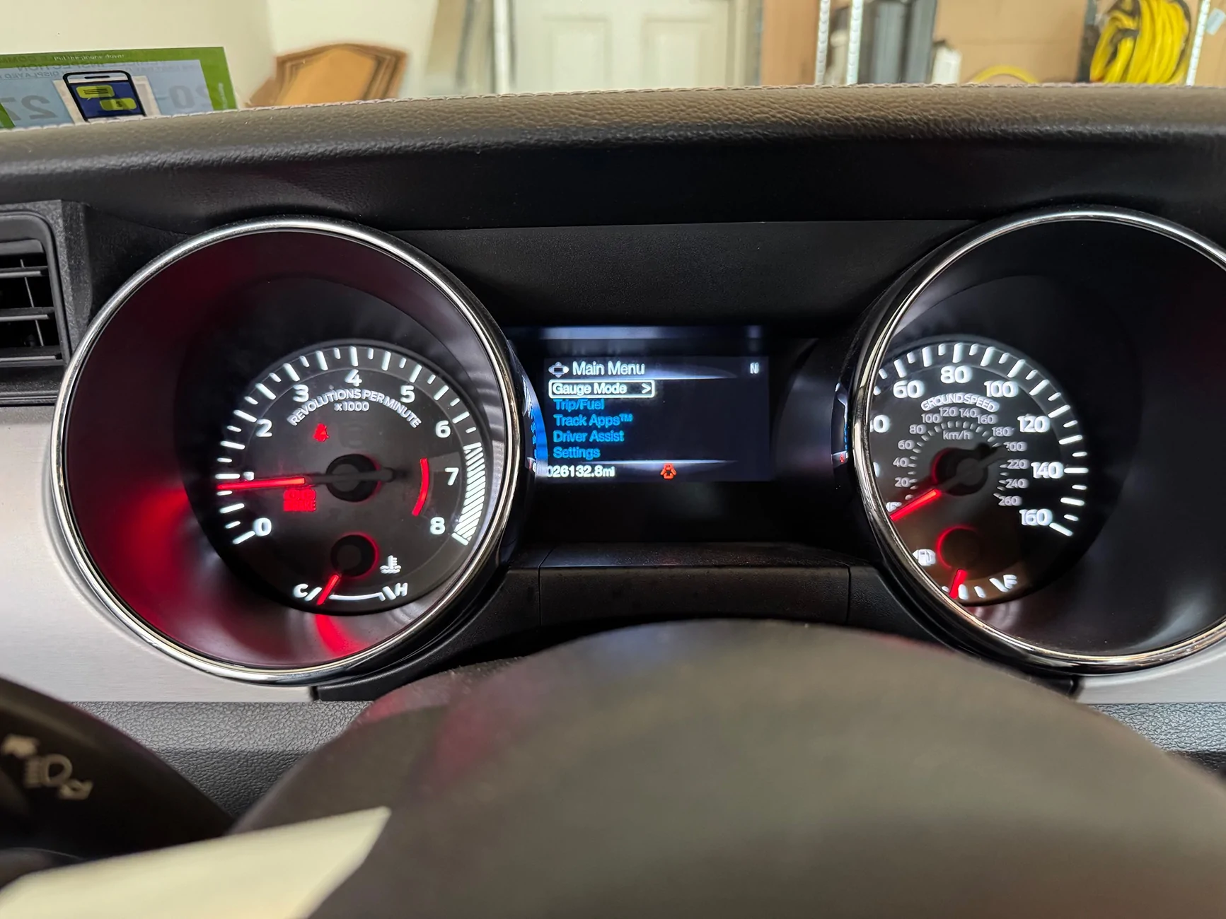

Installed
No airbag light
