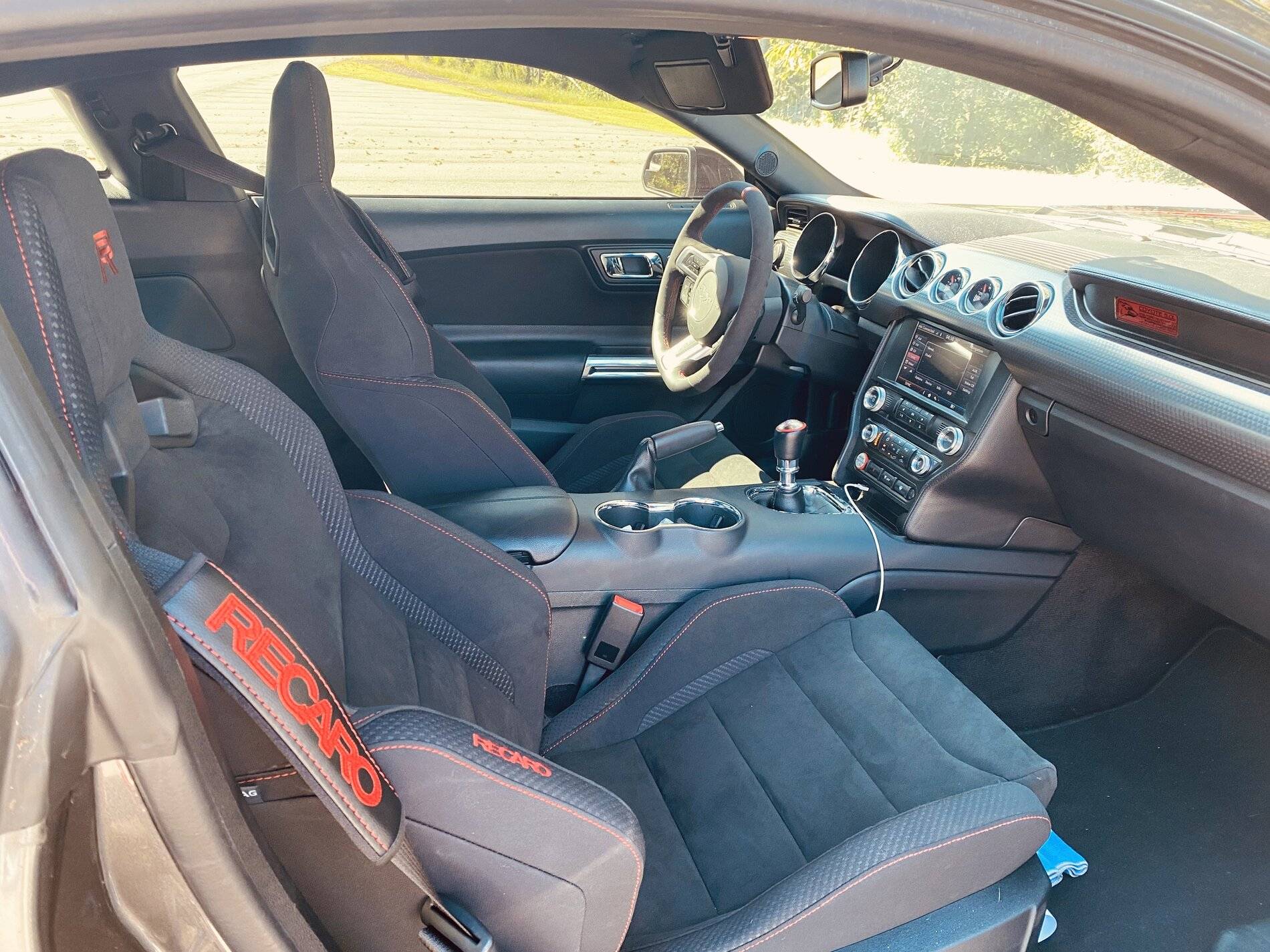

Yes, they'll swap in and the connectors will also be the same, but you might run into an issue with passenger OCS not registering which is what happened to me when I put GT350R Recaros into my 2016 GTPP. If your airbag light stays on after installation, that is an indication that you will need to swap the passenger occupancy control sensor unit to the Recaro.

They're pretty great. I was searching for a set of OEM Recaros last year and eventually stumbled upon these. An older gentleman bought an R, drove it home with them still in the plastic only 200 miles, and he listed them. I bidded on them and lost the bid. He contacted me the next morning saying the buyer backed out because of a couple hundred dollars shipping and offered them to me privately. The R for me represents my last name as you can tell from my dash plaque. I put an entire GT350R interior in it last year. It'll hurt more if you find out what they're worth and then what I actually paid for them. Lol
