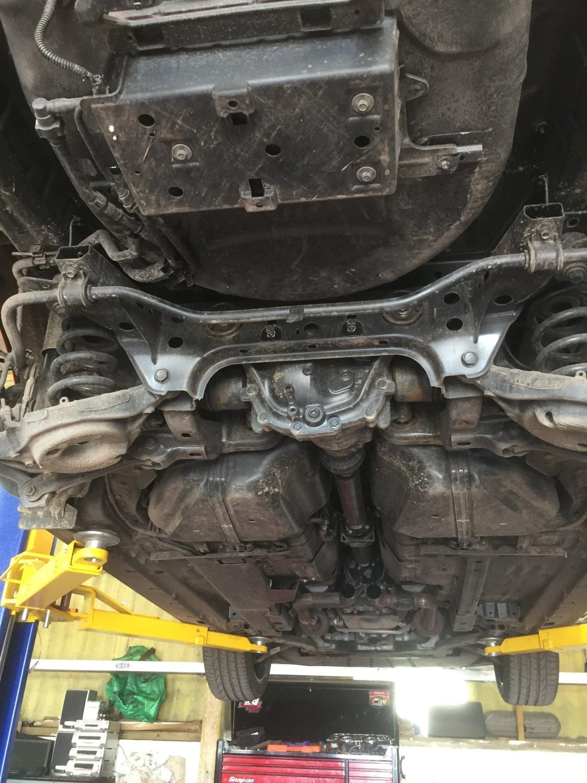

I had mine undersealed with Raptor and here’s the underside after 18 months
That looks good! Is that truckbed coating? Did you do it yourself?
