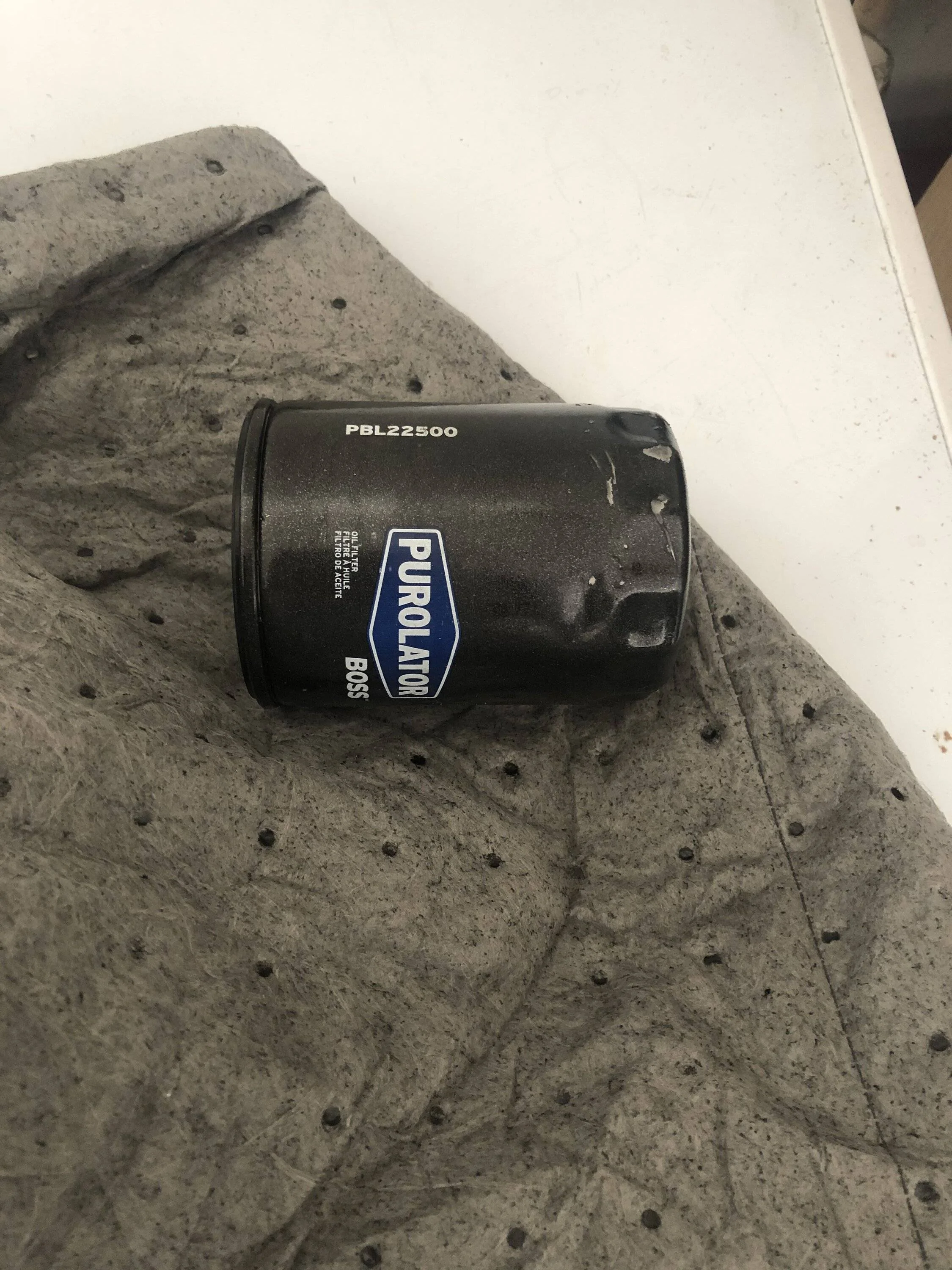

I have a 2020 PP2 and had the same typewriter/BBQ tick issue. It happened after my 1st oil change. The dealer couldn’t help. Called Ford, they told me that the vehicle is fine and will not affect the vehicle performance. But this was annoying listen to this noise in traffic, drive through etc. A friend of mine was part of Mustang forum suggested that I use a different oil filter will fix the TYPEWRITER issue. Indeed, the problem has been fixed as long as I make sure this oil filter is used. At the dealer, I just pay for the oil change excluding the filter charge. I bring my own. Filter type: PUROLATOR, part# PBL22500. Never hear tick anymore. Try that.

Thanks for the reply but if you read what I wrote I do NOT have the type writer tick. There's already a thousand threads on that issue.
